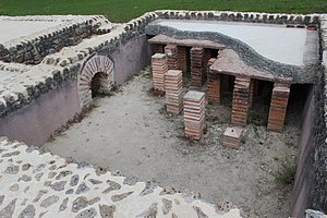

We have through the ages done all sorts to keep the home comfortable 1662392562469.png be it under floor heating or a fire in the centre of our mud hut.
Be it a heat reflector (false floor above the main accommodation or shutter) or coal fires we have gone to great lengths to adjust the heat of our homes, the main change is how to do it with the minimum of manual adjustment, our parlour maid has long gone, we need technology to replace her.

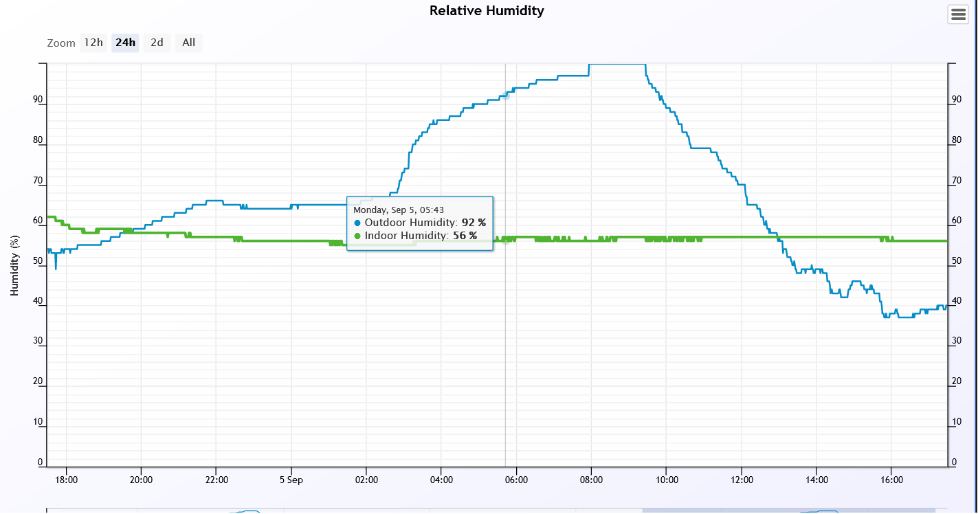

I've never really understood indoor humidity levels. In the UK, outside humidity is generally 50%-100%, but everywhere inside my house is usually 50-70%, even when outdoor humidity is very high. Interesting, during the recent very hot spells, the indoor figure hear dropped to 25-30%
Green line is the indoor, which begins slightly higher than 60%, due to cooking and my having a bath yesterday. Blue line rises rapidly due to a thunderstorm at around 02:30 this morning. The blue falls to less than the indoor humidity, due to the environment drying with heat and sun. The indoor humidity remains fairly stable because it is a closed environment. Indoor humidity generally remains pretty detached from that outdoor, unless we have a rather long dry spell, as we recently had, when the indoor could drop below 40%.
That all seems consistent with what I have experienced, and described in my previous post.
