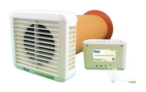

I know there were heat recovery units where the heat exchanger was the pipe going through the wall, 1662387043895.png these cheap units around £300 used just one fan, it relied on a sealed room to push air in other direction, more expensive units the fan both sucked in and blows out.
