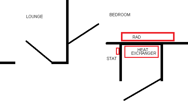

I was sent to do some faultfinding in a retirement complex after NSH's were replaced with wet rediators working via metered heat exchanger for each flat. The complaint right the way along one side of a corridor was the living room was cold but turning the 'thermostat' up to 26-28°C meant the bedroom was baking but bedroom rad couldn't be turned down far enough.
The original assumption being the rads were incorrectly sized.
However the heat exchanger was fitted in place of the hot water cylinder in the little hall with a rad the other side of the uninsuated plasterboard wall and the stat on another wall in the hall:
I walked into the first flat and felt the wall beside the stat, I didn't bother checking anything else but moved on to 2 more identical flats.
I cobbled one stat into the lounge for a few days and againts all predictions the rads became balancable.
My report simply stated the stats were in the wrong place and the contractors should return and move them to an appropriate location.
