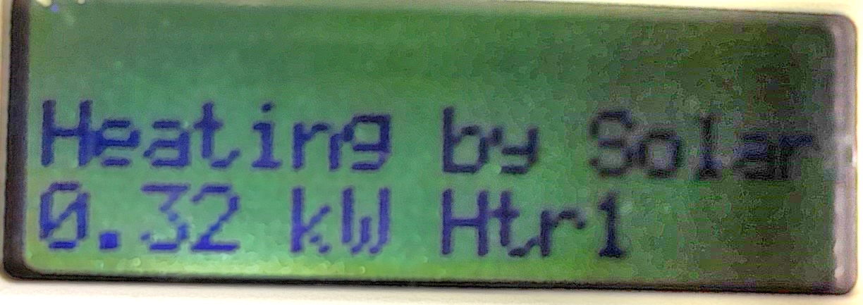

The changing way we use the immersion heater could mess up @JohnW2 argument, yes my immersion rated 3 kW, but rare it uses 3 kW, most times when I look I see something like this 1717659717930.png by time there is enough sun to run at 3 kW the water is already hot.
As said before I think the iboost+ was an error, as once we get the export payment sorted out, we will get more for exporting than we pay to import in the middle of the night, so the best option is likely to have a simple timer which turns on the immersion during off peak, which means it runs around 1 am to 5 am, a time when we are rather unlikely to use the sockets.

The changing way we use the immersion heater could mess up @JohnW2 argument, yes my immersion rated 3 kW, but rare it uses 3 kW, most times when I look I see something like this View attachment 345291 by time there is enough sun to run at 3 kW the water is already hot.
