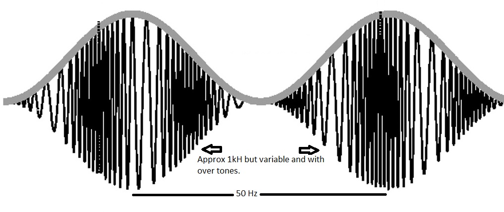

F in the formula is frequency so it can be seen if the frequency is not 50 Hz then the impedance will also not be as designed. I would not expect an extra low voltage lamp to use a capacitor as a current limiting device, I would expect to find a resistor, however there is nothing to stop a manufacturer from using a capacitor so when the lamp is marked 50 Hz to power it in the MHz range is really to be avoided.

In my house I know the transformer is giving out 50Hz, but in anyone else's house not a clue. With the early push for so called drivers which are not really drivers they have consent voltage not current, when we come to change a MR16 lamp we have not a clue if the supply is AC or DC or 50Hz or in MHz range. We also have not a clue if the bulb has rectifiers, capacitors, resistors or full blown switch mode driver inside. The document I linked to tells you what manufacturers must tell you, and it tells them voltage, wattage and amperage all need to be on the package when really it only need two the third is easy found using Ohms law, but it does not need to say AC or DC, that is crazy.
I don't have the actual scope screen shot but this is very similar to the wave form found on the output of a SMPS 12 volt AC supply
