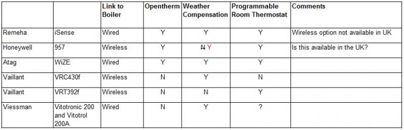

I too am interested in the opentherm idea,
In actual fact I only know of 3 genuine opentherm controls available in the uk full stop and yet manufacturers are advertising boilers as "opentherm compatible" like thats much help without a damn stat
Mickyg, could you let me know of the ones that are on the market so I can have a look at them?
When I looked at this a few months ago I compiled the table below for controls:
The only other information I can add now is that iSense RF works well with the UK Avanta, but you need to buy it from the Netherlands.
I've just remembered that there's also the RAMSES 786 OT Thermostat that I didn't to add to the table because I wasn't keen on it.
