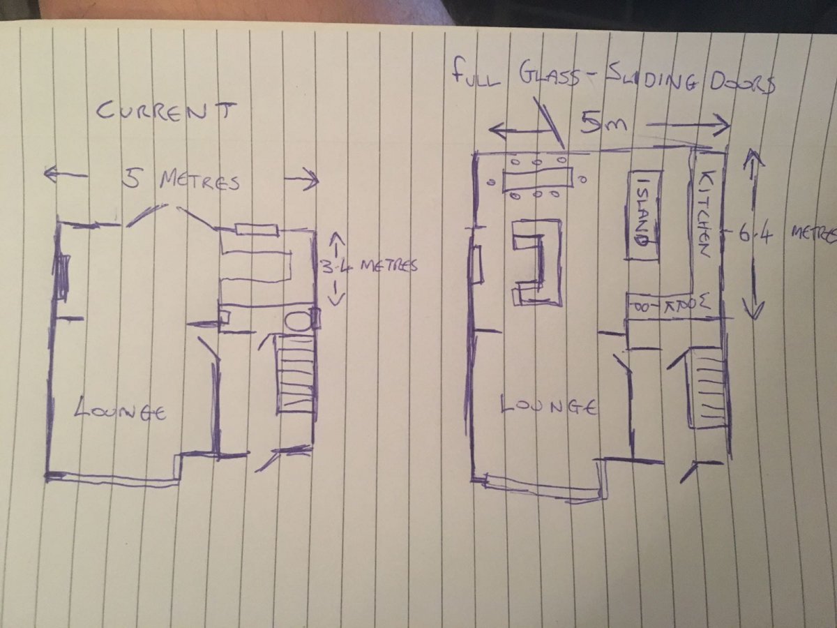

Opening up back of the house... fully.
26 Jan 2008
126
6
Thanks for taking the time to look.
I've got a pretty average house, but I'm looking at some advice before I get quotes later this week.
Some background. North West (Warrington) The house was built in 1950's. I'll be fitting the kitchen etc myself (kitchen fitter/plumber)
I'd like the rear of the house opened up completely (if it's possible) and the kitchen diner changed from a 5m × 3.4m.... to 5m x 6.4m.
I'd like the extra 3×5 to be complete in glass, floor to ceiling. (Roof/left/rear) with the right hand wall being in brick, and the kitchen being extended across this wall.
I will be flooring/tiling/plastering/decorating it myself.
I've looked online and have see a guide of £1000-£1200 per sq/m for a single story extension.
Does this sound right, and most importantly is it likey possible to open up the rear of the house totally with no support?
Sorry about the picture. Rolf Harris I am not!
Any questions please ask, I've tried to include as much information as possible, but may have missed something obvious.

Is the house 2 story? What's it built of? Will the extension be 2 storey?
Converting an existing wall into a full width opening can be expensive due to new footings etc for goal posts steels etc.
Building an opening like that from scratch is much more straight forward.
However you still have to deal with the existing rear wall and getting a flush knock through with no nibs retained will need some engineering.
Any m2 build costs will not include the knocking through or internal alterations - which can cost several thousands alone.
Your idea is possible in principle. It's just down to the detail. And that detail can be very costly. So it comes down to whether the cost is worth it.
I've just done something similar but on a larger scale. Its major friggin work and you need a builder who is very good at structural work. Fortunately mine was, unfortunately he was sh*te at everything else. Think about the impact the steels will have on upstairs. Mine was approx 450 deep and it affects services etc.
If you want that much glass then your meterage value is well off. Structural glass and the design behind it is not cheap, you'll also have to get a sap done.
about 15m but the supports were T shaped with 3 goal posts. so the span was probably 11m.
i can dig out the structural paperwork work to get accurate sizes. but steels make soil pan connections and bathroom drainage a faff
