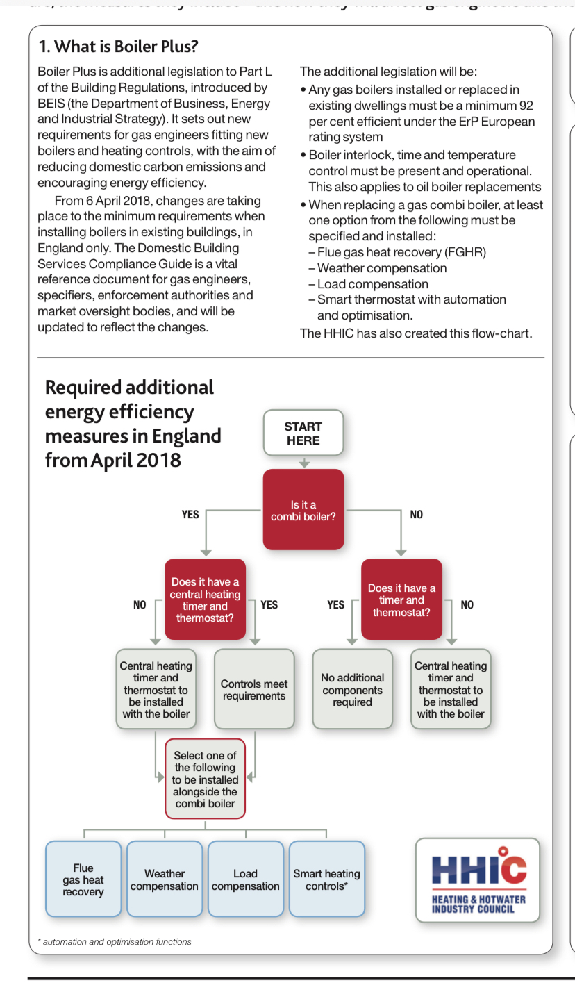

I have a Vokera easi heat 25c boiler it is currently using the built in mechanical clock timer and a wired thermostat on the wall next to it to control it.
I am getting the vokera 7 day programmable wireless (Vokera 20059643 RF Thermostat although it has arrived and it’s branded Alpha). And the additional controls interface plug in bit which the web says I need to make it work with this boiler.
I want it to be Boiler Plus rated and it seems like this change will do it by being Opentherm controlled ( I don’t fully understand either term but I hope I don’t need to).
When this is plugged into the boiler will this then be compliant?
What does the reference to it being in OpenTherm mode? Is that an adjustment I need to make?
Thanks for your help.
@vulcancontinental will be your man for this(y) should get a nice explanation from him. Tagged in so he will see it.
This my understanding: Boiler plus is the latest in helping with heating and boiler efficiencies. Opentherm is a data language that “talks“ to the boiler and is only dependent (usually) on how it’s wired into the boiler, not a mode to select. Yes this should then make it boiler plus compliant.

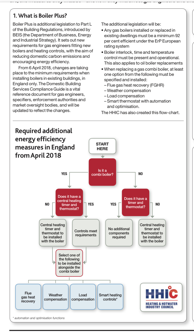

As far as I am aware, the controls need to have load and weather compensation (LC/WC) included and smart to be Plus compliant. I believe the Vokera would need the BeSmart controls and the outdoor sensor to include weather compensation. I don't think the programmable stat you have highlighted is WC enabled. Though I am sure VC will be able to clarify.
Other requirements are passive flue heat recovery, a boiler @ 92% efficiency, etc. These are not retrofit requirements, rather only relative on new installs.
Not relative to us up here but I do remember some of the blurb when the specs came out.
Only 1 by the looks of it mate:

I think you’re right by saying it’s not a special mode or anything.
Why put the asterisk there? I think maybe it’s just a bit more information to clarify how it meets the requirements.
As suggested, we don't have it up here so it's not something I keep track off.
Good to hear it's not all of them then as that could get expensive, though that being said I guess implementing them all would make the system as efficient as it could be.

Open Therm and this controller satisfy the load compensation criteria then.

Timed and temperature control on a combi plus 1 energy saving measure for Boiler Plus.
WC.
OT
PFHR
Smart Stat
To convert the stat is simple but you'll need the controls interface.
