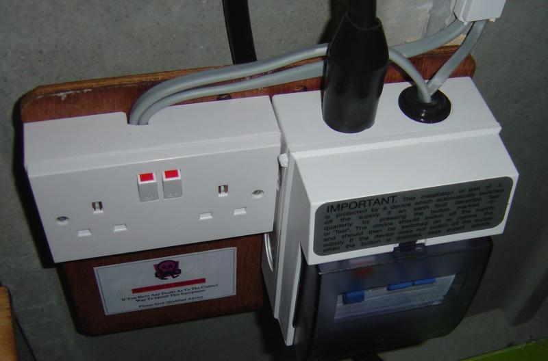

Nex
16 Jul 2011
25
Derbyshire

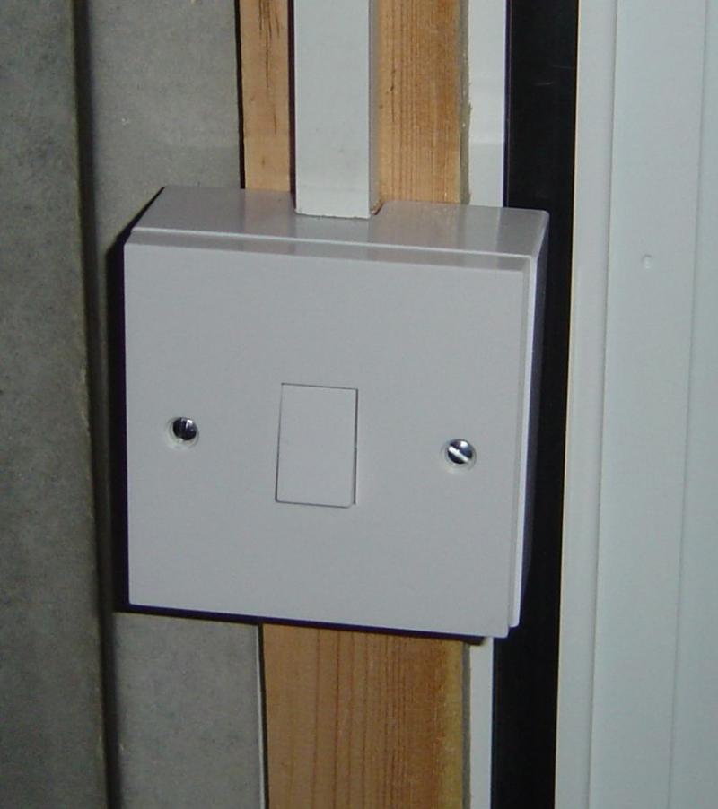

Ok apologies for the delay in getting back to you but we ended up getting a few quotes and did end up going with the cheapest which I may be starting to regret.
So far he has only wired up the garage due to the fact the house wiring failed the megga test so we need a complete rewire.
I was just after an opinion of his work as im not sure if what hes done is ok or if hes been cutting corners because its easier for him.
What I will say though is that the garage is under warranty so you are not allowed to drill any holes in it otherwise it will invalidate it.
I questioned why I needed such a big light switch and not a slimline one like I was expecting and he said that he has had issues in the past with the slimline ones being so cramped with all the wiring that whens he gone back round doing all his testing it has actually failed on that.
Looking at the plug sockets it looks as if hes actually made a hole in the top of them to feed the cable through now in a garage where its damp and you get condensation surely this is not a good idea as there is nothing to stop it say dripping of the roof and getting inside and the same with the light switch I guess?
And just in case anyone has a go at me and says im mad I haven't actually paid a penny as yet.
Advice if required and opinions would be appreciated.
Thanks in advance.

Words fail me.
That's horrible.
How are those bits of wood fixed to the walls if you're not allowed to drill into them?
Every circuit had poor results?
What were the readings?
And does the work done in the garage look like it was done by somebody with the skills and attitude to quality that you would want in someone rewiring your house?
All that says to be is that he's as clumsy as his work would lead you to believe. Of course architrave switches can be used successfully - why does he think they make them.
Call a halt now and sack him.
You'll have to pay something, but haggle and beat him down.
He's a disgrace - you should also send photos to his scheme organiser.

Nex
16 Jul 2011
25
Derbyshire
Words fail me.
That's horrible.
Thanks for the reply
Apologies im struggling with the quote system so ill reply as best I can.
The sides of the garage are made out of concrete blocks that are bolted together so you can just undo a bolt and then put a metal bracket on and replace the bolt.
We only have 2 circuits in the house 1 for the lights and 1 for the sockets and to the best of my knowledge he tested both in front of me.
Your have to forgive me with my ohms as im not sure which is which but he said it should read around 300 on his test but we was actually only achieving around 200 and it struggled to reach that as he had to hold the button down for a long time.
I did think that with the light switch myself hence why I questioned it but what about going into the top of the switch and the plug sockets with the cabling is that advisable in a garage?
I don't see why I will have to pay him anything as there wasn't a contract in place and if it gets ugly ill just strip it all out myself shove it in a box and dump it on his doorstep and start from scratch.
And yes looking at this I am seriously questioning his work hence posting on here for advise as I didn't think all was well and that's why im asking now before he pulls the house apart!!
If that was an insulation test, then 200 is fine.
Would only be a concern if the readings were below 10, and even then, that could still be satisfactory (although further investigations would normally be be made if the readings were that low).
The fact that the test button had to be held down for a long time is of no consequence at all - it just means the cables are reasonably long. It's actually what you would expect to happen with cables in good condition, and certainly not an unusual event.
