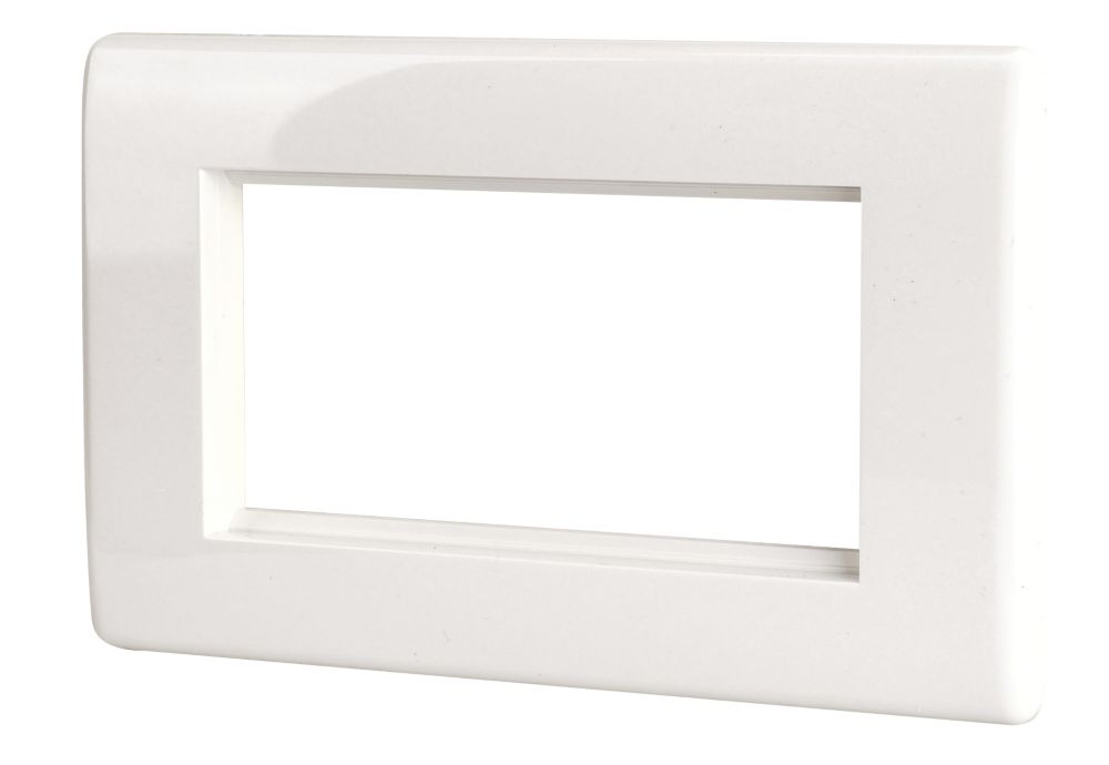

To get the power from inside to outside I was going to replace a socket that we don't use with a switched FCU. However it's currently a 2 gang socket on a wallpapered wall. Searched everywhere and I can't find a 2 gang faceplate where one of the gangs is a switched FCU. I don't really care what the other half of the faceplate is - it can be blank for all I care.
I just don't really want to change the back box to a single, re-plaster etc.

You could use grid plus or similar. It does get a little pricey though.
http://www.screwfix.com/p/mk-3-gang-front-plate-white/82380
http://www.screwfix.com/p/mk-3-gang-grid-frame/40024
http://www.screwfix.com/p/mk-1-way-20a-dp-grid-switch-white/47279
http://www.screwfix.com/p/mk-13a-fuse-unit-grid-module-white/74950
http://www.screwfix.com/p/mk-grid-plus-blank-insert-white/95474

About the only option I can think of would be to use grid modules - with a 2-gang-socket-sized face place and grid, and installing a DP switch module and a fuse module. I suspect that, with that size plate, it would have to be a 3-way or 4-way plate, in which case you would have to put one or two 'blank inserts' into the unused way(s).

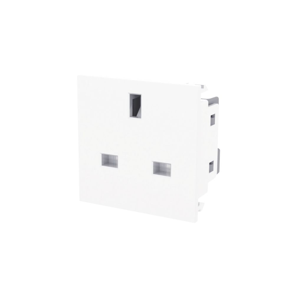

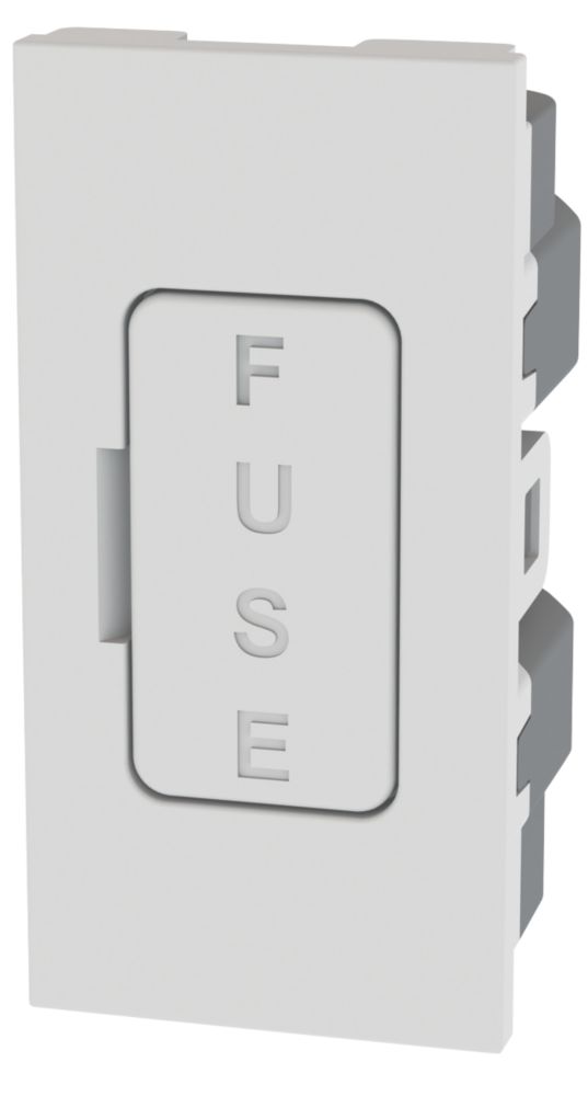

I like the suggestion of scolmore new media, it seems it's advantage over MK grid plus is you can have a 13A socket as part of your modular arrangement.
LAP 13A 1-Gang Fuse Unit Grid Module White
LAP 1-Way 16AX Grid Switch White
LAP 2-Gang Front Plate with 4 Module Aperture White
LAP 13A 1-Gang Unswitched Grid Module White
I make that about £6.30 and it fits a standard double socket box. I used it to get two sockets one heating and one cooling for my beer fermentation controller and easy to assemble and set up. In order to get the temperature controller in the same box I needed a socket box extender as the socket is quite deep but had I not been cramming in a temperature controller as well it would not have needed the extra room. Mita Extension Collars CEC 210W = 10mm and CEC 219W = 19mm
picture is single but part numbers are for double socket version.
