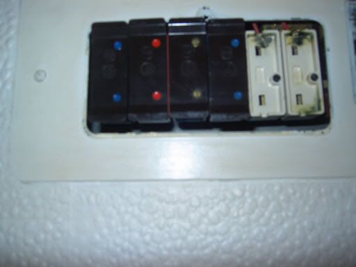

*!*? OUCH!!
11 Jan 2004
47,193
4,134
I have seen GE redspot (BS88) fuse holders suffer a similar problem, if the red spot drops out the exposed live screw behind the red spot is quite easilly accessable.
i've seen what must be hundreds of red spot fuses missing there insulated plugs but on ever one wylex!
RF: It didn't get me, no!
But I looked closely at the fusecarrier & the screws had been swapped over.
IE the fusewire screws were holding the prongs on & the prong screws were attaching the fusewire....
