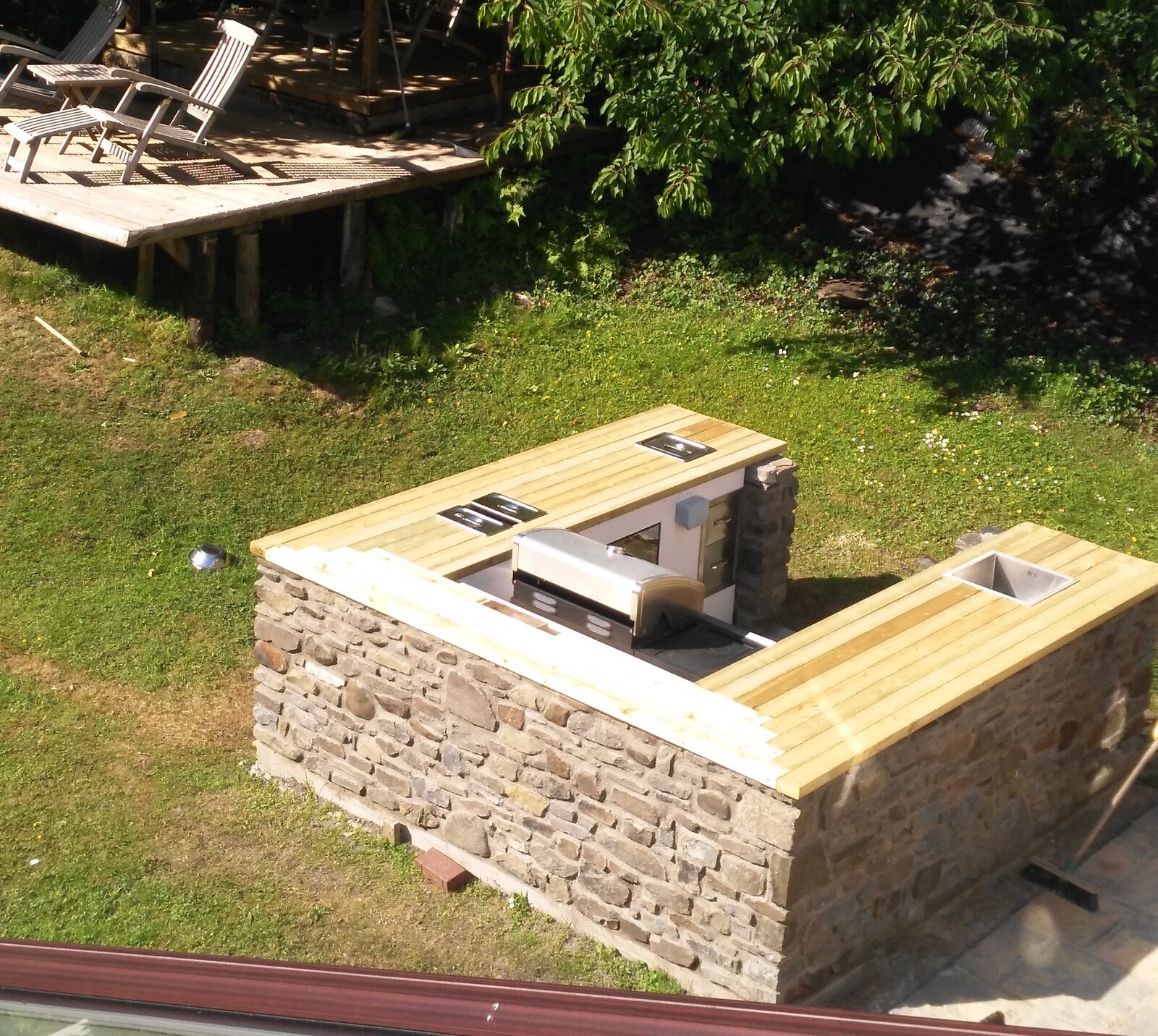

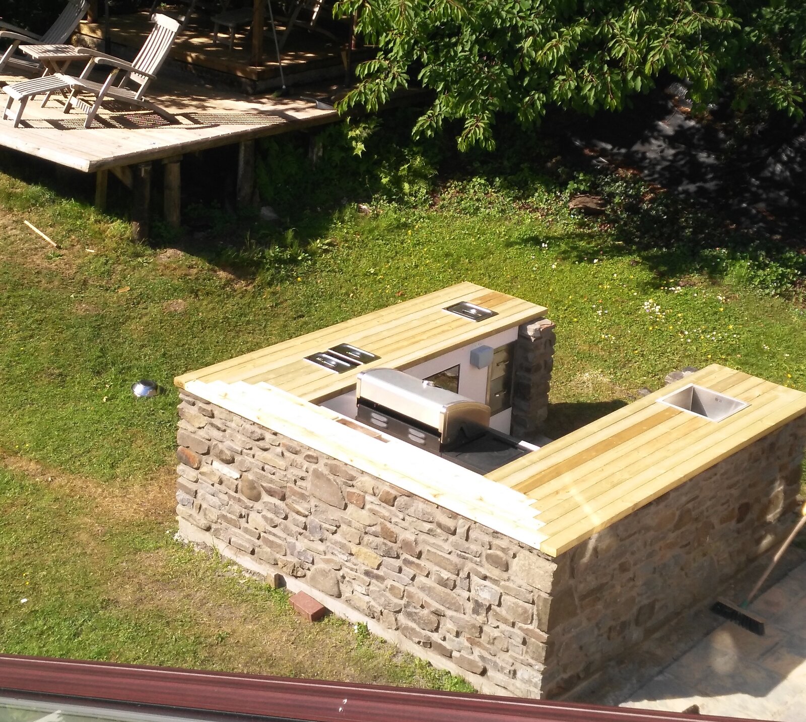

Picture of my outside grill area, almost completed.
I can bore with some details if required!

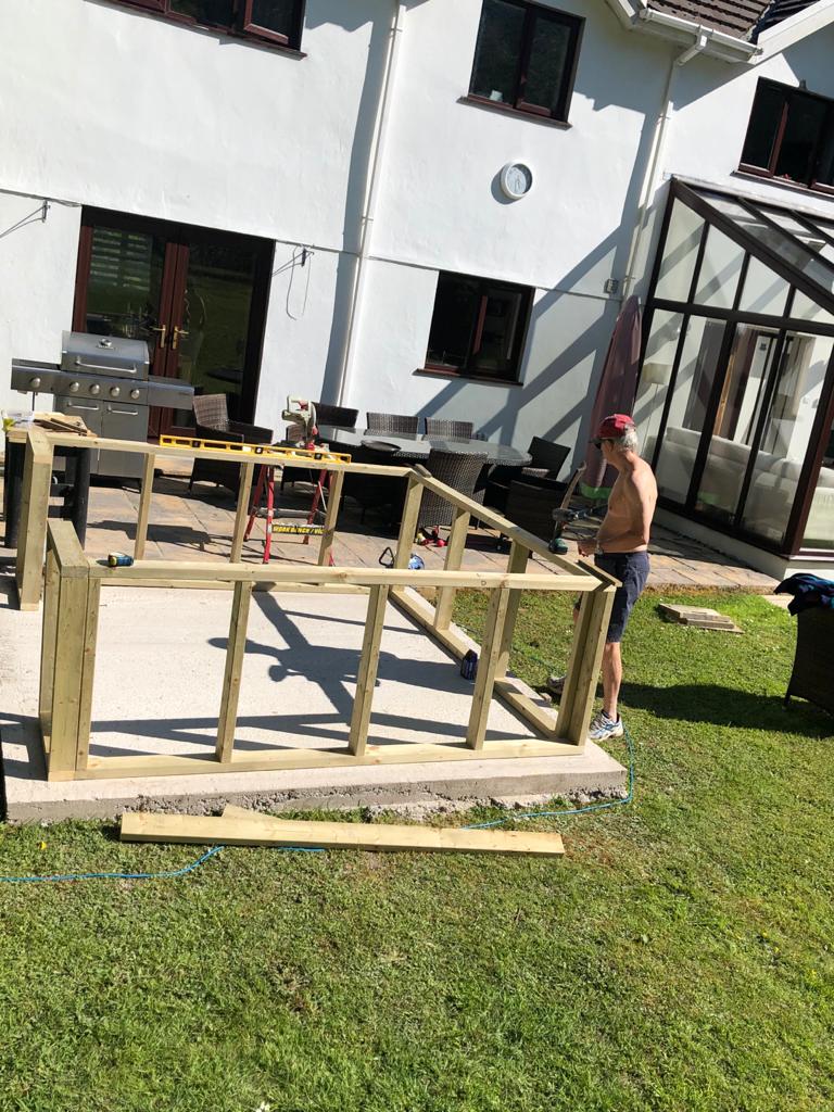

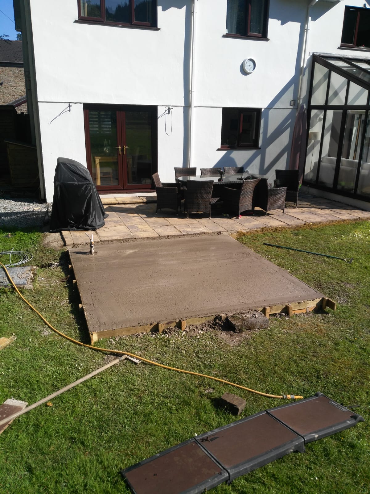

You asked for it! Wifey has nagged for something over and above a bbq grill for ages, and lockdown was the push to get on it.
I agonised over everything- I'm a gasher really- the structure, the finish, the size (the cost!).
We settled on a 2800mm square slab- shoulda gone for about 2300- timbers will fit better!
The thing has H&C water and electrics; and a wine fridge.
It was hard, we had to barrow the concrete 30m ish, and Mrs Golf is not built for barrowing. Temp was about 28 in brilliant sunshine. The result was average!
120 mm slab with some mesh I had lying around. Oh, I got some pvc wastes in for ducts too.

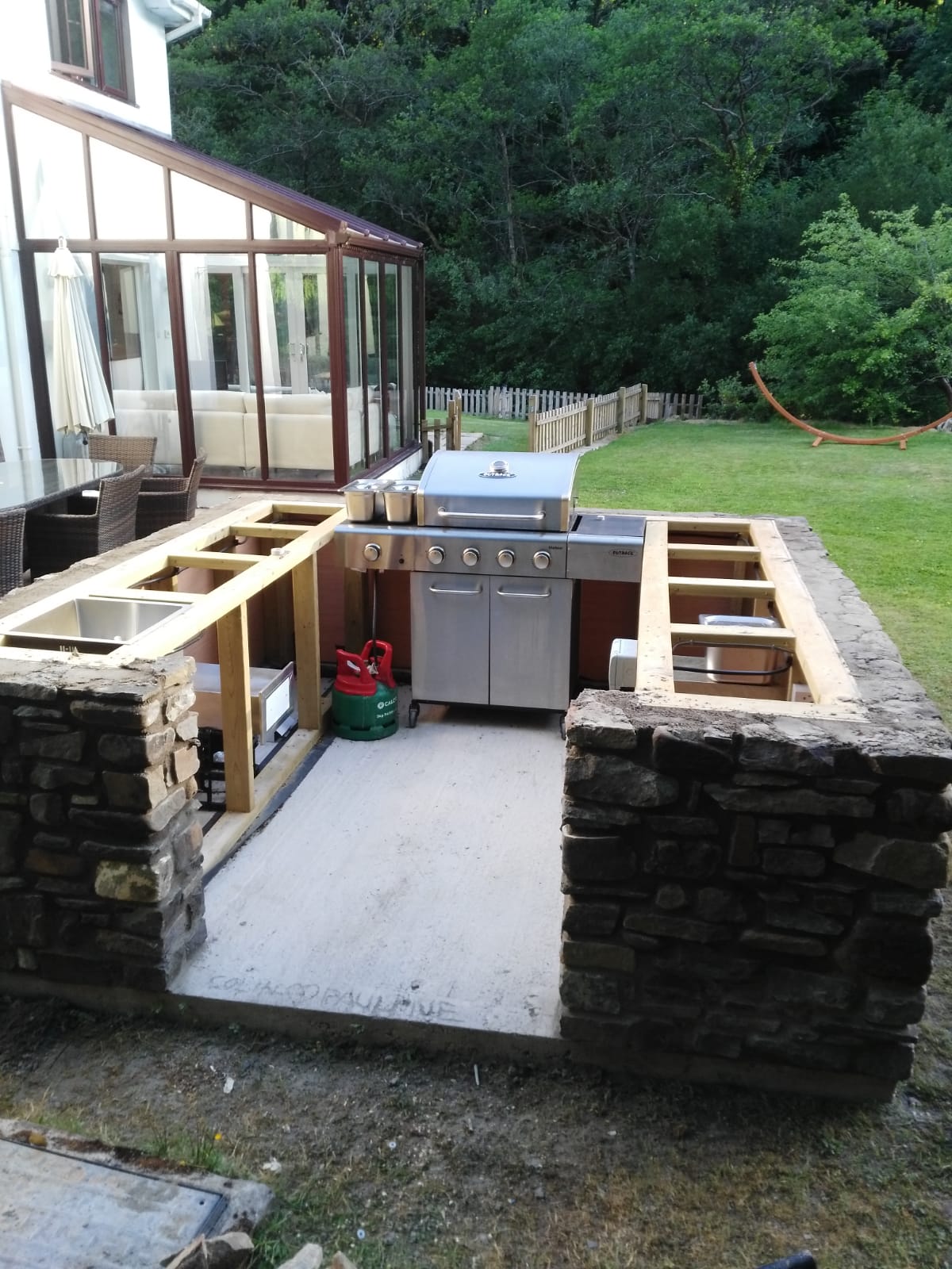

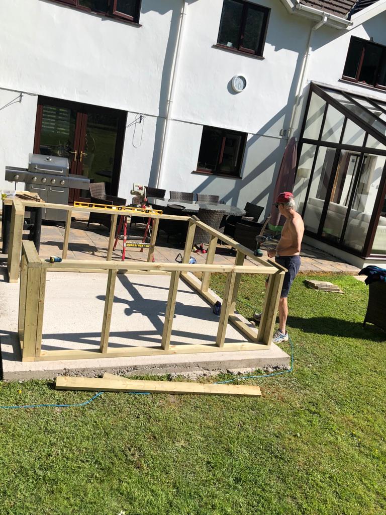

Based on what I am capable of, rather than a better solution, I decided on a carcass of C24 treated timber 4x2, clad with external ply finished with real stone.
Rightly or wrongly, I decided to wrap the bottom timbers with dpc- I had good results with my shed doing that 20 years ago!

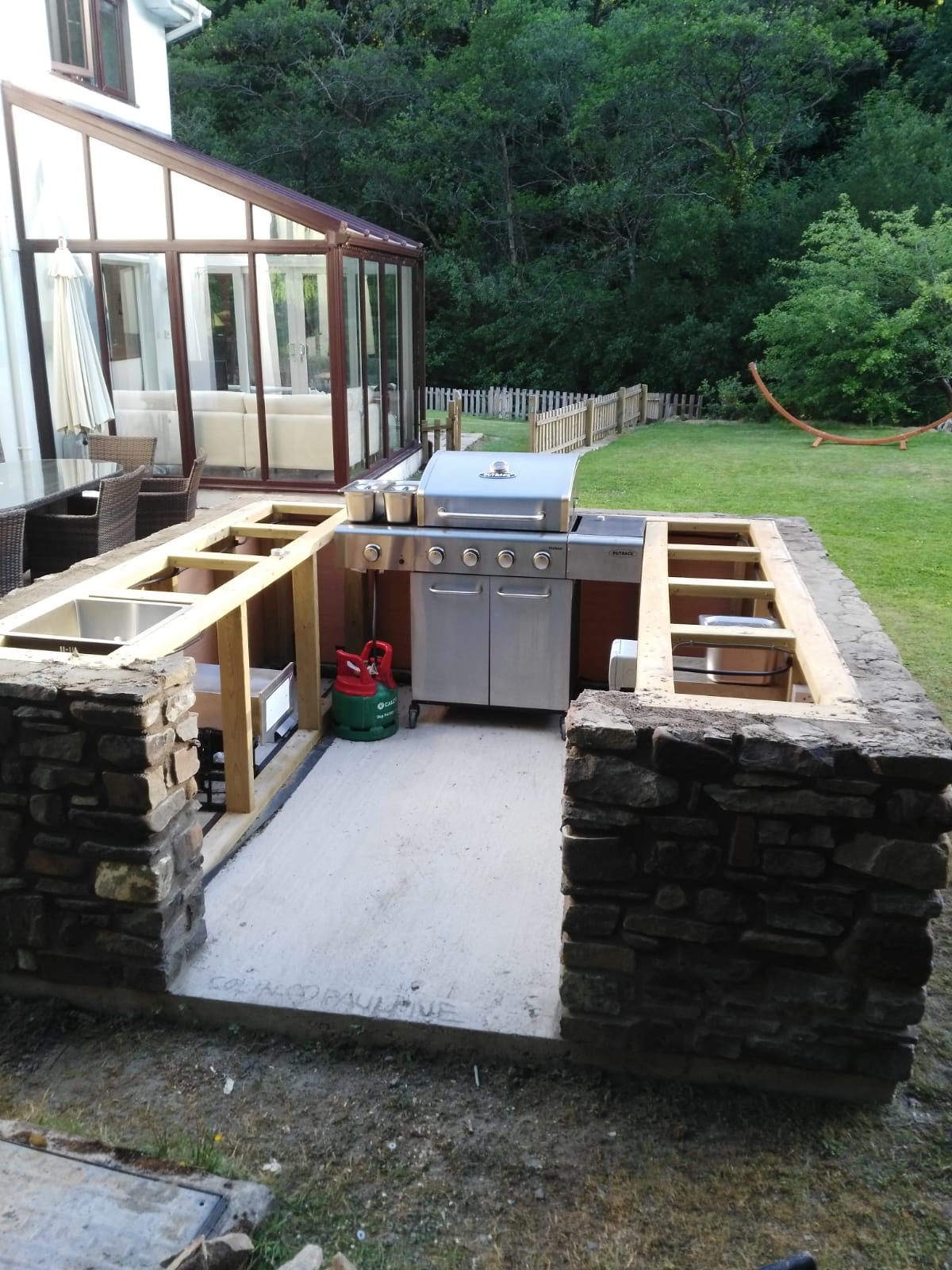

There followed an inner frame, seen here when the stone was going on. The grill's right hand shelf had to be shortened by about an inch which I did ok ish. But I forgot the inner sheathing, so now have to do it again.

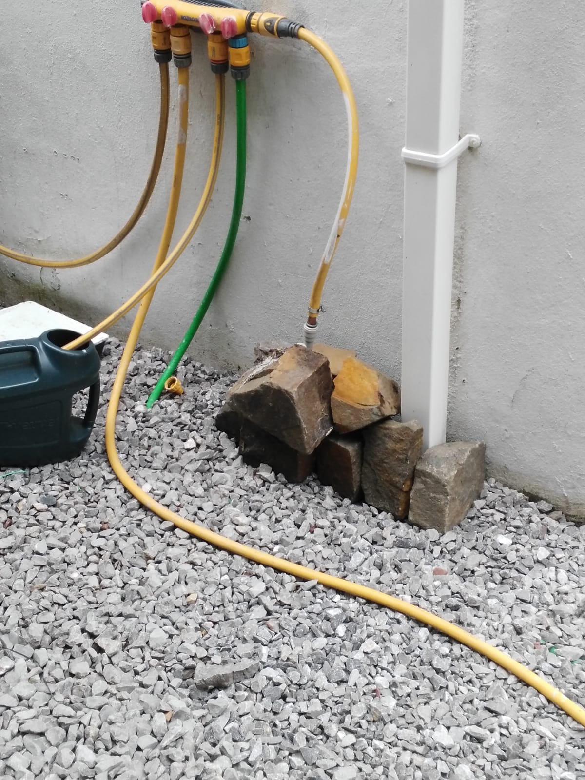

I have no pics of the plumbing..

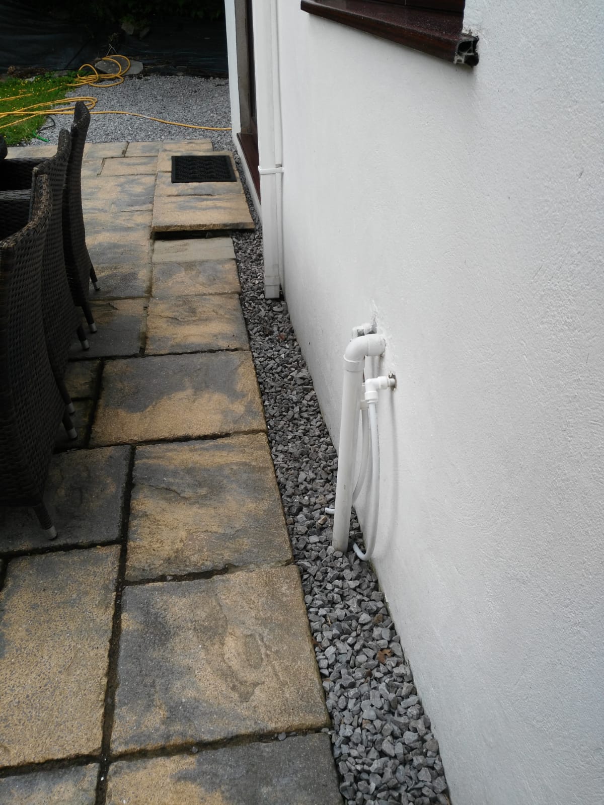

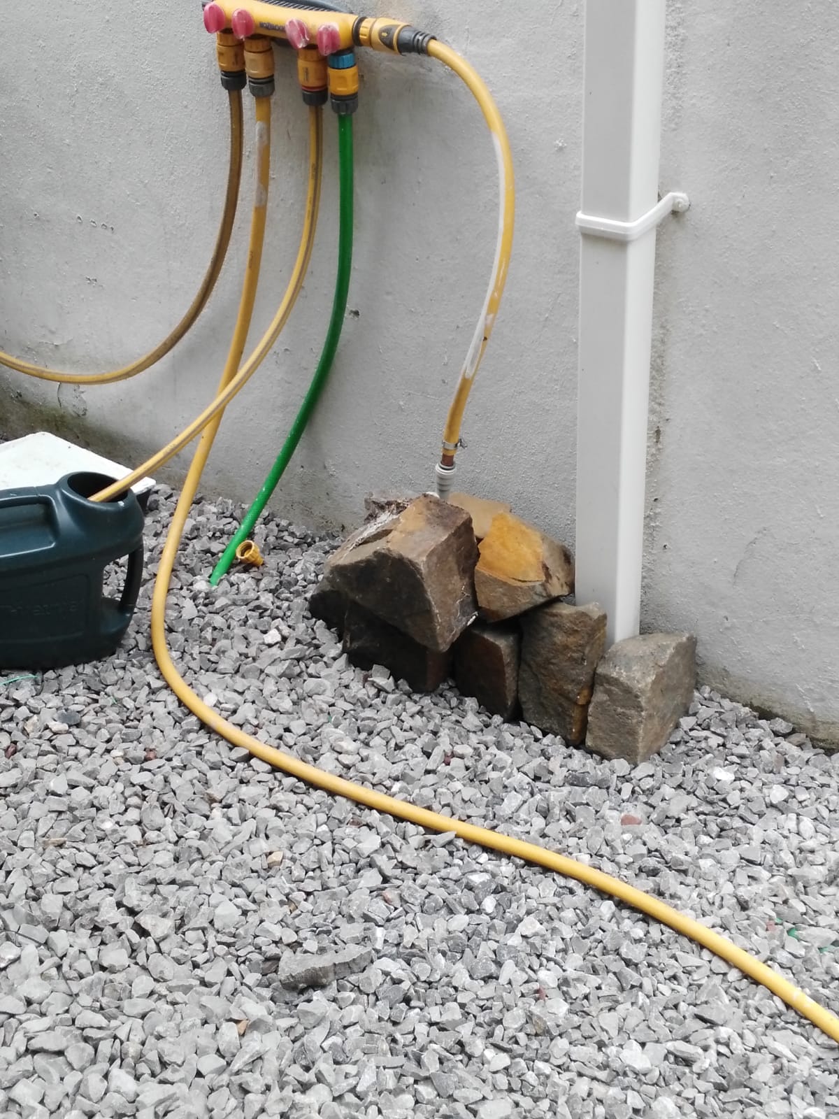

I had an outside tap feeding a hozelock manifold. For the cold, I removed the tap and replaced it with speedfit to the junction with the manifold, tee'd off left to the grill and right to the manifold. On the manifold side I inserted a double check valve.
For the hot I ran a new line alongside the cold, again with isolation valve and check valve.
The pipes are buried.
For the electrics, my spark took a second feed from an outside socket. SWA and buried.

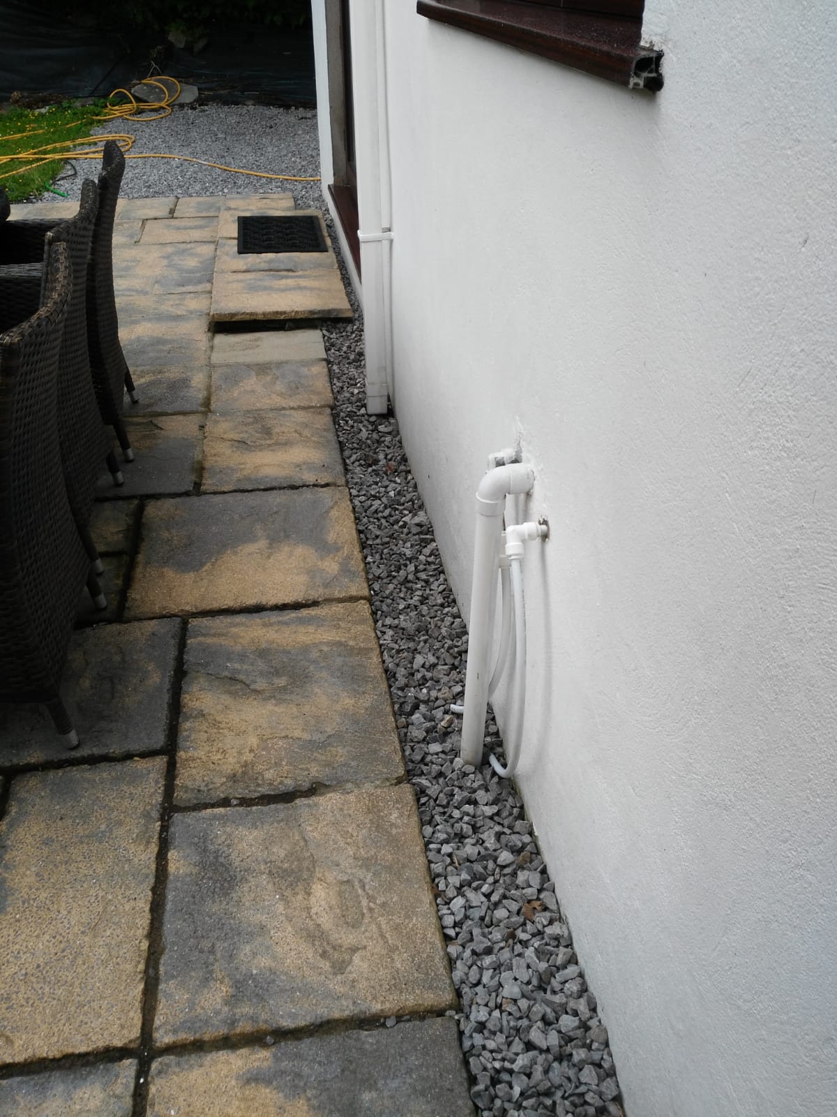

On the plumbing... Here's where the outside tap was replaced on the cold feed, and where the new hot feed emerges. It also shows the chippings area under which the pipes lay.
Here's where it goes round the side of the house out of sight, and emerges to feed the standard Hozelock manifold. We'd been using that for ages. This, and the pipes in the previous pic will have a neat box. One day!

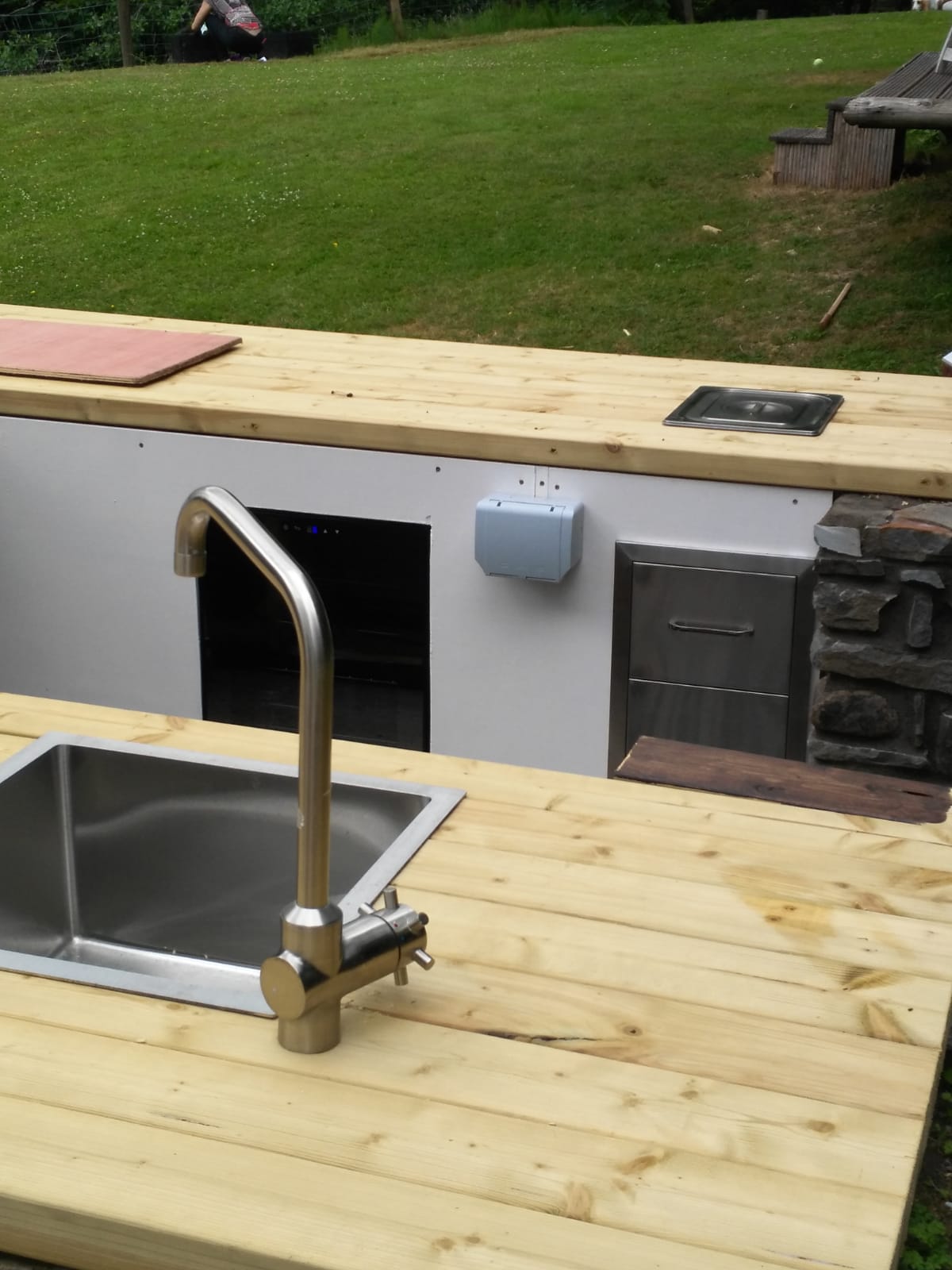

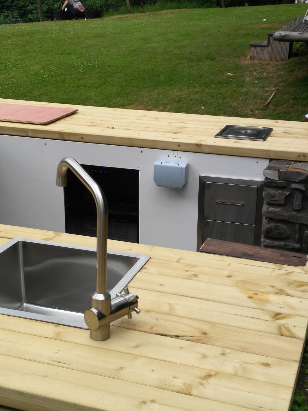

This is a pic showing the newly piped up sink; and the sheathing behind the wine fridge and drawers. All the stainless stuff is from Amazon- there is a single drawer the other side; and a stainless steel door to make a cupboard under the sink. All the ducts came in under the sink.

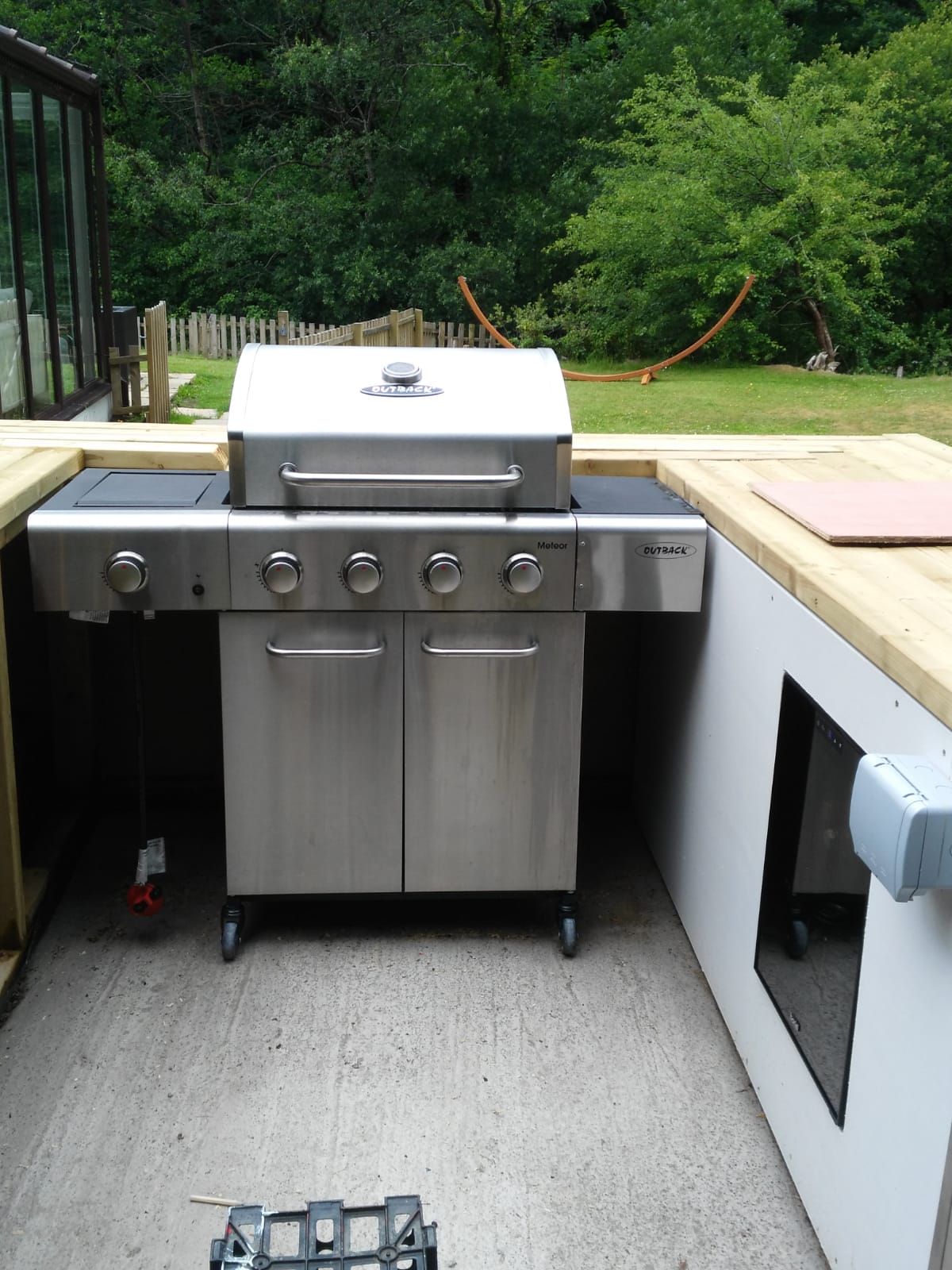

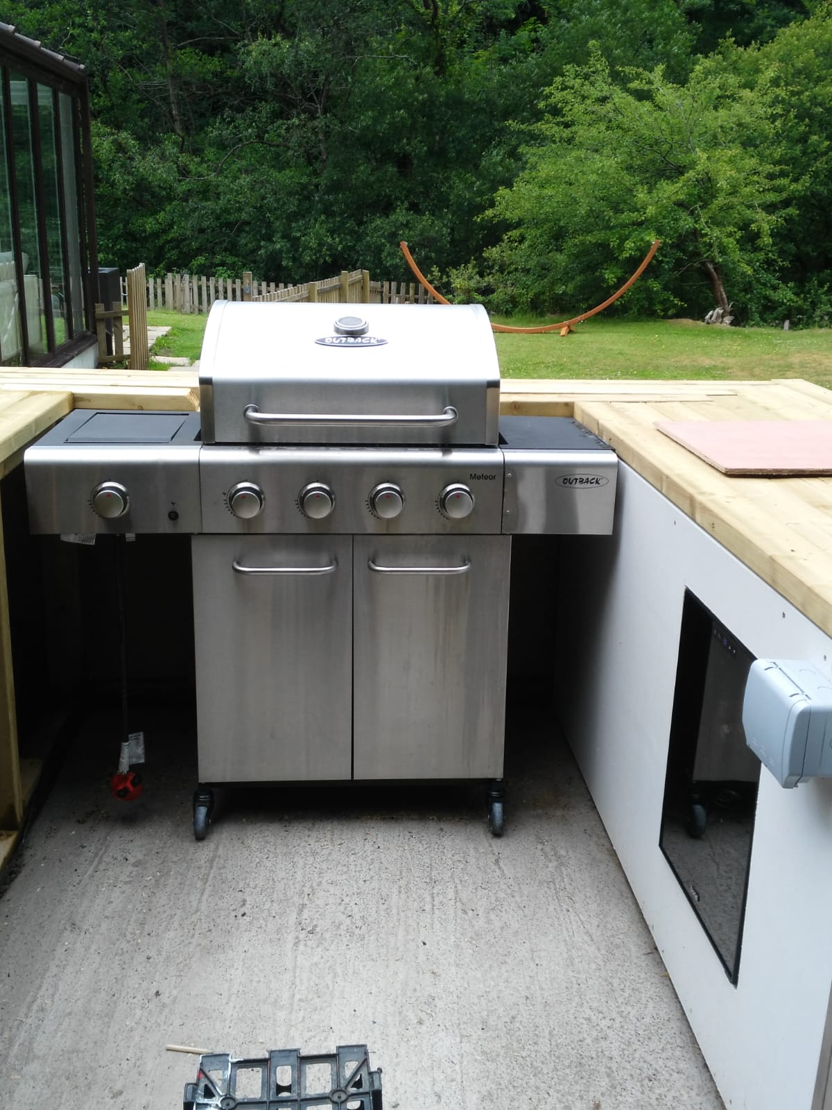

And here's the grill, which we got last year. The eagle-eyed will see that the right side is narrower than the left. I removed and cut down the original to fit with hand tools, and resized and refitted the stainless front bit. The extreme right side of the black shelf part was really quite sharp when cut, so I cut and rebated a bit of timber with the table router to take up the sharp edges. A very good result. (By my bodger standards:D.)

Looks absolutely superb, do you get the weather up there to make the most of it? Perhaps a roof would be worth considering.
Either way congratulations, Mrs G must be proud
Thank you. It's more that we like to eat outside whenever we can, not just bbq-ing. Roof? Maybe: when we were grilling as it was going up, there were days when I was really wilting in the heat! If we do a roof, it'll likely be more of a pergola. Due to my worktop choice, 4x2 glued and screwed, I'm certainly going to need covers- maybe like boat covers or the like, cos you can't keep water out. But I knew that from the off.
Mrs G is chuffed!
Looks good, are you concerned about the longevity of the top?
FWIW, horses for courses of course, but I really detest eating outside. o_O
Eddie- Ha! Those horses and course!
I agonised over the worktop. Concrete in situ/cast concrete/badly done concrete with tiles to hide it/scaffold boards. You name it, I wavered over it. Yes, the longevity is a consideration, but I plan to look after it in fairly undemanding ways- treatment (gonna make it darker)to seal it more, and covers will make a difference. At the end of the day, if it's a failure, I can do something else, but for now, it was something I knew I could do- I'm no tradesman after all.
