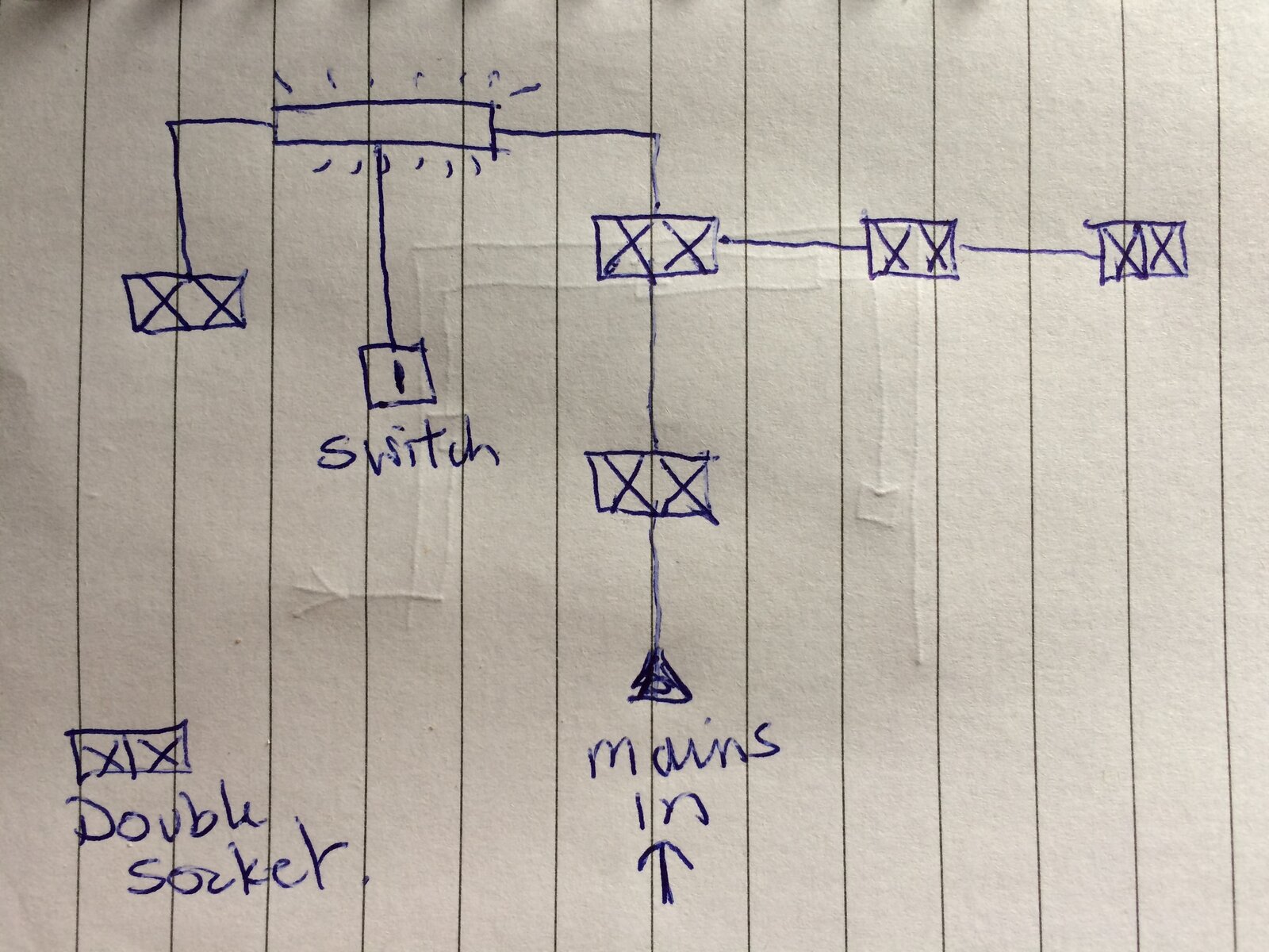

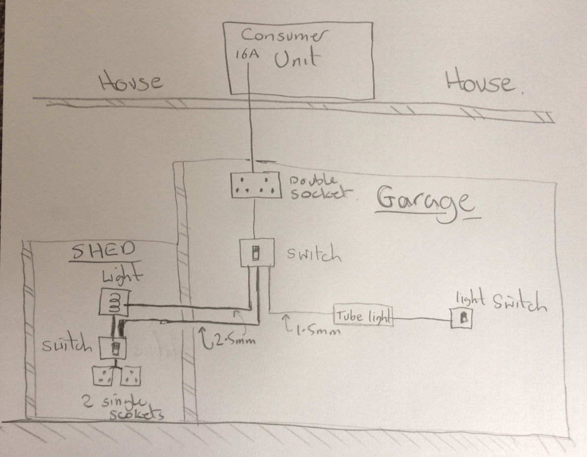

I have 5 double sockets (because there is also an attached brick shed) and a fluorescent strip light, with a switch for the light near the garage door
Dont laugh at the diagram!!
The garage circuit is on its own 16A fuse on the house main fuse box

Hi No it doesnt, it was all like that when i moved in, should there be one?
The cable to the garage goes underground if that makes a difference
It would have been signed off about 6 years ago.

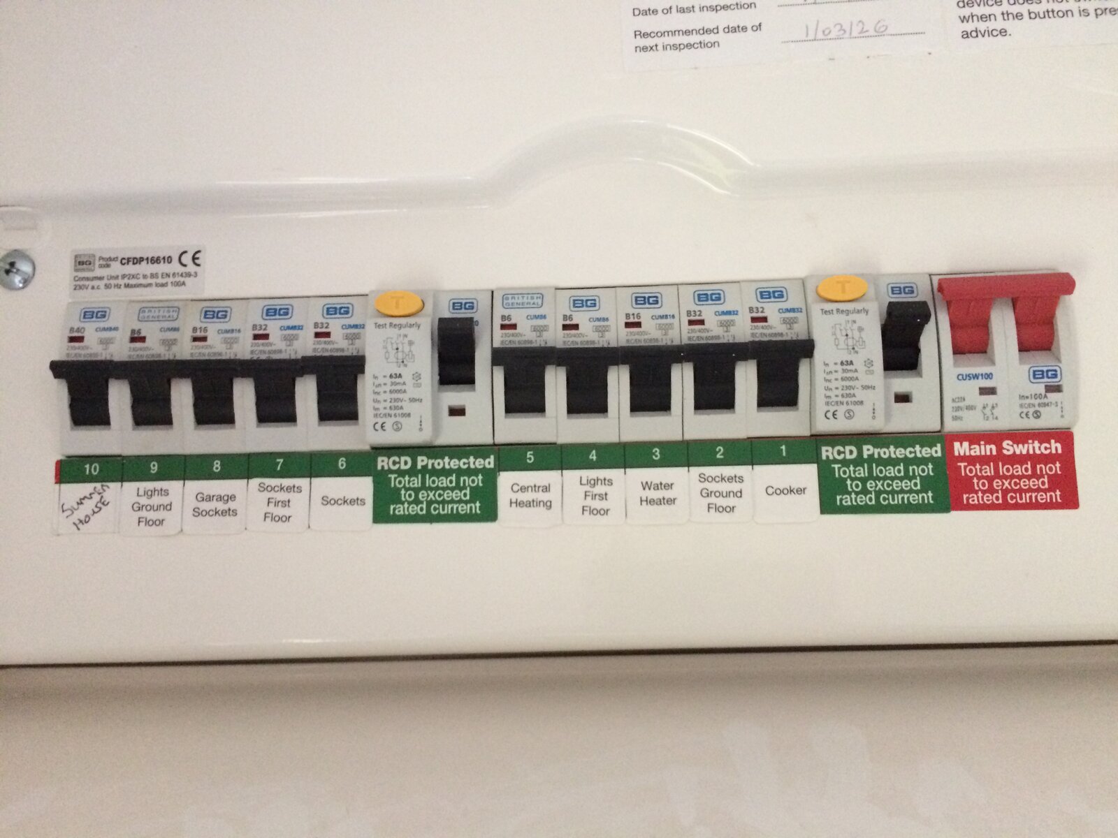

If it was installed 6 years ago the sockets should have had RCD protection.
Can you post a picture of the consumer unit in your house?

Hows that?

Looks like everything has RCD protection (as would be expected for an install done at the date you said).
So back to your original question I would still recommend using a switched fused connection unit for connecting the light, you could argue that since the supply is only 16A the fuse isn't strictly necessary but I would still prefer to have overcurrent protection as close as possible to the normal operating current and a switched fused connection unit isn't significantly different in price from a double pole switch.
I always recommend double pole switching for outside lights in case water gets in and starts tripping your RCD.

Socket would be easiest, but its not the closest lol. The light switch is the closes but i assume i cant use that.
So, use one of these (should the fuse be changed for a lower rated one?)
https://cpc.farnell.com/click/cl052/mc-13a-fused-spur-switched-neon/dp/PL14840?st=surface mounted fused switch
I'll use whatever size cable was already used in the garage, i think thats ok. Doesn't have to be smaller as far as i know.
Hopefully i can use the fused switch as the junction between my cable and the light's fixed 1m cable.
I enjoy doing this myself, just want to get it right.
I actually found a better diagram i did a couple of years ago (the original layout), when i could actually see in the garage better, but i added two sockets since then, off the first one.
I would fit a 3A fuse.
I suspect the lightswitch only has permanent live and switched live, not neutral so it's probablly not possible to branch of there.

Original layout
