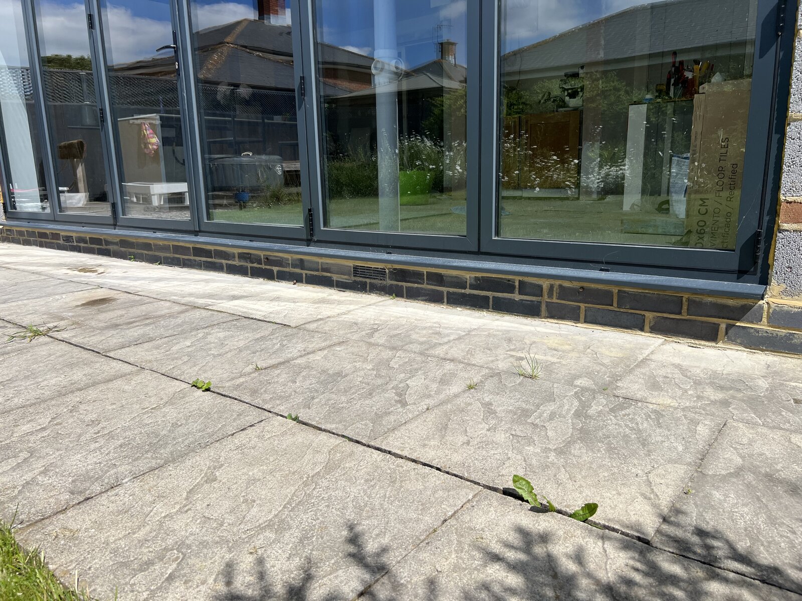

Hi all. Wanted to get peoples advice on my next project. So I have some bifolds with 600x600x8mm tiles inside and plan on putting the same tiles outside so it flows. Currently there are big standard outdoor slabs not cemented down as pictured.
My initial plan was to take all the existing slabs up, build several wooded frames and then hardcore and cement them to make a long base and then standard tile on top of that.
However other friends and family have got my brain thinking about other, and maybe easier options and wondered what your opinions are or advice on how best to do it.
Suggestions included building a wooden base with joists etc and then over boarding it and tiling on that. Another was pouring the big concrete slabs on top of the existing slabs laid on the floor.
Really any advice welcomed. Thank you.

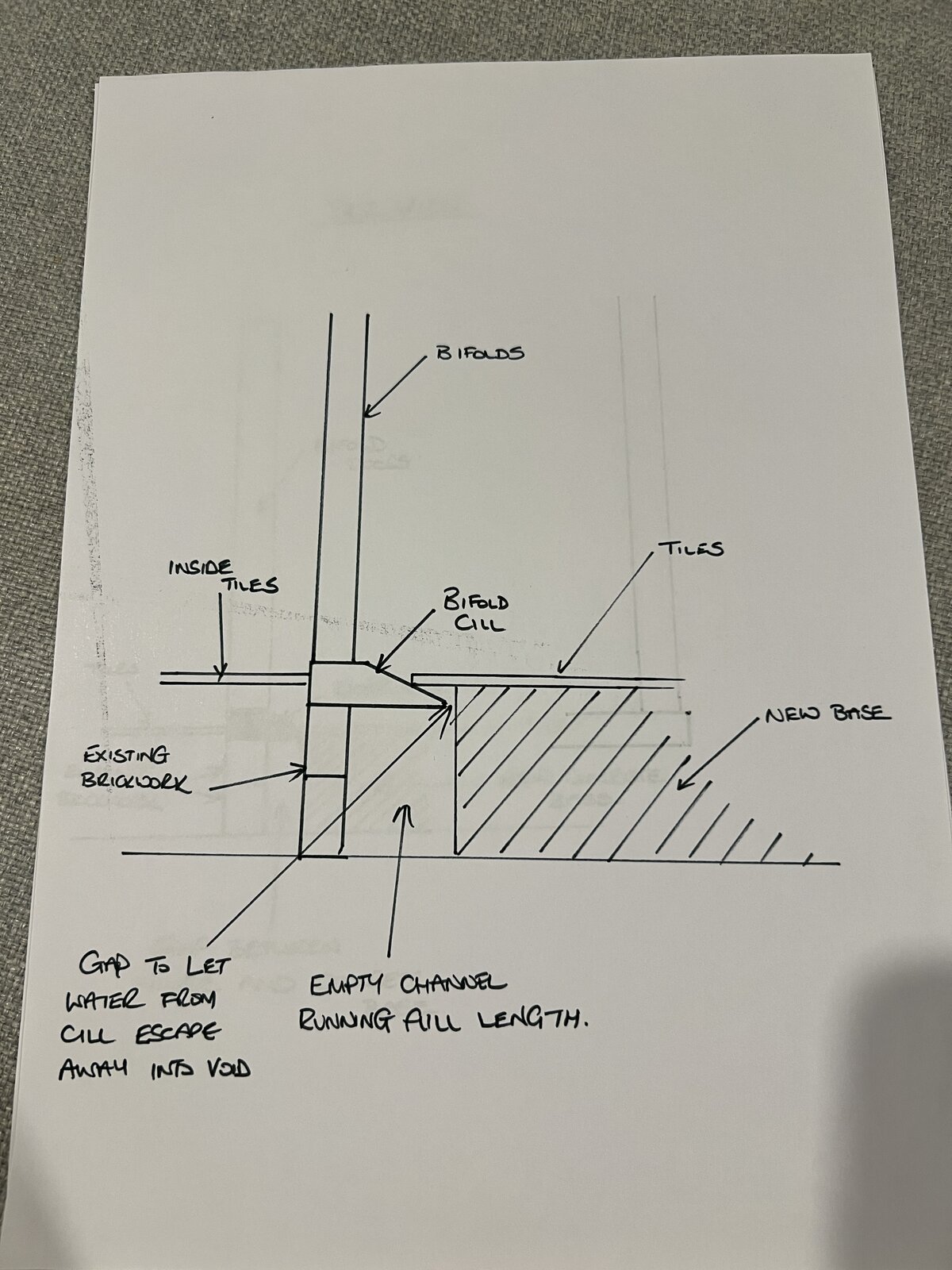

Building regs state that you need to have min of 150mm between the patio and the DPC. If you bridge it you will have damp issues inside the house, and if you build higher than it, even leaving a small gap you may have questions during survey if you sell the house.. (which you can deal with but separate subject)
If you really want a level-as-possible transition from inside to out , i would build an aco-drain along under the lip of the bifoild threshold cill, so any rain running off there will flow in to the drain. Then plumb the slot drain into a combined sewer or properly build soakaway
For the small gap between the drain and the house wall, you canlay concrete along the base of this, and slope it sideways to remove any water out from there, or run some 50mm pipe transverse to the house to take any water away from the house
then take up paving slabs
inspect the old base
remove if its bad (soil, weeds, worms etc)
place new sub base (plus weed membrane if you want)
100mm crushed stone sub base
100mm concrete slab on top of this, finished with powerfloat to the tile thickness Plus tile adhesive thickness depth below the aco drain at your threshold.
Slope the slab away from your house at 1:80 slope
I highly recommend not using the internal tiles, (not all are suitable for outdoor), and using proper non slip outdoor 20mm thick porcelain tiles

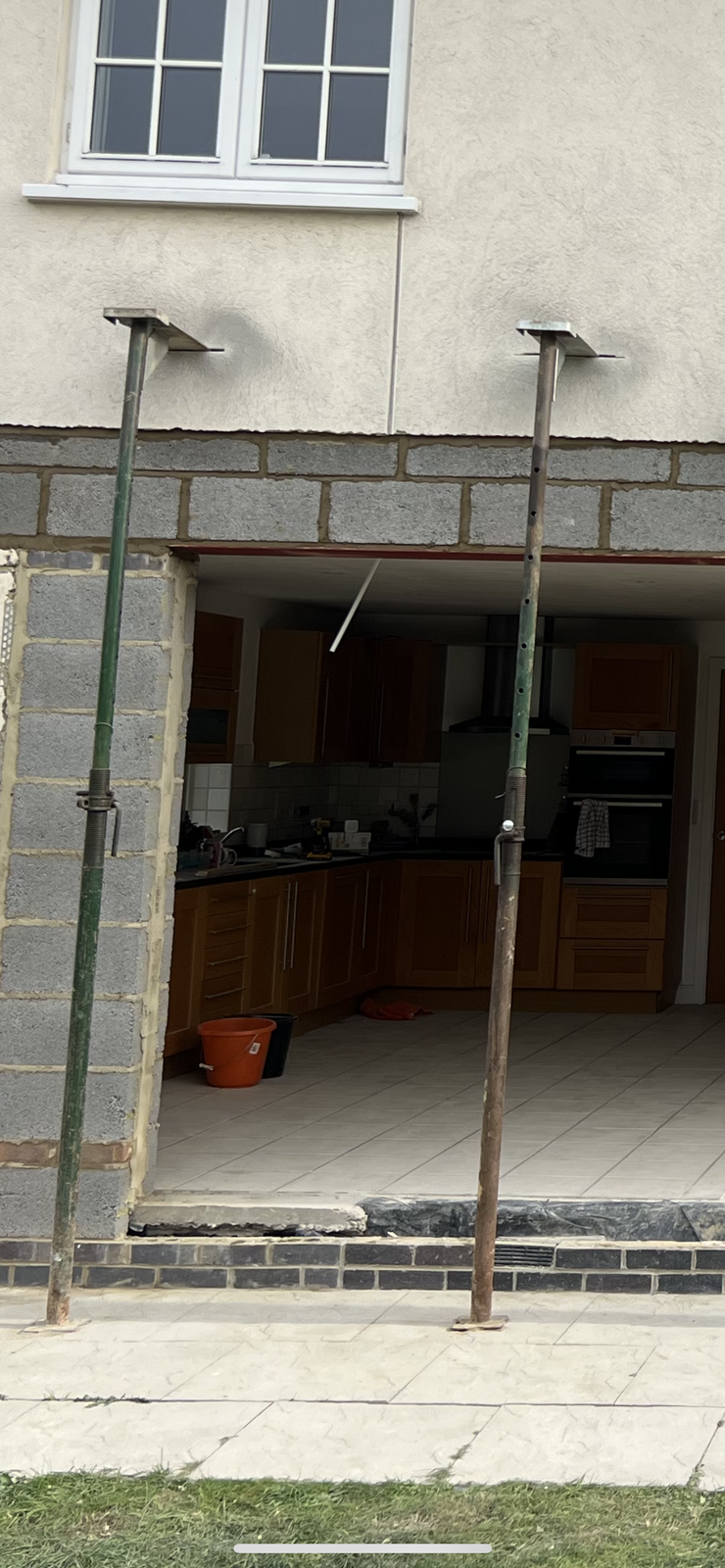

I don't actually know where abouts the DPC is on my house, I cannot see it sticking out like you sometimes can. Potentially where the normal bricks change to block work? I'm not sure. I have this pic from when the opening was made and there is DPC in that place on the inside course as pictures.
Another quick Q which will help me digest it tonight... if I am only having the patio and sub base against the house directly below and/adjacent to the opening for the bifolds... is it as important regarding the DPC levels as there is nothing above it for damp to rise to? Do I make sense? As in there is no bricks as it's the opening and bifolds above that join. Just a thought I've had.
Regarding the arco drain, I was planning on doing something like this in an earlier plan. Would it be suitable to plumb this into the drainpipes that come down either side of the opening from the roof? It will all be the same rain water
Yes you make sense. Yes it's as important as moisture if trapped behind the patio can be absorbed along your wall and not just up it
Thanks again for your help. So I've had the crayons out and knocked this up and hoping it's incorporated what you suggested to some extent. The 'empty channel' is where I could lay the arco falling from the centre running sideways and into the drainpipes at either side of the bifolds.
I was planning on having the tiles sitting slightly above the cill going halfway up it as picture.
Am I on the right lines?
