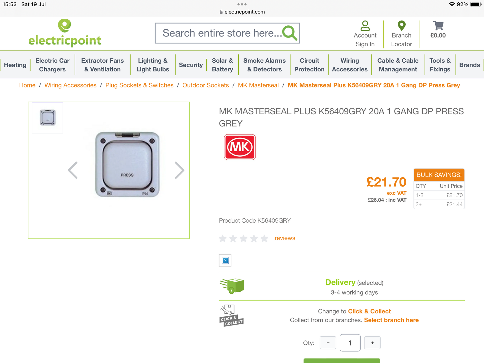

You could use a mk master seal 20amp double pole switch fitted next to your double socket outside ….

I’m wondering if you have thought about what you propose.
The reason for having the DP switch is to isolate the socket, in case of water ingress. Yes?
BUT if you fit the isolator outside then the DP switch will be as liable to water ingress as the socket. In fact, you increase the risk of water ingress, as you will have a junction between the switch and the socket. This can be a point of leakage.
So you could increase the risk!
Fit a DP switch is a good idea, but fit it inside!
I agree with the others.
Putting the DP switch outside completely defeats the point of having it. In fact it increases the risk of water ingress causing an RCD to trip because having more fittings outside simply increases the number of potential leak points.
