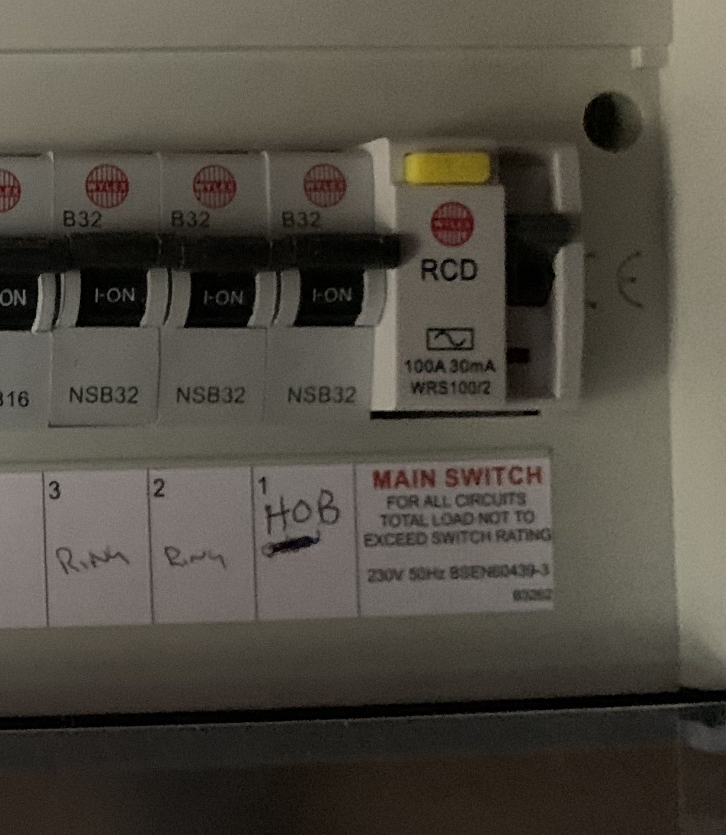

The circuit doesn’t have an RCBO on the board but there is a breaker to the right of it that protects it. Eg... the main switch is an RCD breaker. Photo attached.
If that is the main switch that turns off all circuits then you do not need an RCD socket. One of THESE will do you
Note that it is not best practice to have a single RCD for all circuits because, if there is an earth fault, the house loses all of its power.
Thanks for that, that’s great. Yes, I agree that the single RCD is not great but it’s something we’ve got used to. We’ve got two boards so at least if one trips there’s the other still in operation. Not ideal but without spending a lot of money I guess it’s fine for now.

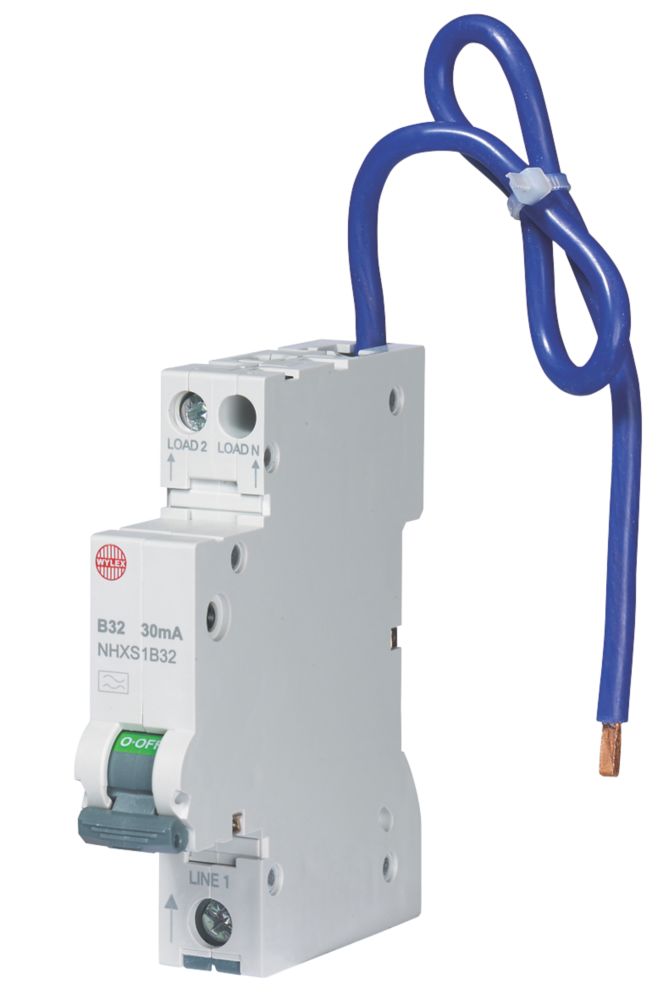

There are many options, and it is up to you, and any electrician you employ which are used. Wylex do a small size RCBO
4766X_P
it may be these will fit in the existing board? the old one
44169_P
was taller and would not physically fit in some boxes, at around £32.50 not cheap, but neither super expensive, swapping the existing RCD for an isolator and using RCBO's is likely an option, I say likely as does depend on earthing type etc.
But new board with cheaper make is also an option, some makes of RCBO are much cheaper at down to £14 but a consumer unit is a type tested distribution board and to keep the type tested label you can't use different makes, down to how jobs worth the electrician is.
