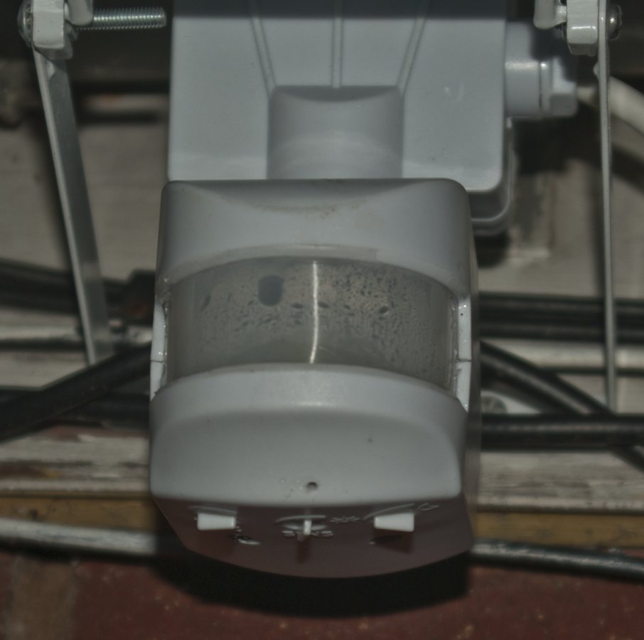

Cheers for replies. So you reckon drilling a hole at the bottom will be fine with IP44? Wouldn't it look unsightly?
A 2mm hole would not be noticeable, only needs to be big enough to let water out,, IP44 is protected against dust greater than 1mm and water ingress from water spray so should only get water in it when it settles on the housing.
The hole was very small, the idea is it breaths through hole rather than through joints as air inside expands and contracts, any joint tends by surface tension and capillary action to have water around them, so as air contracts it sucks in the water it is near impossible to seal. Good design should include a breather, but it seems good design is hard to find. In theroy you should not have to do anything, in practice you do. If the PIR was separate from lamp it would not be so bad, the lamp would drive the water out again, but often they are combined so lamp sucks in water and PIR stores it until it touches some electronic part then it fails.
