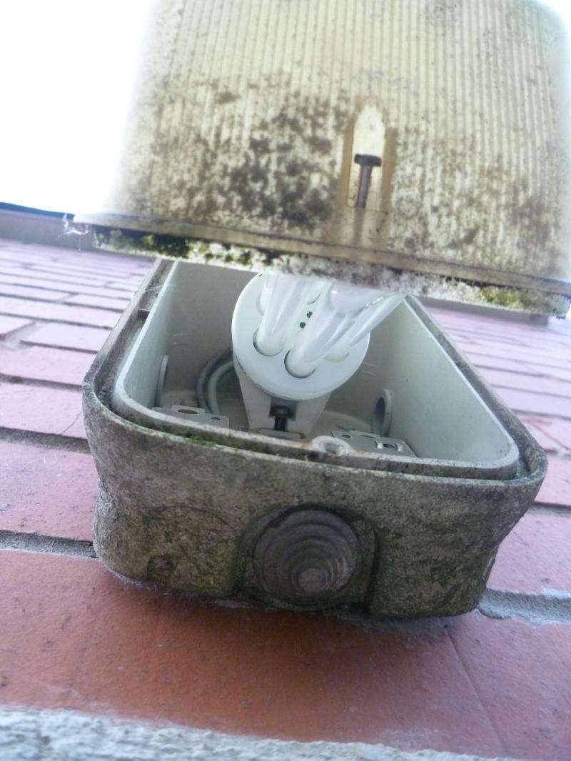

Greetings,
I currently have an outside light that switches on/off via a internal switch. I'd much prefer to have a PIR outside security light instead of the current silly thing.
My question is can I just remove the current light and wire up a outside light? Or is it far more complicated?
Picture of current grotty light incase that helps,
cheers :)

Oh, you have chosen the wrong word. ;)
You are allowed to.
It is possible.
Judging by the questions on the forum, whether you can or not is impossible to say.
Which light fitting you could attach really depends upon the circuit which is feeding the existing one.
A floodlight should not be attached to a lighting circuit.
D'oh.
I'm guessing it's a lighting circuit currently.
What I should have put really I suppose is; does this job need a sparky or is a simple case of remove silly light and hook up new one; which apparently it's not! :(

As EFL intimated earlier it would be wrong to make assumptions (which you are here) based on the limited information provided.
Your assumption is based on?
6Amp MCB?
1mm Cable?
Multiple lights on the circuit?
Whereas we could have one light on the circuit, 10Amp MCB, 1.5mm cable.
This is where the DIYer making assumptions can get things badly wrong. You are not impudent because it is a valid point to raise but remember circuit design is an integral part of the installation.
As an aside a 500w lamp would breach the Control of Pollution Act whose guidelines now steer people to less than 120w.

The answer to your question is yes you could simply replace your outside light with a PIR controlled version - however you will need to ensure that the current switch and outside light have both live and neutral (possibly cpc) available.
The PIR lamps manufacturers instructions may also state that the light unit must be placed on a 3Amp fuse in which case, provided you have the live neutral and cpc, you could simply replace your current (single gang) light switch with a switched Fused Connection Unit.

You can providing you do not alter or overload the circuit.
