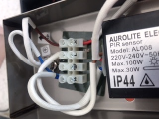

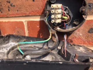

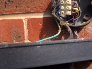

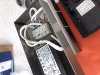

Hi, we’ve been renovating our house and have come to change the outside lights which all lights are currently setup on individual circuits with a switch. All old lights have a PIR. Our new lights also have a PIR. It’s currently setup do that if there is movement with the light switch OFF, the lights come on. If the switch is ON the light stays on. My new lights have arrived, can someone please confirm the correct connections required... thanks, Chris

The live from the switch goes to terminal X.
The permanent live to terminal L.
Neutral to N terminal
And earth conductor to earth terminal.
