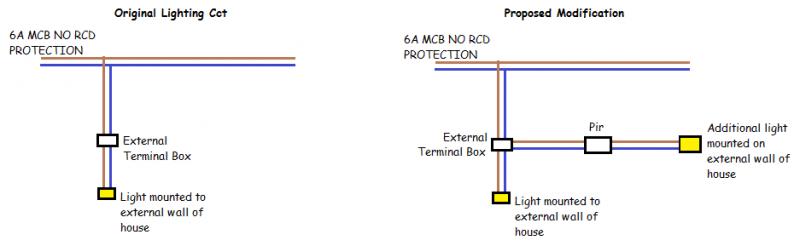

Hello,
Just wondering if anyone could confirm the following wiring modification would be correct.
The cct from consumer unit is the downstairs lighting circuit which currently has 1 outside light connected to it. I plan to add another light powered from the same external terminal box as in the picture, the new light and pir will be attached to external wall of house. (Of course the earth runs throughout the circuit.)
Also, would the addition of an outside light require RCD protection on the lighting circuit? (The light will be approximately 2m high from the ground and is metallic).
Thanks,
Hi, how is the existing light controlled ?
Regards,
DS
The existing light is controlled by an integrated PIR on the light fitting.
If it makes any difference, the existing fitting is 10W LED and the proposed is 12W led bulb.
The external terminal box is fed from a permanent live in the lighting circuit, there is no internal switch to turn the outside light off (should there be?).

No, what you propose would be fine,but you require RCD protection as the light is external. If your CU is new you can retro fit an 6a rcbo.

Particularly if the OP provides RCD/RCBO protection to the circuit, I would personally always be inclined to advise an indoor double-pole switch, to enabled the outdoor bits to be isolated should they fill up with water and cause the RCD/RCBO to trip (taking out the rest of the lighting circuit, if not more). A control switch also offers the opportunity to activate the 'on'-over-ride facility of the PIR(s), if they have it.

Well is an RCD required in this instance? (for an additional outside light wall mounted)
I was thinking of adding an RCD anyway on a safety aspect rather than for just meeting the regs.
Not, specifically for a light; nor if your new cable is visible (not concealed without mechanical protection).
You may of course do that but it would definitely be more beneficial to install one on the socket circuit.
Existing cable is flex clipped direct to external wall with no additional mechanical protection
socket circuits are protected by a rccd
If this entire circuit (both indoor and outdoor bits) were being installed now, there would be a requirement for the circuit to be RCD protected if any of the internal parts of the circuit were buried (less than 50mm deep) in walls. However, the regulations are not 'retrospective', so that requirement would probably not apply if you were merely extending the outside bits of the circuit (with non-buried cable).
