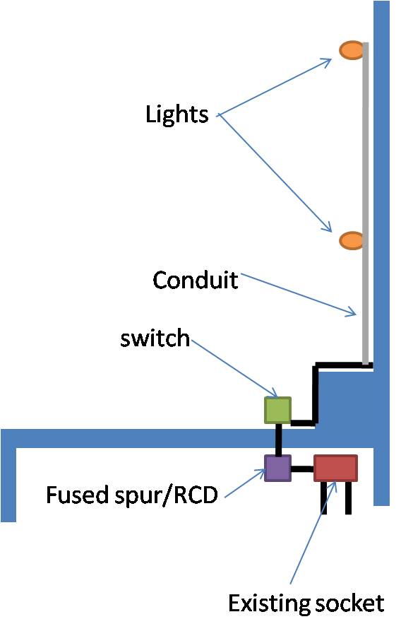

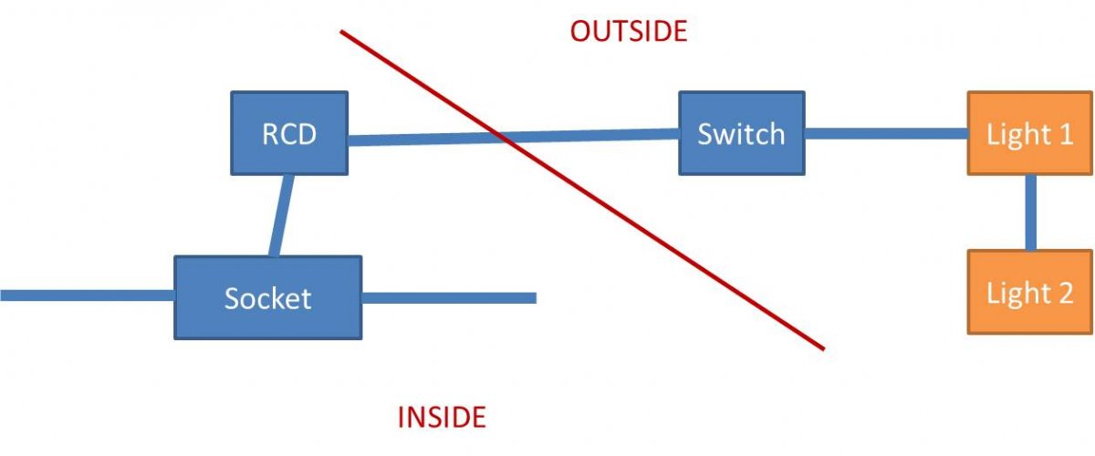

Hi All,
I would like to fit two external lights. These will be 40w or so bulkhead fittings. How can I get power to them?
I have some a socket on the inside of the wall where they would go underneath the kitchen counter. This circuit is not RCD protected and has a 32A breaker.
From what I have read I can have a spur from the socket to a 30mA RCD. This will then be connected to an external switch and then to the lights (see picture). Is this correct/safe?
I intended to use galvanised conduit to house the cable (mainly for the look). What cabling should I use outside? It will be about 2m to the first light and then a further 2m to the second light.
Thanks in advance.
Doug
RCD's are not required for external lighting, and are not advised due to problems with nuisance tripping due to dampness.
From your sketch, replace the RCD with a 13A fused spur, fused at 3 Amps.
Galvanised conduit requires specialist tools and training to install, you would be better off using cable with weatherproof glands.
But are required for concealed cables, so he might have no choice.
Not necessarily compliant.

The existing socket is under the kitchen counter but accessible (for washing machine etc.). I intend to spur from there and surface mount the fuse unit/RCH unit next to it and then go immediatelly through the wall to the outside where I will fit the switch.
I would then like to run cable around an old chimney breast to the wall where the lights will be mounted. That is where I would like to have the galvanised conduit. I would do junctions with Tee boxes.
As far as I would be concerned the cable would be sealed coming out of the switch and then sealed entering the lights - the conduit is just for show...
I'd say that you don't need an RCD in that case.
Do you particularly want the switch outside?
You'll still have cable on show outside, though.
Then you'll be needing a stock and die set, a pipe vice and some cutting compound, as you'll need to thread the ends of your sections of conduit. Which really is not a difficult thing to learn how to do.
Would cable such as PRYSMIAN LV ARMOURED 6943X 3-CORE CABLE 1.5MM² X 10M BLACK be appropriate?
Unlikely.
Read this: [wiki]Electrics%3ASWA_gland[/wiki] to see how SWA cable has to be terminated - it's unlikely that your lights would be suitable for 2 glands. Plus that cable has a minimum bending radius of 72mm, which will make going around those corners awkward.
