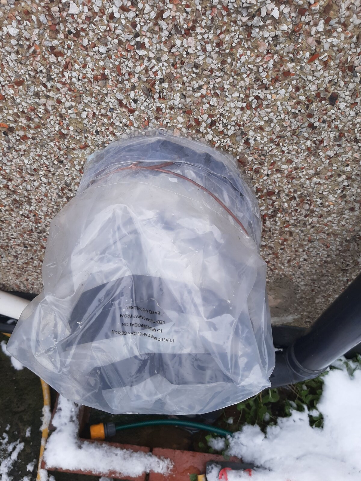

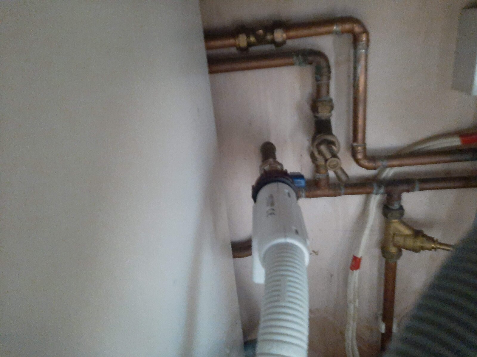

Here is the stopcock that he fixed and also a picture of my insulation of the tap. Two small towels wrapped around the tap, covered by a plastic bag. All tied and taped very securely. How much would you guys charge for such a professional job?:LOL: It took about 30 minutes.

Which one of those copper pipes goes directly to the outside tap ?
The lower one, taken from the rising main. It has that t-shaped handle on the stopcock.
The uppermost pipe has an isolator on it that is turned with a flat blade screwdriver......is it that one that goes to your tap outside, rather than the traditional stopcock we can see?
John :)
John :)
my thoughts exactly when a screwdriver was mentioned
