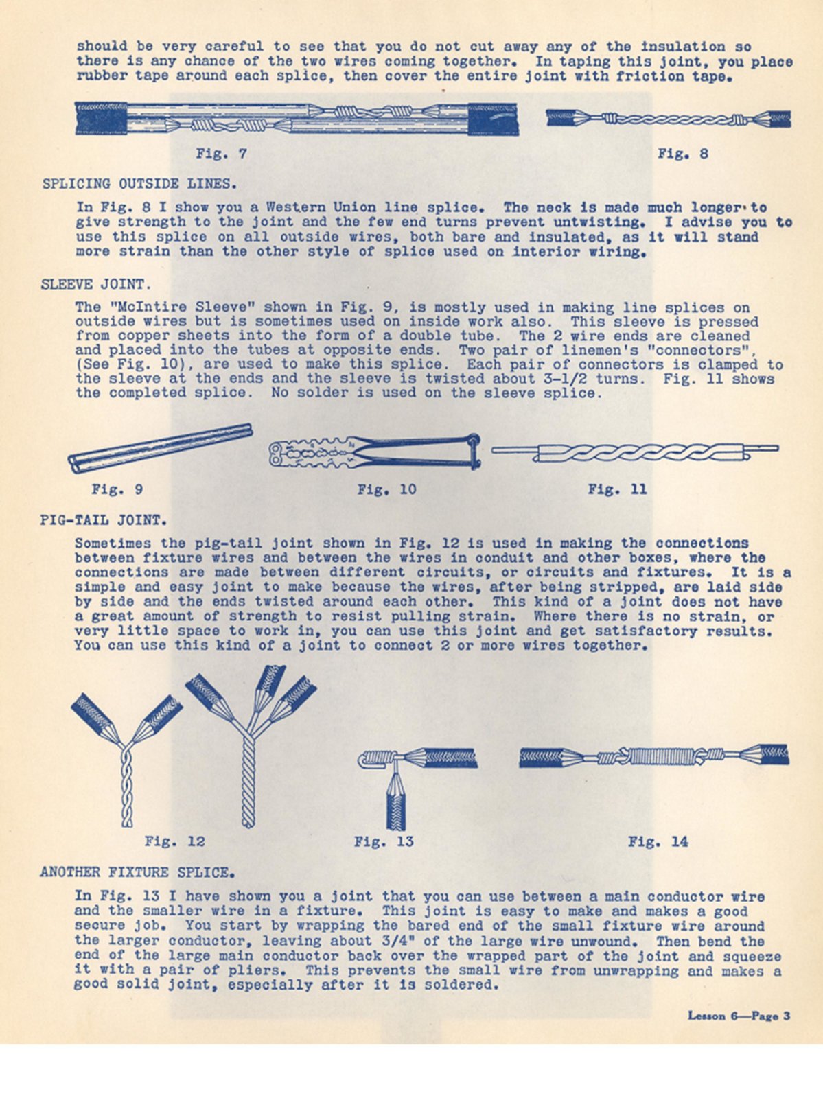

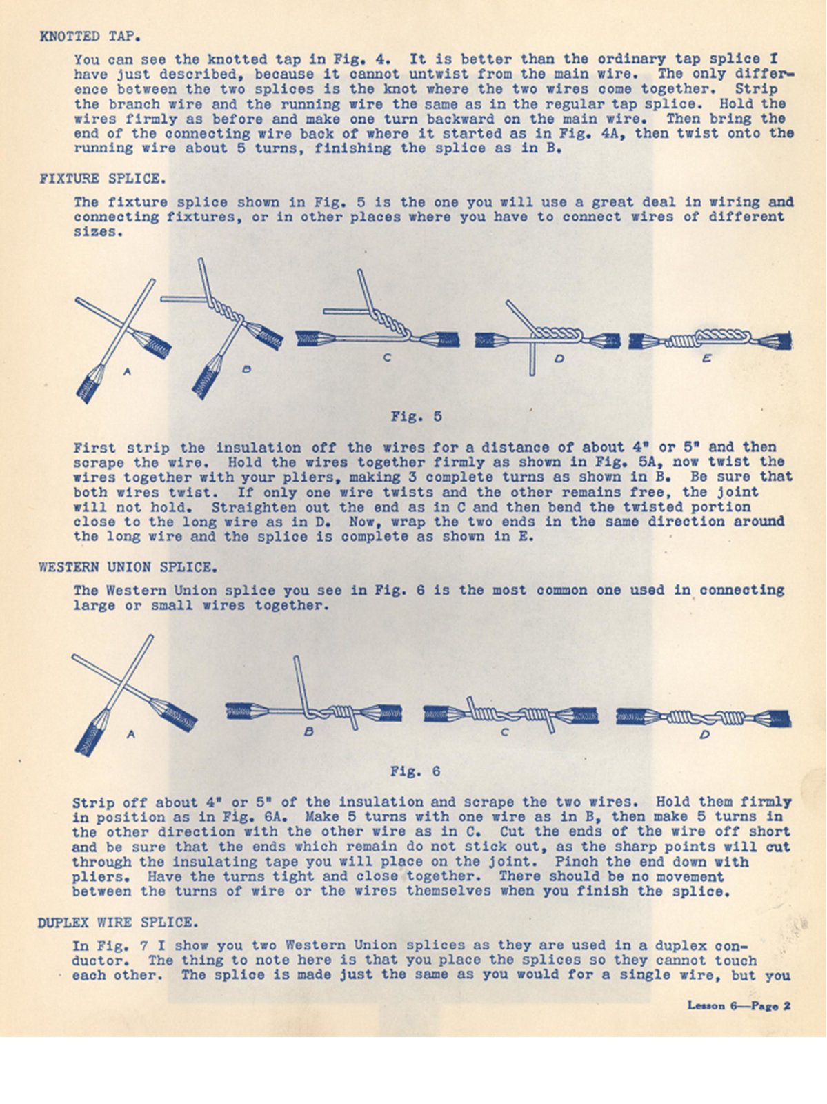

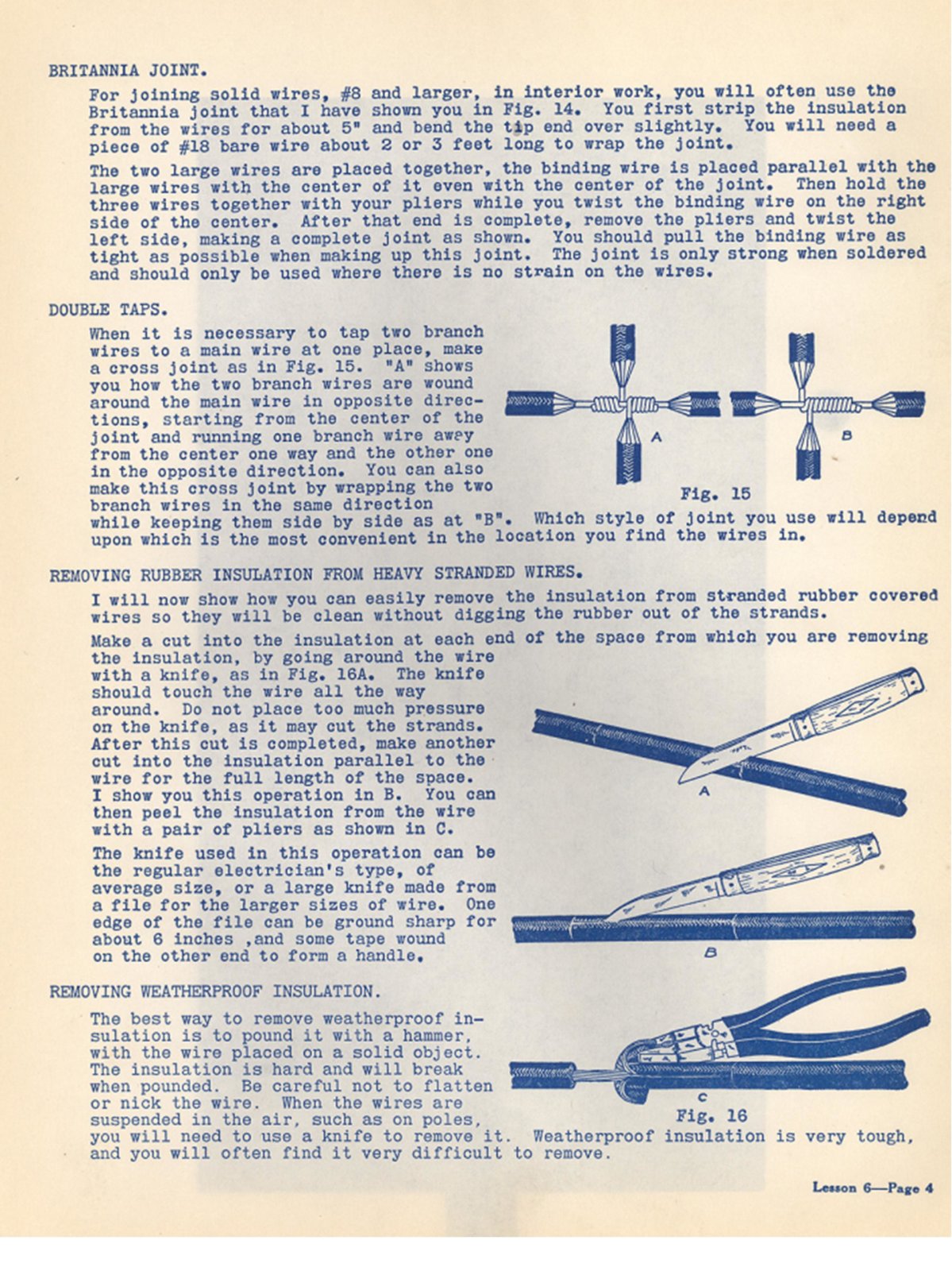

Better would be soldering, although with 6mm cables it would need to be done with a gas flame, so not necessarily easier, and for some would be impossible.
No need for a gas flame. A decent soldering iron of around 75 watts will do it.

Don't forget that solder's sole function is electrical - it must not be used in any attempt to provide mechanical strength to the joint.

Strictly speaking, the joint should be both mechanically and electrically sound before soldering.
The solder protects against oxidising.
Solder wouldn't hold pipes if they weren't overlapping, but merely butted against each other.

I agree that the joint should be both electrically and mechanically sound before soldering, but I think the solder is there to do more than just protect against oxidation - it is meant to maintain the mechanical integrity of the joint. The primary 'mechanical' joint has to be created by some sort of twisting/'knotting'/plaiting (or some combination thereof), and hence could therefore probably quite easily 'pull apart' in the absence of the (mechanical) presence of the solder.
Noting your "quite easily" I would say that is, therefore, not mechanically sound.

Well, forgeting the "quite easily" (which is obviously a matter of opinion, if the mechanical joint is (I would think necessarily) based on twisting/knotting/plaiting/splicing etc. (if more than that, it would not really be a 'soldered joint'), then a sufficiently firm 'tug' would pull it apart - in practice, probably a tug no 'firmer' (actually probably 'less firm') than would be necessary to pull a conductor out of a properly-tightened screwed terminal (in the absence of adequate strain relief).
