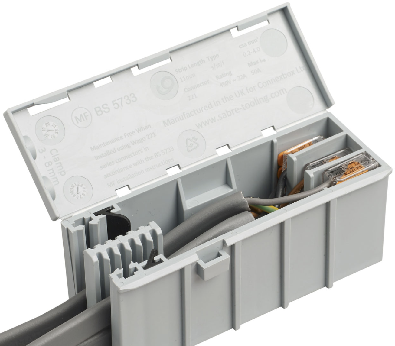

So I've removed a redundant spur cable from a ring main, and am left with the old skool round junction box under the floorboards now just joining the main circuit cable.
I can't (without far too much moving furniture and lifting floors) get at the other ends of the cables to replace the run with one unbroken length so a joint will have to remain.
Figured I'd replace the old round JB with something more 21st century, as "accessibility" will mean lifting the corner of a fitted carpet and unscrewing a "trap-door" section of floorboards. As an aside, the old JB screw terminals were still as tight as could be, and it has to have been there for decades (just lying there, not screwed down).
So, time to vote - I've got these choices.
Wago-type box fixed to a joist, with lever connectors
Ditto with push-fit connectors
Butt crimps (ratchet crimper), staggered, individually heat-shrink wrapped, or use of crimps with built in adhesive and heat-shrink. Then the whole area heat-shrink wrapped over the top. I know opinions vary re crimping solid wire.
Inline push-fit splices staggered, individually heat-shrink wrapped. Then the whole area heat-shrink wrapped over the top.
Choice is a wonderful thing - back in the day you had round JBs or those strips of connectors where you cut off as many as you needed, and that was it.
I was going to have "twist the ends together and wrap in insulation tape" as a joke, but somebody would have voted for it....
