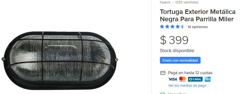

  14. Daddy Manky
    Daddy Manky
    Joined:
    26 Aug 2020
    Messages:
    13
    Thanks Received:
    Country:
    @john,
    Prefer it to be inside.
    Argentinians appear to use some kind of Bulkhead lamp like this, but they must have a fireproof spec.
  15. JohnW2
    JohnW2
    Joined:
    28 Jan 2011
    Messages:
    46,211
    Thanks Received:
    2,970
    Location:
    Buckinghamshire
    Country:
    I think that bulkhead fittings like that often have Pyrex-type glass, so probably are pretty resistant to heat, but it's the wiring that is the main problem - which enters the fitting from behind and is presumably usually buried in whatever the fitting is attached to. Particularly if any of the cabl;e were even remotely 'exposes, I think you would be very hard-pressed to find any cable that could safely cope with the potential temperatures (and even potential flames) in your proposed application.
    At the very very least, I would think the only sort of approach you should even be considering probably should be to use, like fluoresence does, an Extra Low Voltage (e.g. 12V) light, since to have mains-voltage wiring (and fitting) in the situation you're talking about is, at least to my mind, quite frightening!
    Kind Regards, John
