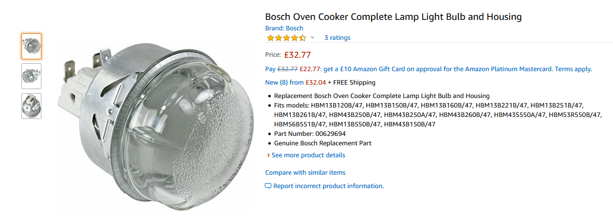

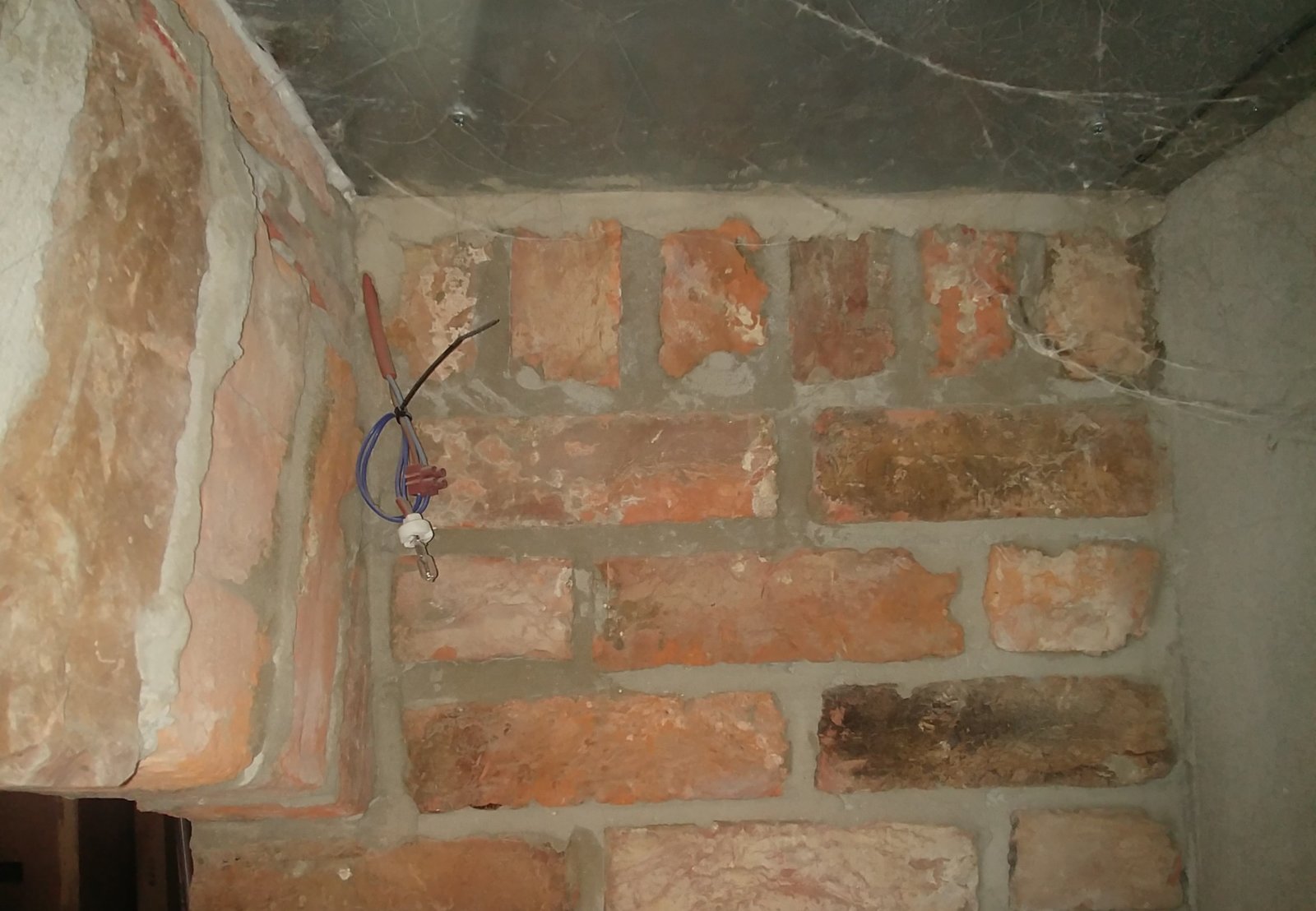

I am looking for a generic oven lamp housing to fit inside a chimney approx 1.2 meters above the grate.
All housings I can find are specific to a cooking oven and are made to fit into a molded space in the oven lining.
I want something I can surface mount inside the brick chimney.
Any ideas appreciated.

Depending on what sort of heat will be expected in the area you want to mount it, can you not get one that's made to fit a moulding in an oven wall and simply mount it into the lid of a surface box?
As I say, you will have to consider if it will be too hot for the mounting box first.

So if I buy this, what sort of "surface box" could I use to attach it?
Or could I just let it hang from the cable?

If I leave a couple of inches of heat resistant wire in chimney breast and attach the above lamp to it. Would it be OK to just leave lamp hanging from cable without seciring it? Fire is over 1M below.

I'd suggest any lighting above a stove should be supplied from a (remote) 12v selv transformer. In that case you could just leave some lamps hanging. That's what I did, 2x 12v 10w lamps lights it up perfectly

Why do you want to put a light in a chimney? It’s just going to get covered in soot and other combustion products...

what temperature do you predict. Heat resistant cable is only about 80 degree, Tri rated about 90 degrees, you may need higher more specialist cable
