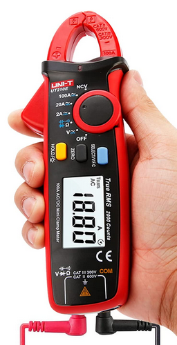

I blamed spikes on the supply, for many of my RCD trips, as could not find any leakage testing with an insulation tester, I do intend to buy one of these
![1661496980560.png 1661496980560.png](https://cdn.diynot.com/data/attachments/277/277862-8fbe316432506ea10b179394e2adff10.jpg)
which on the 2 amp AC range will show 1 mA so can actually measure the leakage, but even this cheap model costs around £40, the same with one of these
![1661497188840.png 1661497188840.png](https://cdn.diynot.com/data/attachments/277/277864-b507632569b87ce66ffb9405330470cc.jpg)
at £32 even the cheap testers cost a lot of money, lucky I have a couple of insulation testers, but without them the DIY guy is unlikely to find the fault. And even with an insulation tester I failed to find out why my RCD would every so often trip, so on moving I went all RCBO's. Not sure that helps, as when they do trip no idea if due to overload or earth leakage.

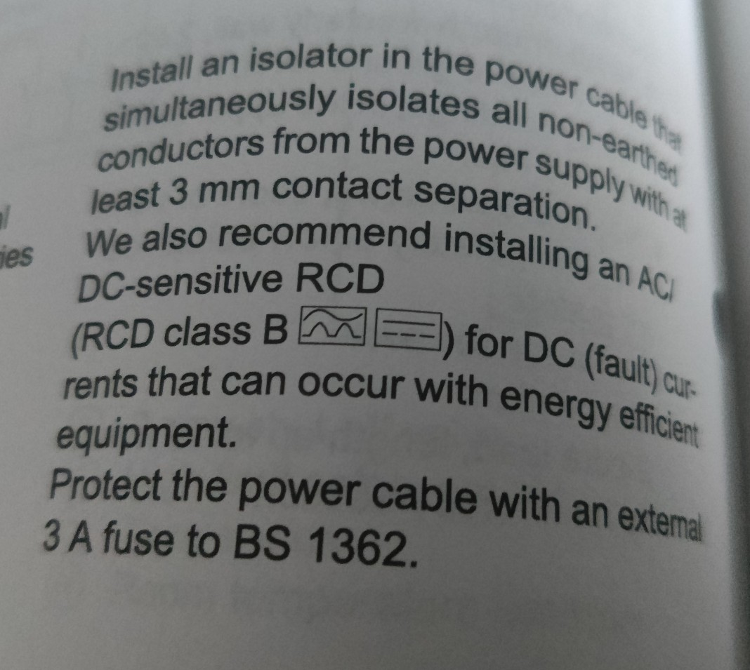

On another site some one posted this
![1661499278717.png 1661499278717.png](https://cdn.diynot.com/data/attachments/277/277869-a5b390d3e0da4928f27d15d80517c8ac.jpg)
set of instructions for a boiler, first time I have seen type B RCD recommended for a boiler, seems it is a "Veissman, vitodens 100-w" but with my make of consumer unit I could not fit a type B even if I wanted to, can't get single module width RCBO's type B although they did say type B on the packet, but turned out to be curve B type AC.
I am not convinced that type AC will fail to trip, and that 6 mA detectors for DC are really required, however it is clear the RCD's on the market today are very different to those of 1992 when I first fitted them, and we have no idea of the age of the RCD in question, or what faults if any the oven has.
