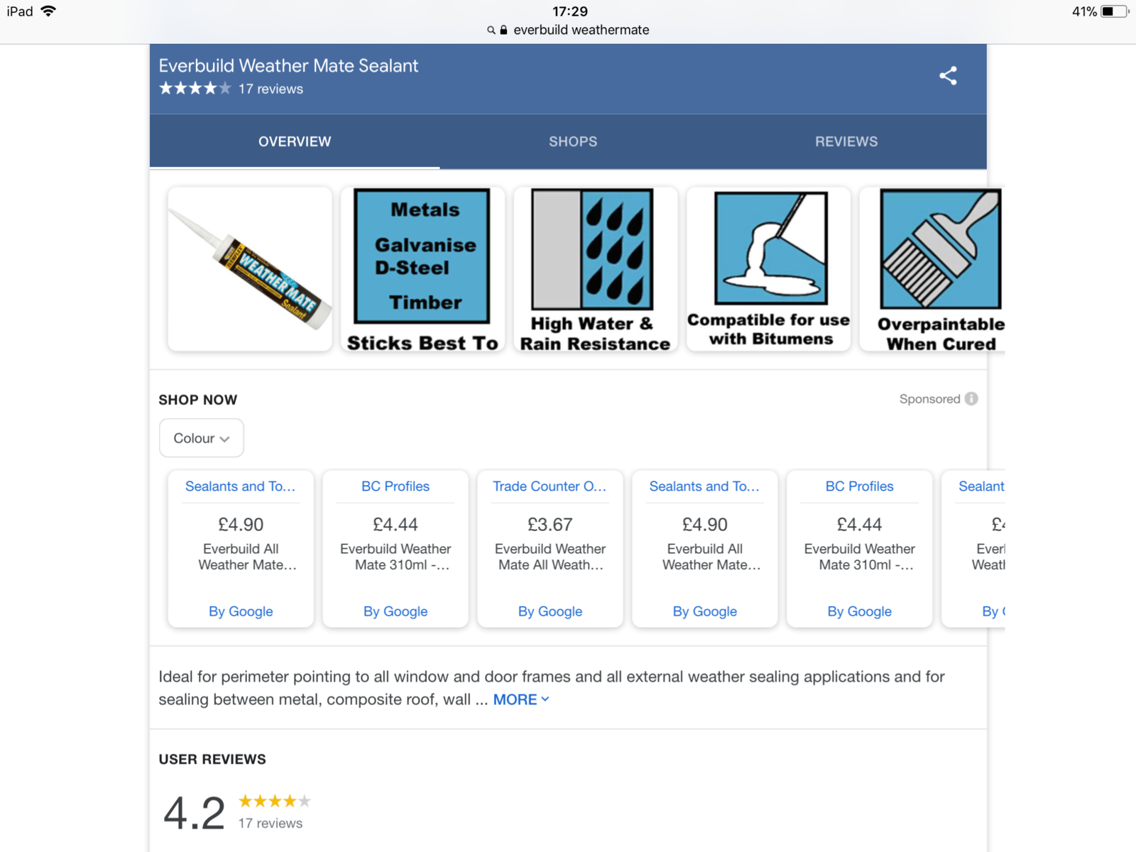

Not a recommendation but Ive used weather mate externally around some frames and paint sticks to it.
As said paint in a shower aint going to work!!
