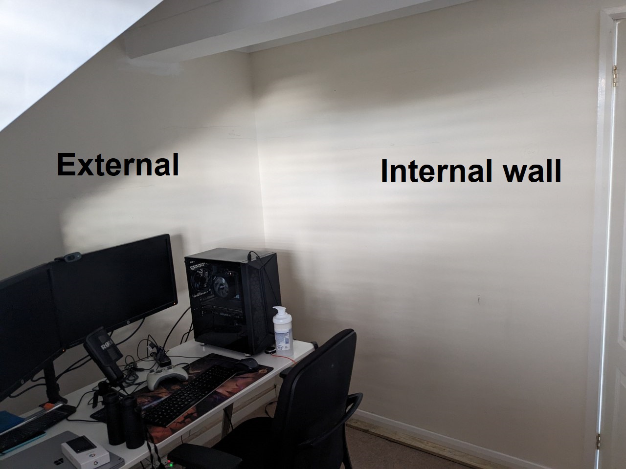

Hello,
I might be unnecessarily worrying about this, but no experience with how much hanging weight walls can hold. No harm asking.
We want to install reclaimed palette wood across two walls to make them a feature. The room is on the first floor. The boards would be nailed to vertical battens screwed into the wall.
The material of the walls is brick / blockwork (don't know which for sure - whatever was most common in the 1960s). One is an external wall, the other is internal
I've worked out approximately the wood would add 40 kg to the side of each wall (spread out across the entire surface).
Should I be concerned?
Cheers.

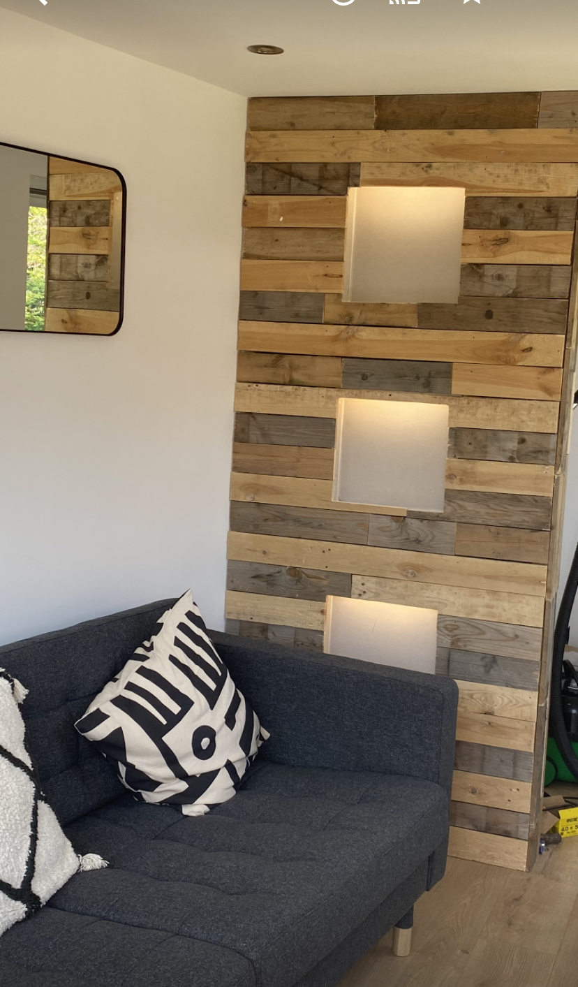

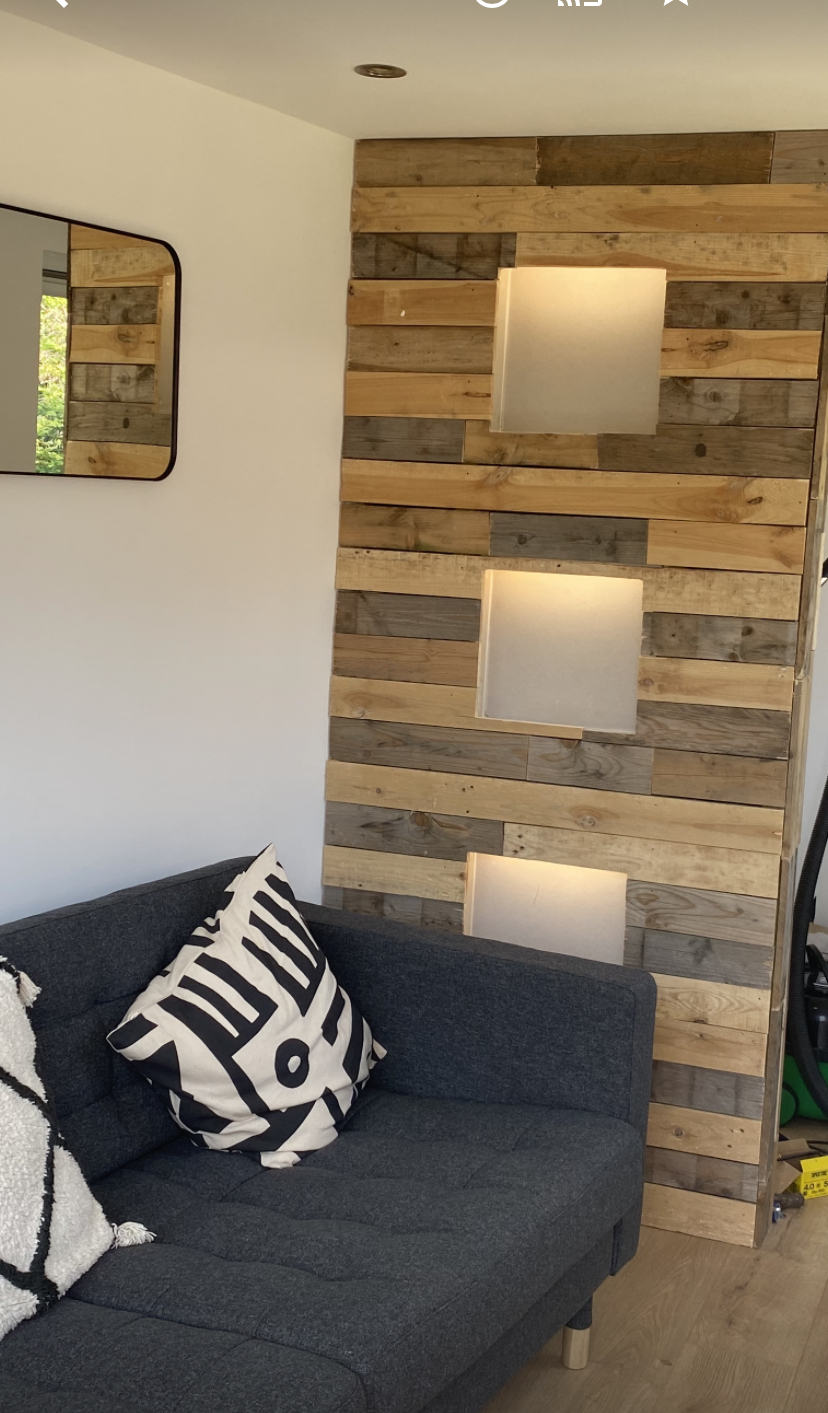

Seen it done.
Some radiators are heavier
Much smaller area obviously but did this last year and it hardly weighs anything per m2. Dry pallet wood is pretty light.

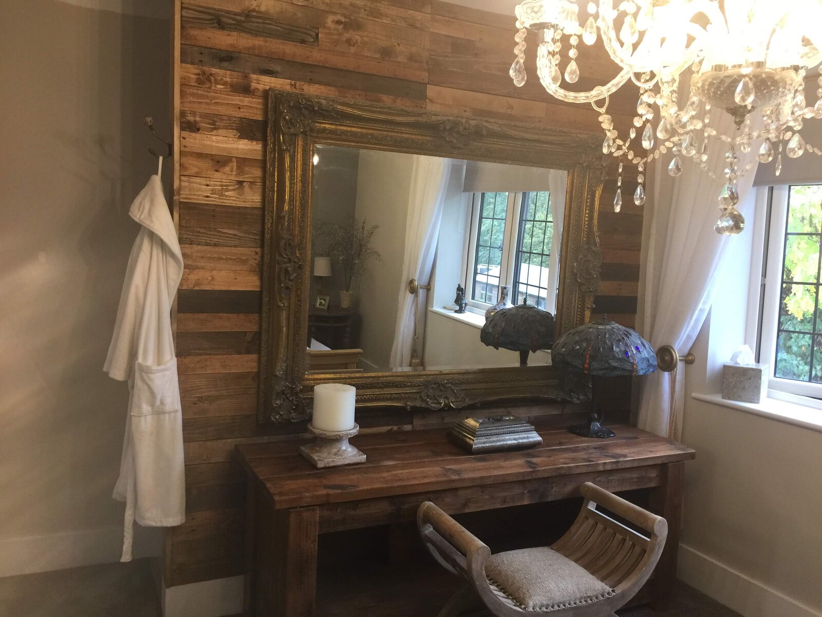

The weight is less than adding another sheet of plasterboard , I planed , sanded and stained mine and finishing with danish oil .Just pinned to studs.
