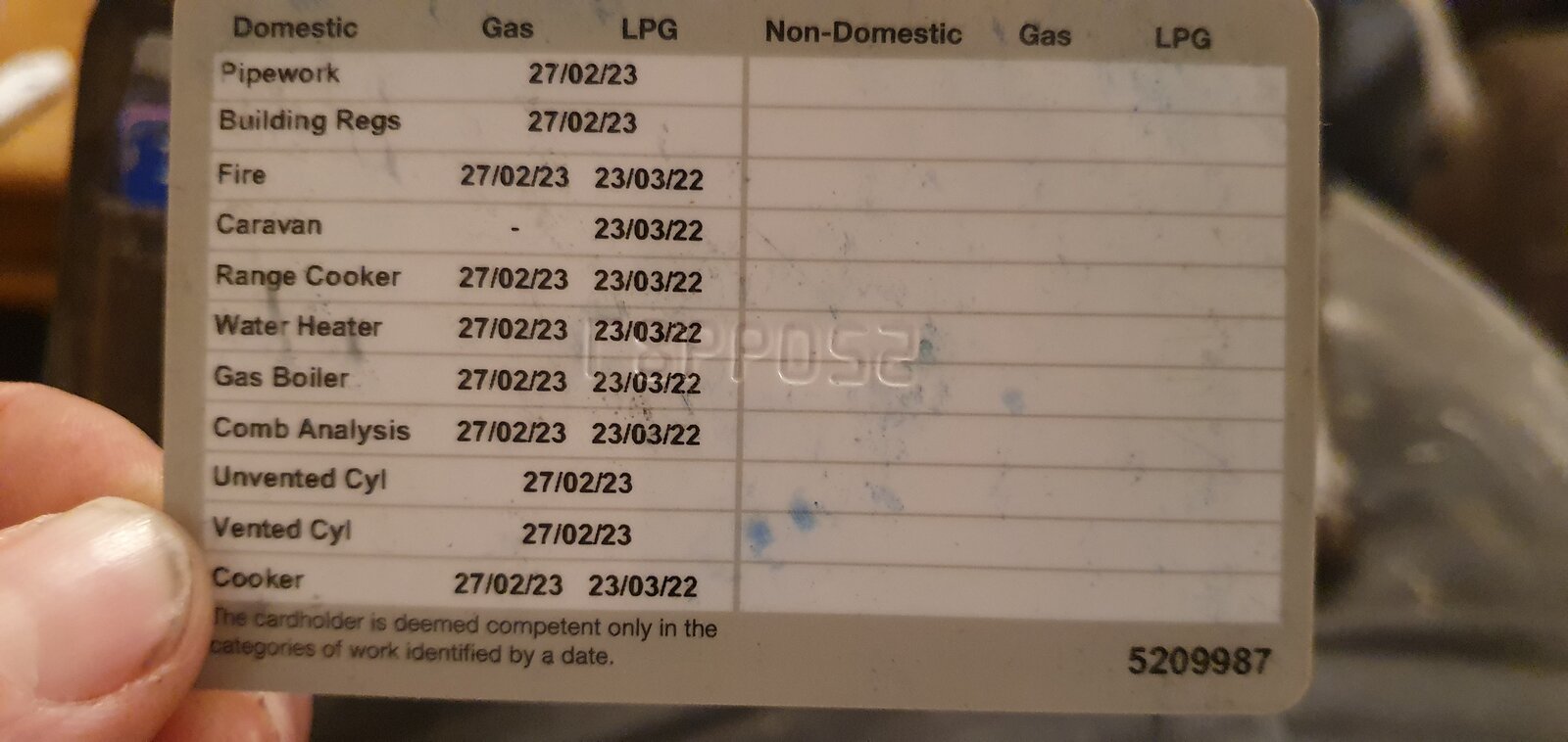

That is normal , that is when his gas safe membership is valid, not when individual categories are valid, why are you so reluctant to call Gas Safe ? one phone call will give you all the answers, on the back of the engineers card there is an expiery date next to each category, the only time that date chages is if the individual category expires before the gas safe membership expires

If his ID issued in March doesn't show LPG then he can't have been LPG registered a couple of weeks ago either. Mine looks like this (it shows LPG expiry in March this year because it did and they didn't send me a new card when I renewed my qualifications. The GS website is up to date though).
As others have said, the best way to be absolutely sure is to contact Gas Safe on 0800 408 5500. If they confirm that John Smith isn't and wasn't LPG Registered then you should report him here https://www.gassaferegister.co.uk/g...-suspect-gas-work/report-illegal-gas-workers/
They will be interested in knowing both that he is working illegally himself, and that he is illegally signing off other people's work

Yup, they're at it and trying to waffle their way out of it. Luckily they can't. As suggested, if his licence is still in date then LPG would still be on it, it would just have the date of when the LPG stuff expired, being the said 'couple of weeks ago'.
Deffo Gas Safe time.
