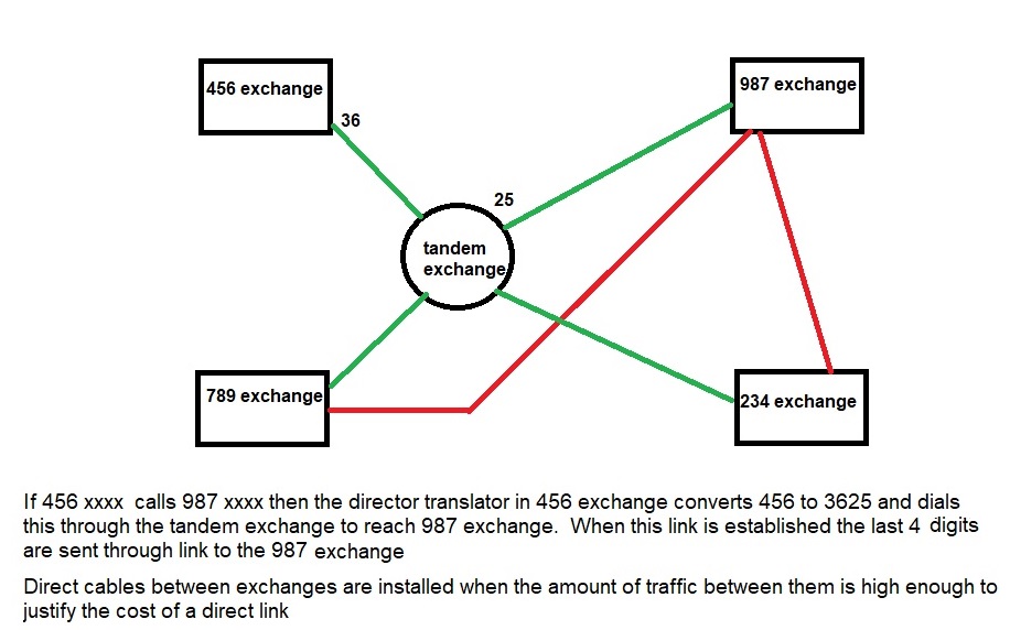

The way the London network interconnected exchanges in the days of electro-mechanical exchanges was complicated by the need to reduce cable. This involved tandem exchanges which provided interconnection between other exchanges.
The translations were made using electro-mechanical equipment which require a lot of re-wiring if a routing code had to be altered for any reason.
To go from 01 xxx yyyy to 020 pxxx yyyy in one single step was impossible due to the amount of reprogramming of the translators required. Translators on routes between exchanges across the country and London would need to be changed at the same time.
