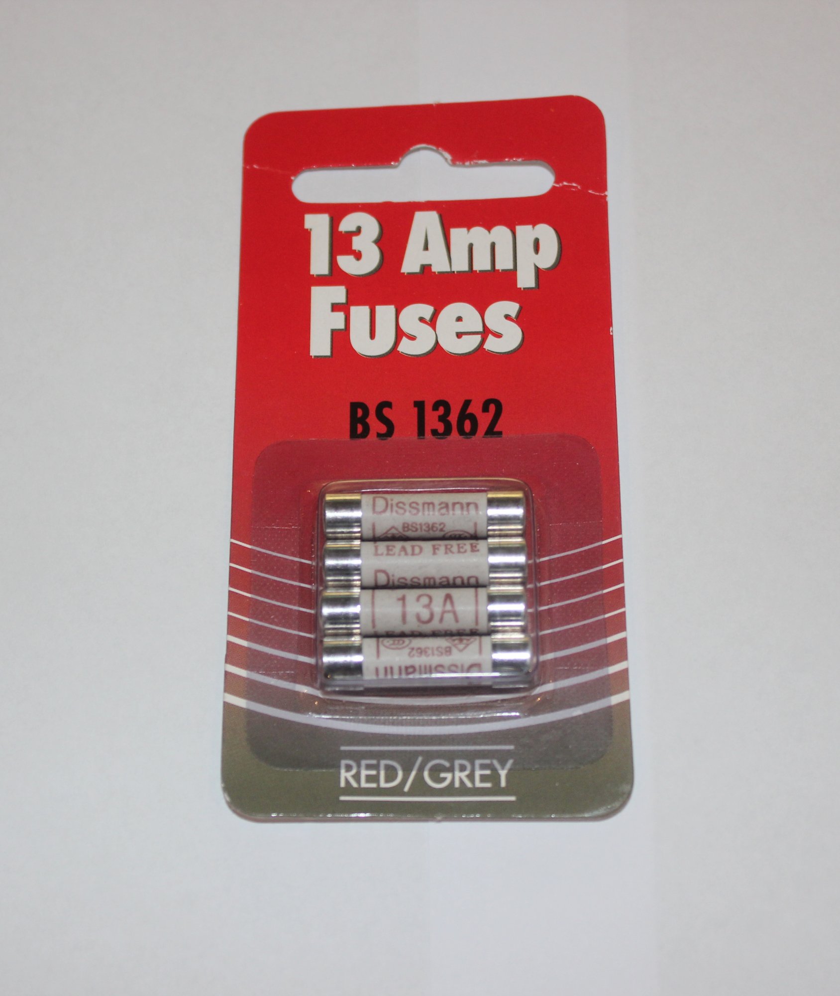

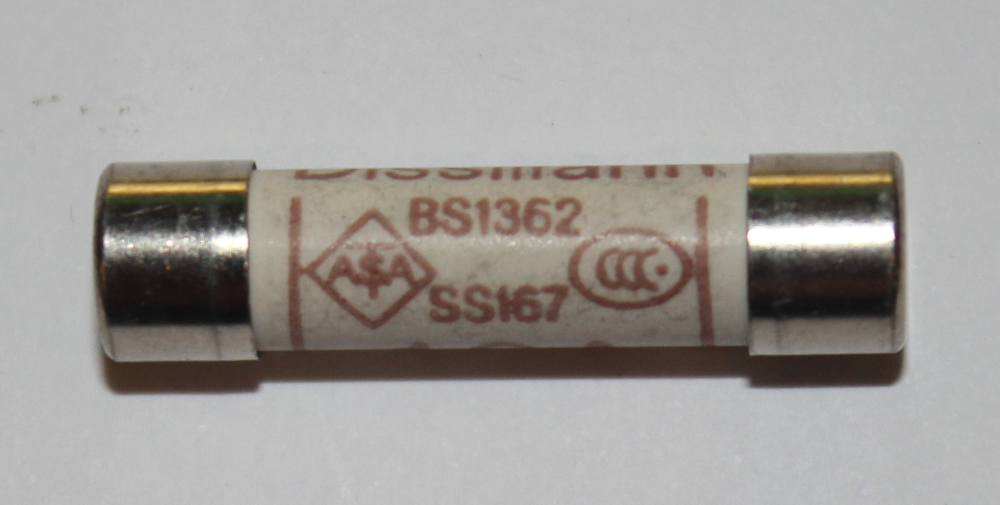

Picked these up at a local corner shop. Never heard of Dissmann, but I guess there's many makers of compliant (and certainly not compliant) BS1362 fuses. What's your opinion on the Fuses below?
Possible knock-off clone of Bussmann fuses?
Regards: Elliott.

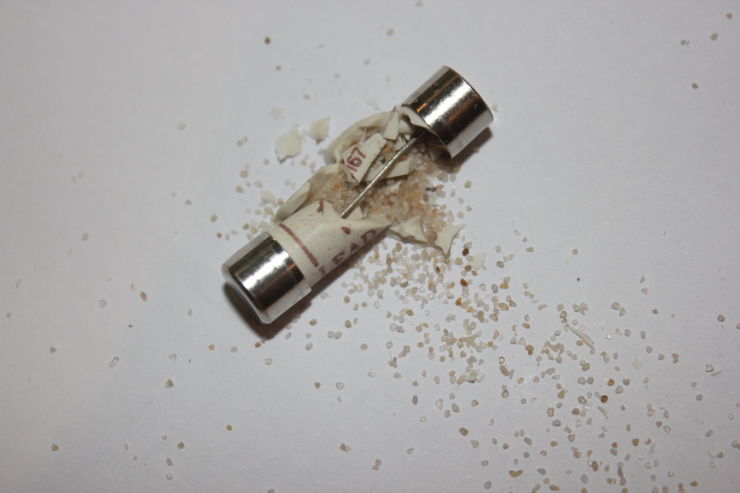

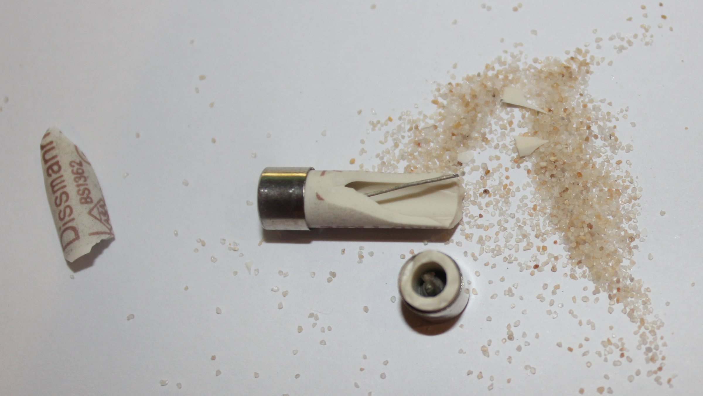

The fact you had to smash it to get it apart and the fact there's silica inside bodes well.
A google for Dissman fuses however, does not

Found this as well: http://www.redgrey.com/images/redgrey-catalogue-aug-2015.pdf (See Page 8 - Picture 5.3)
it is only a knockoff of a Bussmann product if it is carrying the Bussmann

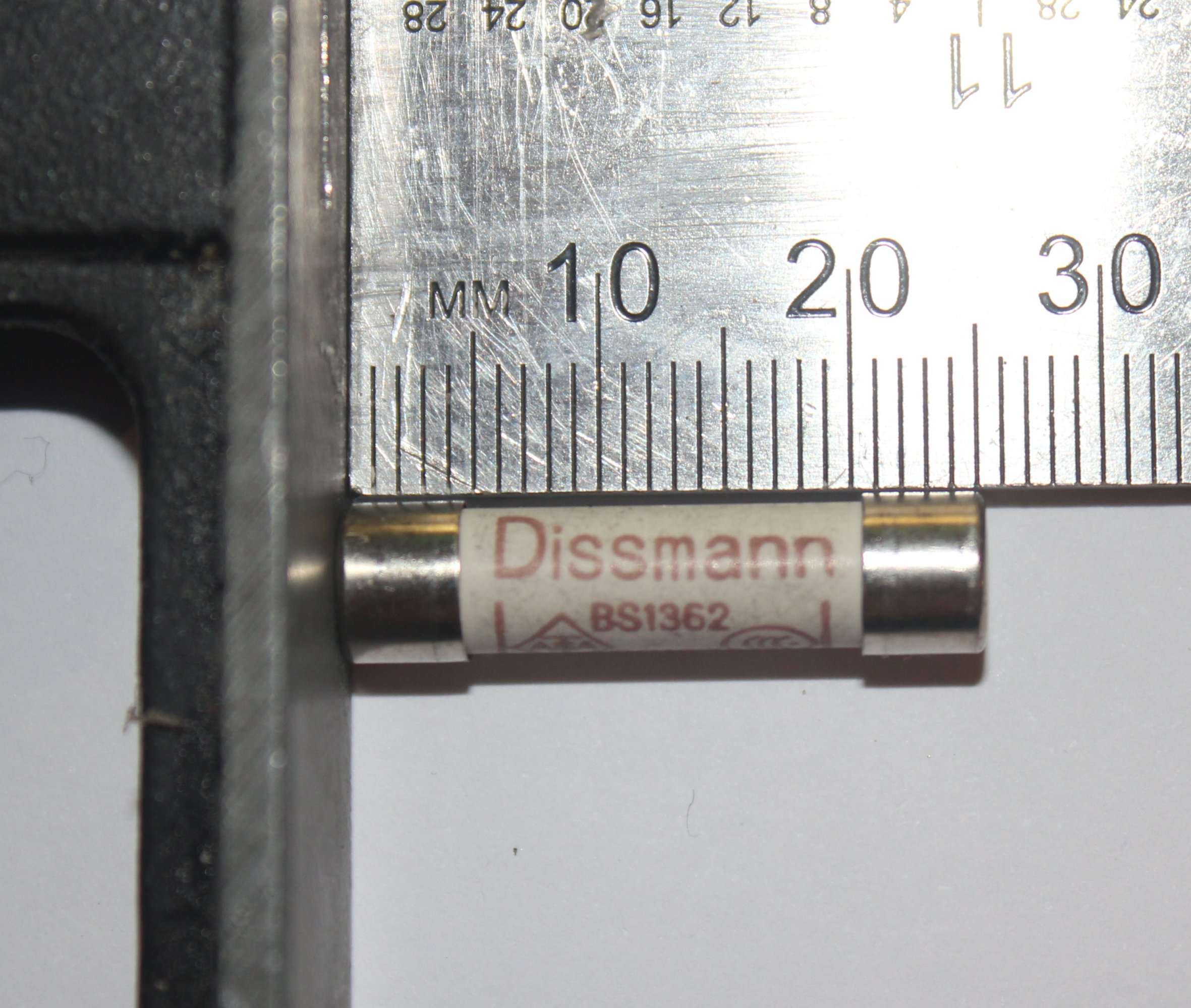

Edit: Just measured the diameter of the fuse wire with my micrometer and it's 0.38mm.
