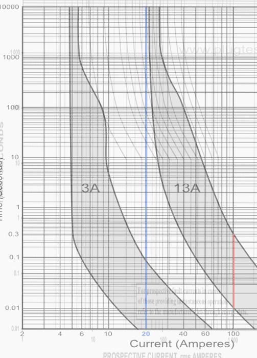

Since it seems that it takes at least ~22A to blow a 13A BS1362 fuse (ever), one might guess that it would probably take around 34A to blow a "20A" one. That means that at well as being illegal (and potentially dangerous in a BS1363 plug or FCU), they would be a bit daft, given that they would normally be connected to a circuit with an OPD no greater than 32A (which would require around 36A to operate).

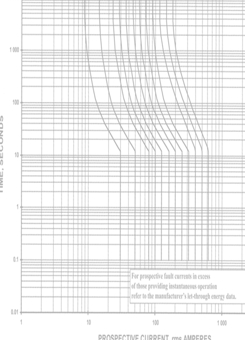

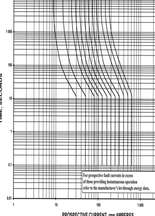

I think we have all seen the problems with mixing fuses and trips, and even different types of fuse, the problem as pointed out is we want a fuse to rupture in a plug faster than the trip will operate, we can overlay the charts and compare the times, but that means the fuse has to follow what the chart shows, and with fuses made in China there is a good chance they will not follow the charts.
If you try lining up the fuse and the MCB B type you will see even a 13A fuse until over load is down to around double it's rating is unlikely to go before the B32 trip. With a 16A trip it is unlikely the fuse will ever rupture. However I have had 13A fuses fail so it would seem in real life they do not follow the charts. 16 amp third line 32 amp sixth line. The charts don't quite line up, assume one must use a log scale, but good enough to see the problem mixing fuses and MCB's.

... even a 13A fuse until over load is down to around double it's rating is unlikely to go before the B32 trip.
I think that might be going a bit far but, as I said, the curve indicates that a 13A BS1362 should not (ever) blow with a current less than about 22A.
Do you mean under overload or (negligible impedance) fault conditions? In the latter case, the fault current will be so much higher than either 16A or 13A that either the fuse or the MCB would, alone, operate extremely quickly - so, if one has both, it's pot luck as to one, the other or both will operate. In the presence of faults (e.g. chopped through the hedge trimmer cable, more than once in my case!) I've certainly had a 13A BS1362 fuse, but not the circuit's B32 MCB, operate!
