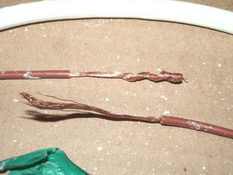

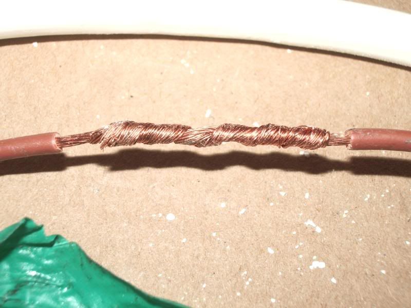

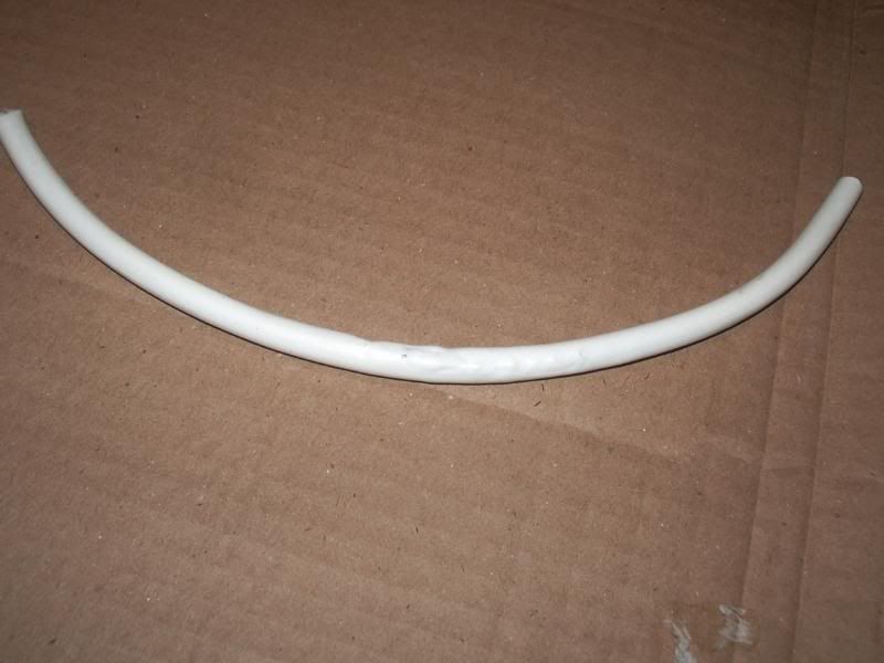

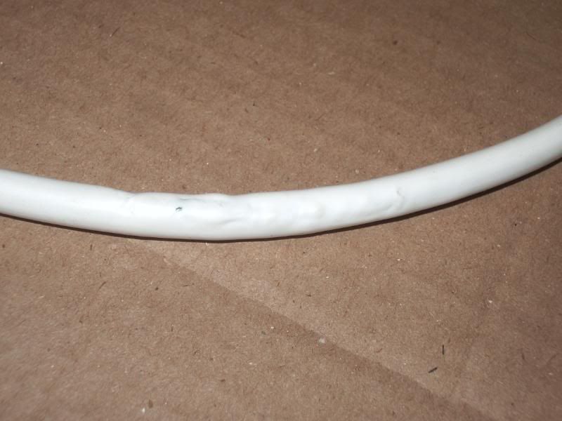

I was installing some 2 core 1.0mm² flex this week, and noticed a bumpy bit on it.
Here is what I found:

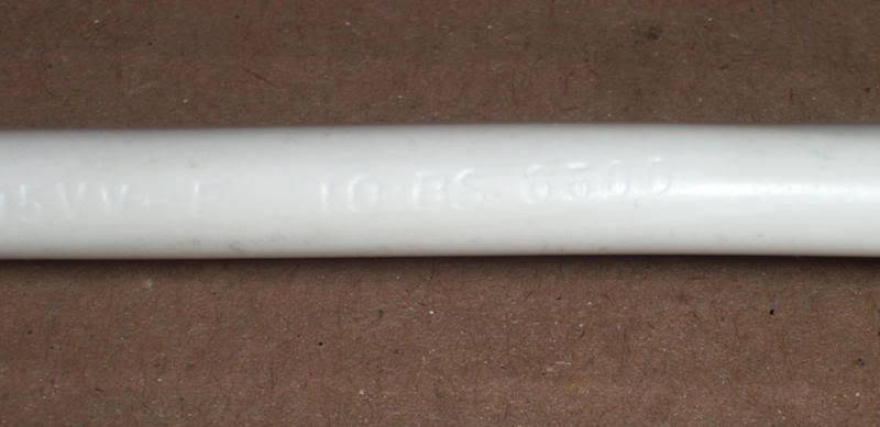

It is stamped "TO BS 6500"
The brand would lead you to beleive it is manufactured in South Yorkshire.
common practice, and not the first splice we've had posted on here..
it's the way they make the cable..so that there is a continuous feed through the extruder / dip / however they apply the outer sheath..
they generally mark and cut out the jointed bit but sometimes it escapes.... :)
oit pays to be vigilant as well because the other cores will be spliced somewhere nearby also..

Yes, I've seen it on Twin & Earth. The cores that time were not 'insulated' by tape. The problem would have been found by Inspection & Test if it was not for the beagle eye of an apprentice at the time!
there's probably better conduction through that joint than in the straight length of cable itself..
