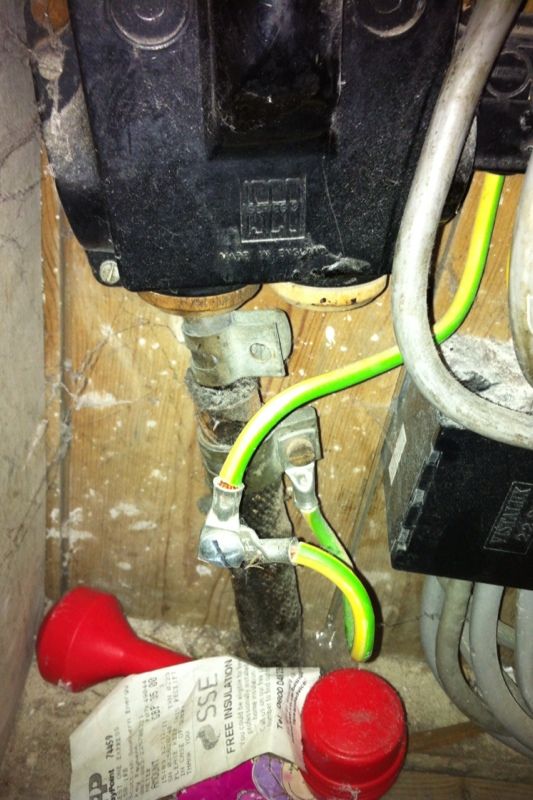

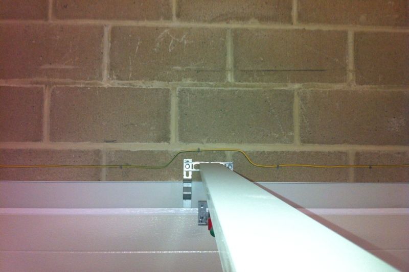

How to joint a main earthing conductor:

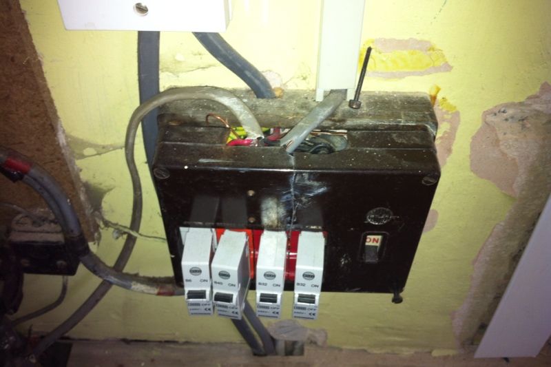

Overloaded wylex:

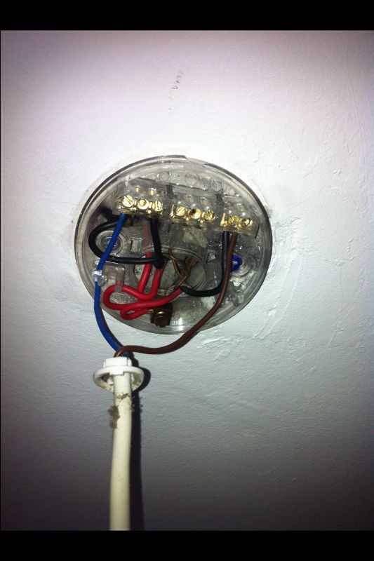

My smoke alarm doesn't seem to work...:

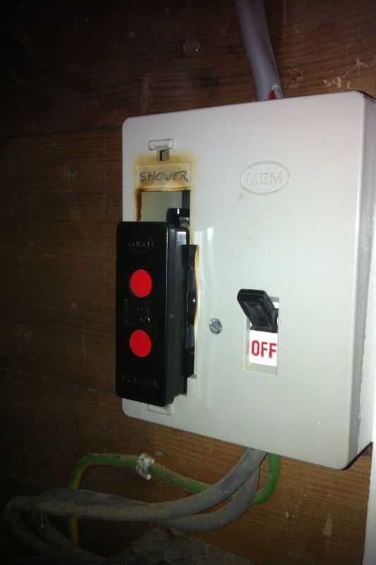

9.5kW shower:

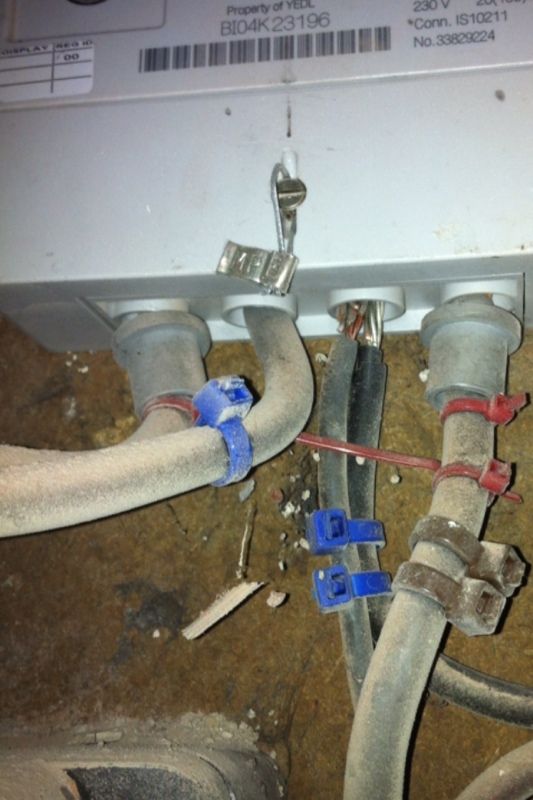

Electric Meter:

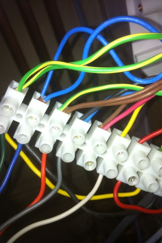

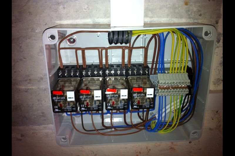

S plan plus heating joint box:

IIRC the greys were neutrals to stat positions, but the stats were digital, and the black is a spare from the heating joint box upstairs.
The earth connection is directly onto the armours of the cable not on the lead sheath. Pretty rubbish IMHO.
