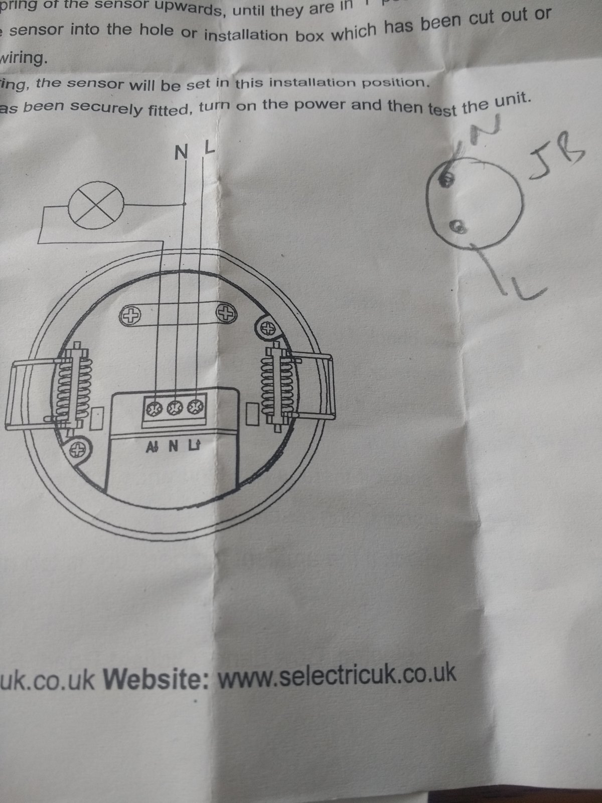

Hi, could someone help me with this?
I have a junction box with L and N, 2 or 3 core cable available, my lamp is a 12v spotlight with L and N wires coming from the transformer.
Proper idiots guide needed!!
Thanks.
1. That L in your junction box.. It needs to be a permanent live. If it is feeding the transformer, then it is probably a switched live, which is no good for the PIR. The PIR needs a permananent live and neutral. These will be up in the ceiling, somewhere. You may need a test meter to confirm you have the right connections.
2. That circle with the cross in it. Thats your light and transformer. the transformer wires go between the A√ and N wires

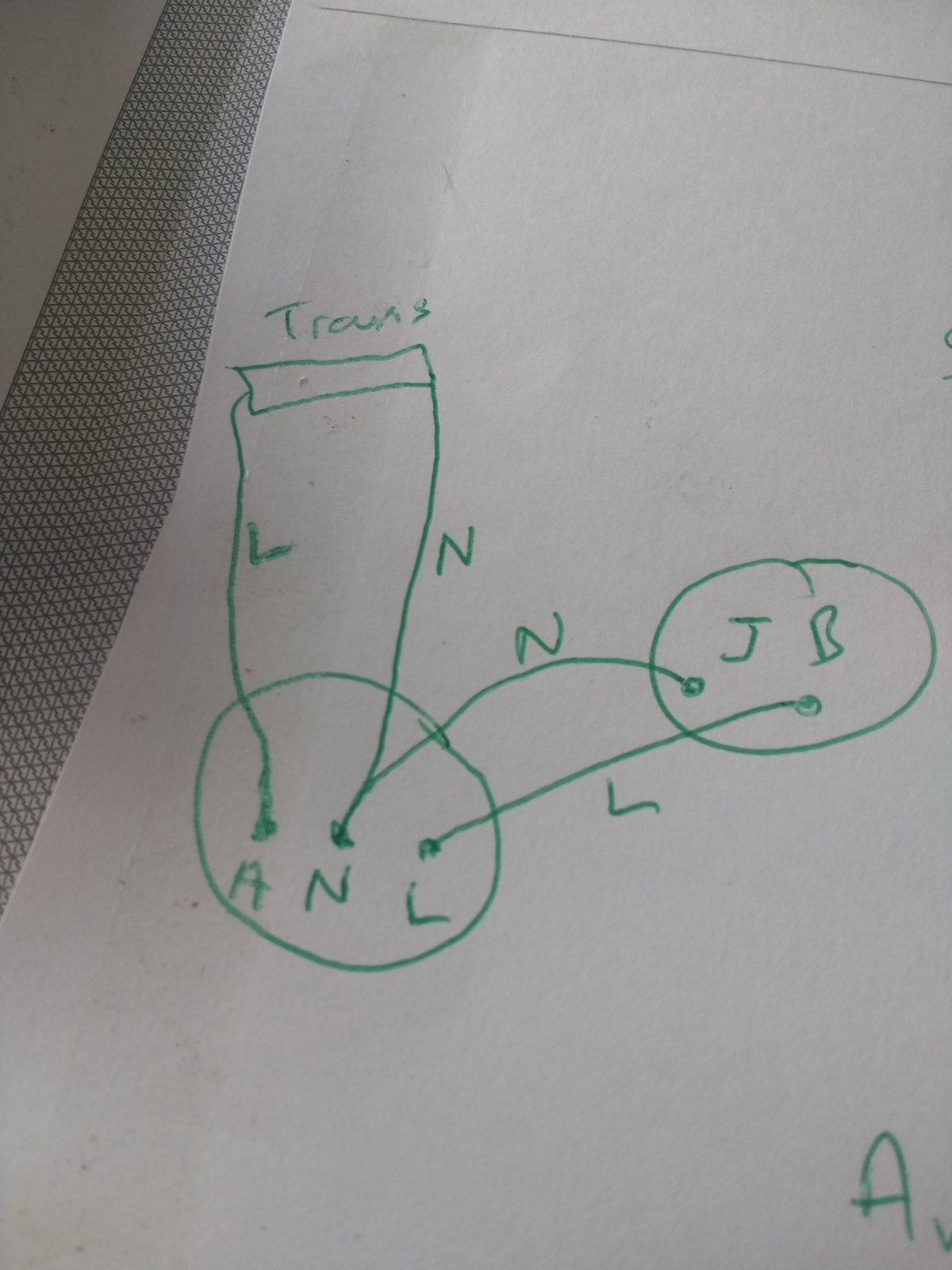

Thanks. It's permanent live in the JB - fed from an adjacent fitting, I've disconnected the existing switch circuit and the light transformer to make it easier for me! So is it just:
Permanent live from JB to L on sensor, Neutral from JB to N on sensor and N on transformer and connect A from sensor to L on transformer?
Thanks that's great, all connected and it works!! Really appreciated.

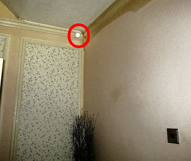

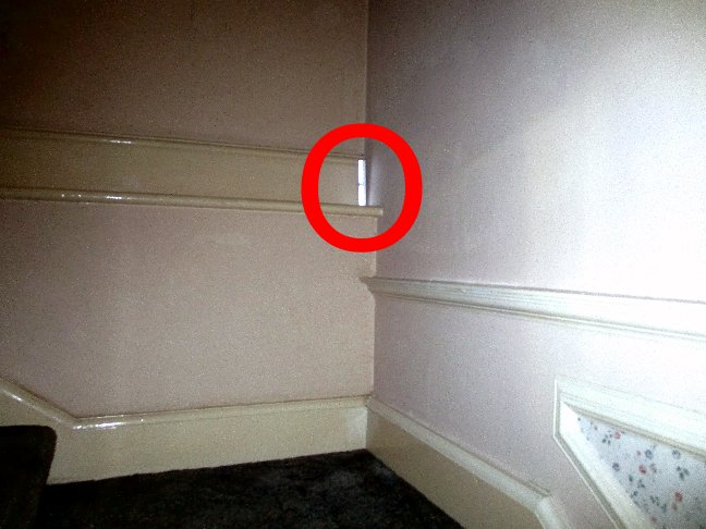

It is partly an experiment! The situation I have is a room within a room within a room - WC at the end of a utility "cupboard" within the dining room (we will be removing doorway 1 in the future but at the moment it's 3 lights to turn on and off to use the WC) now reduced to 2.
I will feedback how it works in practice and have left the old switch and cable in place!
