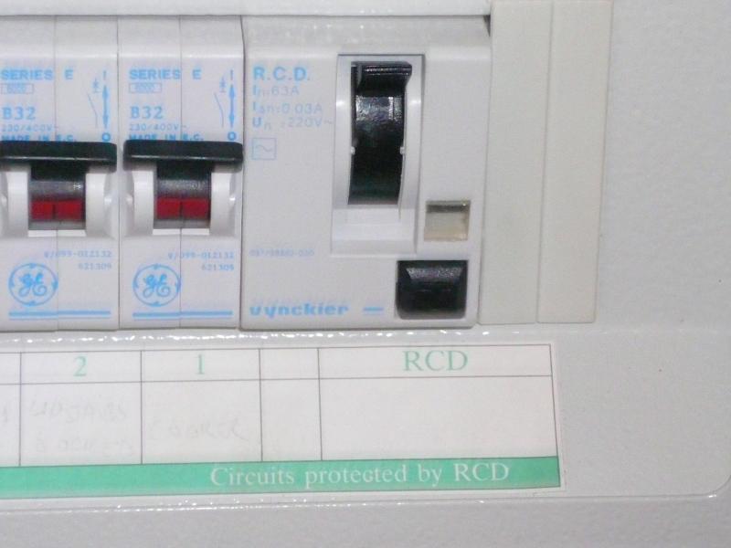

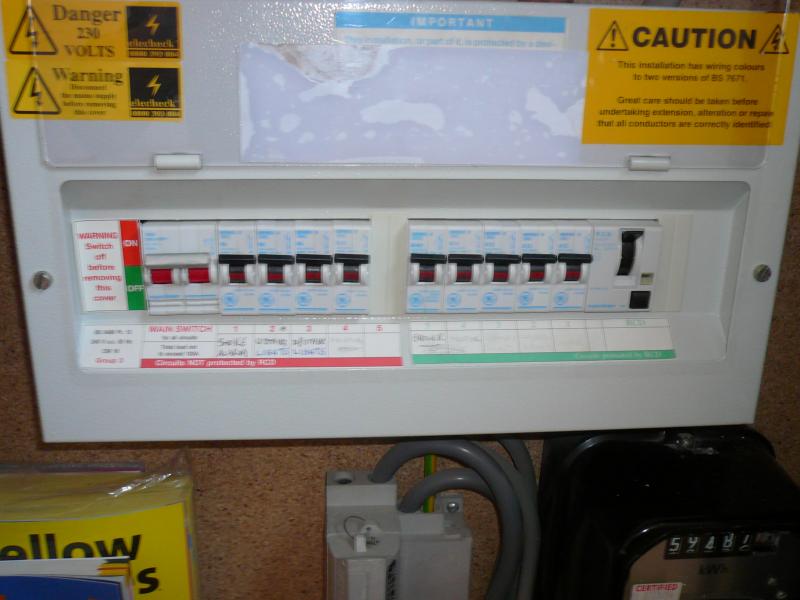

Had a PIR done on my house today and electrician reports that the RCD is not working. CU is approximately !8 years old. He phoned a few wholesalers who advised it would be difficult to find a replacement RCD.
CU - GE CM 16 Group 3
RCD - Vynckier 63A 30mA
Any help locating one or suggesting a suitable alternative would be appreciated.
Looking at that I would say TTC is right.
IIRC you may need to trim the prongs slightly, but I forget which way round the swap was now.
Yes, you need the GE one per my link above.
It was GE then they badged it as Vyknier then it went back to GE, I think...
Anyways, its the same kit so you should be fine.
Make sure the power is completely off. Use the safe isolation procedure if you are doing it yourself. And test the RCD per my post above.
TTC, thank you for your help identifying the part needed. I will now try and source it locally. The electrician who carried out the PIR will return to install and test.
You'll need an electrical distributor but not many keep in stock GE. You'll be better off with Toolstation. Next day delivery...
Rexel Senate used to sell GE stuff badged as Sector, they should be able to get hold of one for you. (Mention "Sector GE" - I think the Sector stuff now is Volex)
Part bought from Toolstation, now fitted and tested.
TTC - You're a star :D
I have a similar problem with my RCD. My consumer unit & RCD looks exactly like your pic - I'm in Cumbernauld and house is approx 19 years old.
I'd be grateful if you can you give me the part number from Toolstation that fitted as a direct replacement
