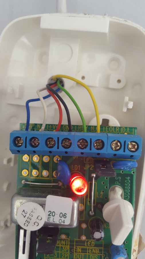

Guys, just changing a PIR and a bit confused over what goes where on the new pir... ok the old one and the alarm was working fine but the pir was old and discoloured so I take it off and ready to fit the new one..tamper swith sets off alarm but reset ok ,,,here is the wiring termination on the old one left to right
1 says t amp ........BLUE wire
2 says N.C............WHITE wire
3 says +vin ..........RED wire
4 says gnd.............BLACK wire
5 says rly..............GREEN wire
6 says N.C.............YELLOW wire

Take picture of old pir wiring and post,also what is the make of new pir.
You could have a wiring issue or you could have just blown fuse when changing pir.
Most fuses are 20 mm quick blow glass fuses,but the rating could be different.500ma ,1amp etc
This is the picture I took before removing it, not sure what the make is as it was fitted when I moved in ... the new make is Pyronix ME Q blue 12m PIR detector
Blue and white tamper pair
Green and yellow alarm pair
Red positive volts
Black negative o volts
Think you have blown fuse in control panel
Cheers guys........... yes the fuse had blown got a 1amp quick blow all ok now (y)(y)(y)
