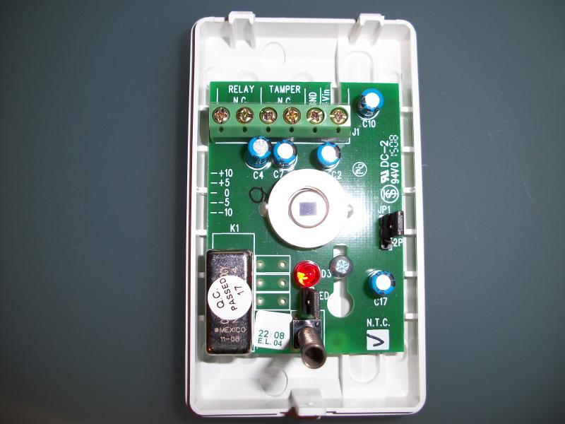

I need to replace a PIR but the terminals inside are not the same so I need some advice please.

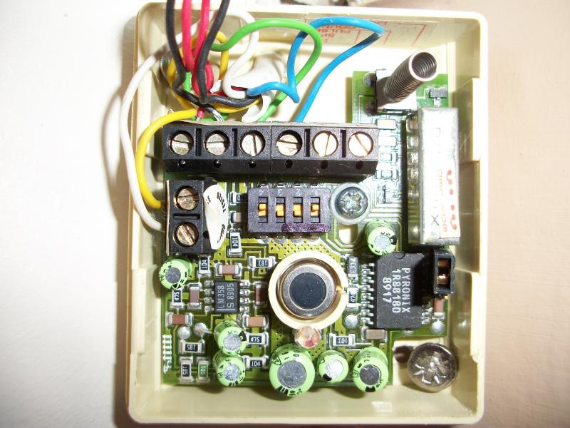

Second photo is the old one with 6 terminals across the top labelled +, -, C, N T, T and they are wired red, black,green, blue, empty, empty, then 2 terminals down the side not labelled but wired yellow above white.
First photo shows the new one with just 6 terminals across the top with the first 2 labelled Relay N.c, second 2 are Tamper N.C then gnd and +Vin.
So any advice please?
Thanks in advance
Chris
+Vn = Red
GND = Black
Tamper N = Green
Tamper C = Blue
Relay N = Yellow
Relay C = White
Dont short the red and black or you will need a new fuse.
