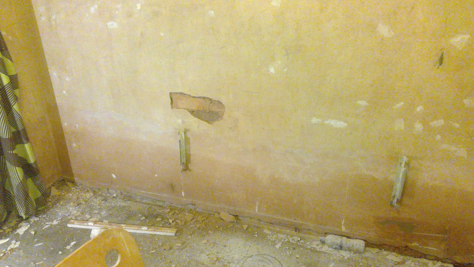

I have taken a picture of one of the (Edit: internal brick) walls, that was under the woodchip wallpaper.
At the bottom it has what looks like a cement level with a gypium finish, where the cement is the walls are damp. I've hacked that off in another corner and the bricks feel dry below.
Above that is the original plaster which breaks really easy and flakes if i dust it, with a finish which is rather damaged (i'm not sure of which type, doesn't seem like lime as its not that white, i'm assuming old gypsium?)
Now to my plan which i'm hoping to get a second opinion on from the research i have done.
Planning to hack off the hollow sounding areas and the cement areas. Replacing the backing with hardwall. Once that has set apply a layer of multifinish to the entire wall to smooth it all out.
Thoughts? Is this correct thing to go for?

Your method is fine if damp wasn’t involved. If a wall has previously had damp, you may need to apply further treatment/suitable plaster eg render/ dri coat to prevent hygroscopic salts showing after skimming
so your concerns are the walls in the room above the basement - a basement that previously had a dripping stop tap?
the wall in the pic shows what appear to be very clear indications of rising damp?
is that an outside wall?
there are signs that maybe its been treated previously for damp? what you call cement is probably a sand & cement render.
why not hack off all the plaster/render on that wall to about the height you've opened up? then post a pic.
can you also post a pic of the other side, the outside(?), of that wall at low level.

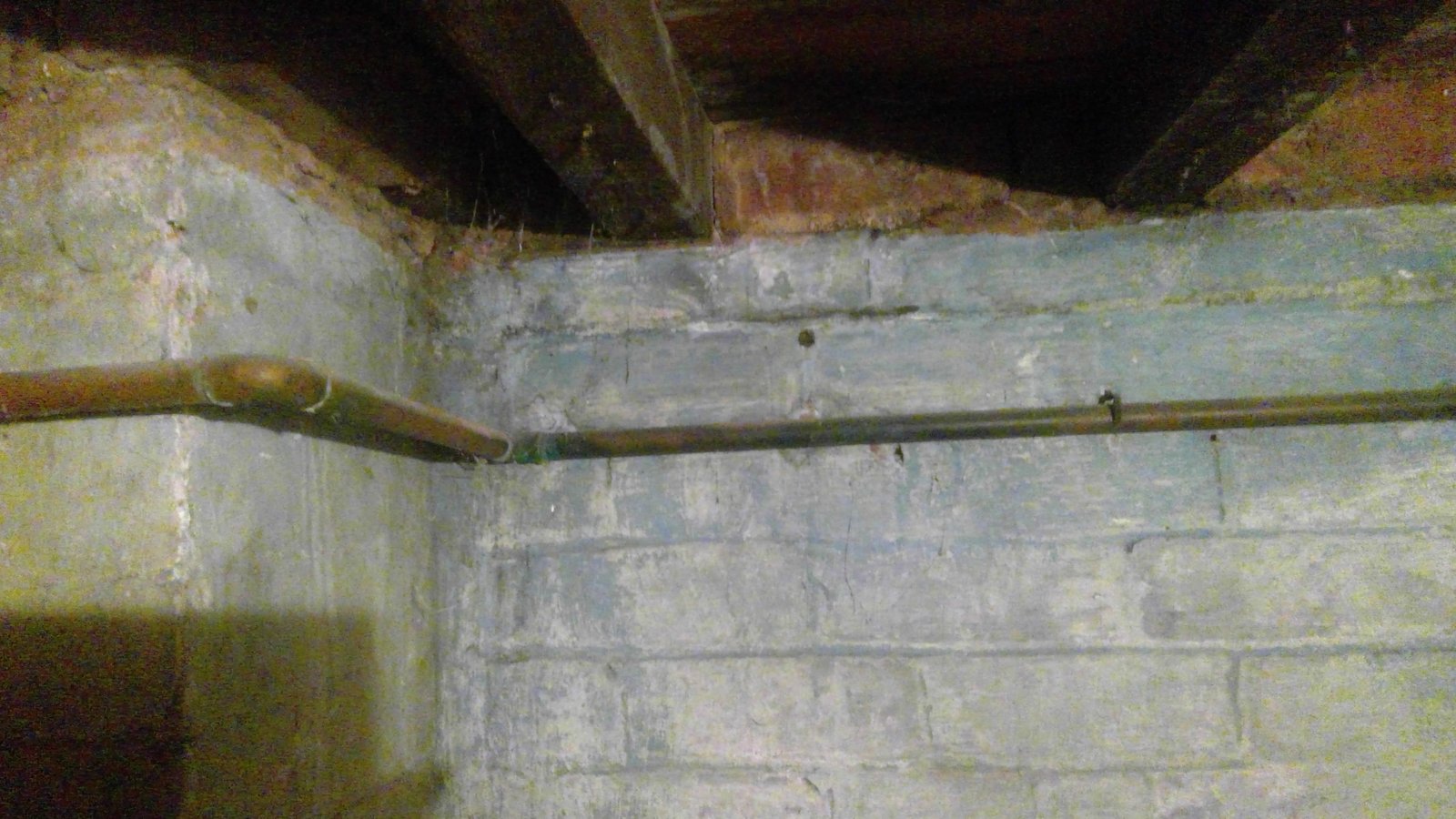

My neighbours have cellars. Attached picture in cellar.

the green on the cellar walls is an indication of damp/heavy condensation - is there adequate ventilation in the basement?
probe the joist tails as they go to seat in the wall - look for softness and rot.
