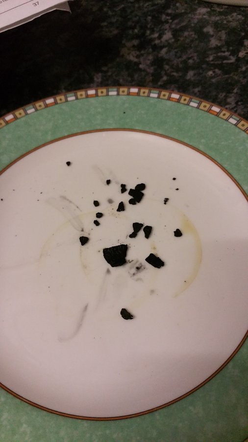

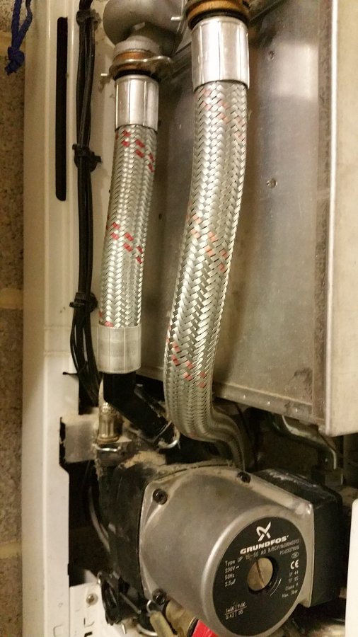

Well he fixed it :):):) The boiler was ok but he cleared a few bits out of it.
These two pipes were coked up very badly, it would appear the last plumber who previously looked at the problem moved these around to see if they we blocked and loosed the deposit thus blocking the valve they flowed into!!!
The deposits were like charcoal and took a lot of cleaning. There's cleaning products in now so should loosen up the remaining crud but bl00dy hell the system is like toast now, every rad is red hot, something we've not experienced for years and years.
