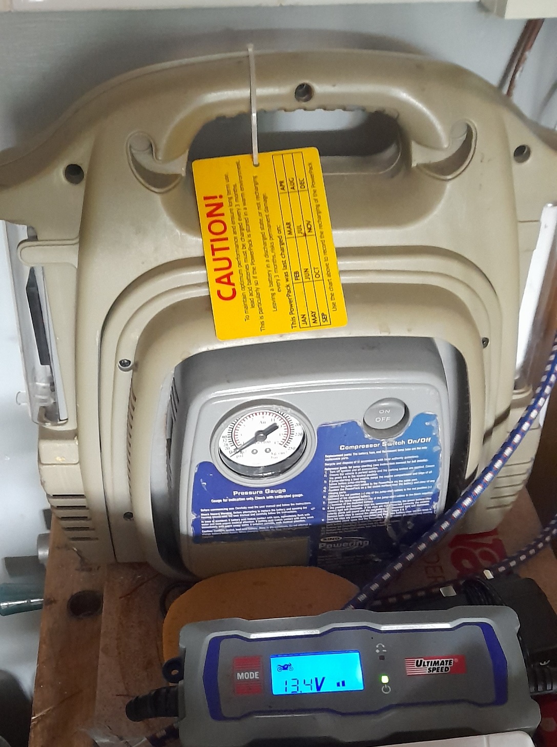

So the question is, what would you run from an EPS? We have just central heating and freezers, we have a spare socket, so an extension lead with an up-lighter would be quick and easy, but the old battery pack Battery pack and charger.jpg only 300 watt output, but it would run an up-lighter with a 12 watt bulb for 12 hours, so why run cables or mess around with EPS?
It could recharge from car or the spare 13 amps EPS socket, so how far do we go to give emergency light?

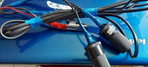

I have batteries removed from cars, not good enough to run a car any more, but will power a light, and a mobility scooter with 2 x 35 Ah lead acid batteries, so a simple lead, Emergancy power kit.jpg croc clips to cig lighter sockets, will charge phones with the car USB adaptor, and run anything which would work in the car.
