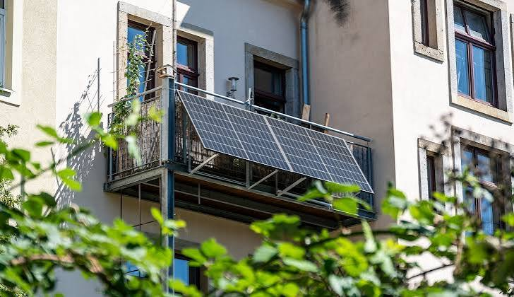

The Town and Country Planning (General Permitted Development) (England) (Amendment) Order 2026 comes into force on the same day as plug in solar becomes legal stopping it being fitted on wood, and detailing distances it can protrude from a building, I had assumed since it says (England) not valid in Wales, but reading it says "(3) This Order extends to England and Wales." So I suppose there must be a version in Welsh.
The order also covers all panels not only plug-in on how far they can stick out from the building. This
it seems may not be permitted any more due to how far it sticks out from the building.
And this
it seems not permitted from the 27th August this year.
