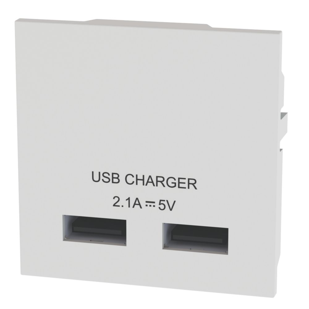

I need to plug in one of those USB plugs that has 5V output with 1.5A rating to operate a WiFi ceiling mounted PTZ camera. The only power source is above in the loft and it's a lighting circuit. I know running a socket of the lighting circuit is a no-no because of the limited load it can cope with. But seeing as what I am using it for is a single USB charger and if I label it will this be ok? I could also put a fuse socket with a 1A fuse maybe but wondering if 1A will blow considering the USB charger says 5V 1.5A
It is common to use a lighting supply when really we should not, for example to power a TV booster. However you should try your best to stop it being used for other items, a socket cover
can be locked off, so fit one on a USB socket and no one could in error use it. But is room for USB plug. But USB only would be better these
ae235
would do the job fine. With one of these what do you think.

Hi, MK electrical manufacture usb a 2g euro module which can be connected directly to you're lighting circuit. I would install a non switched 13a socket, marked 'lighting circuit' and be done with it !
