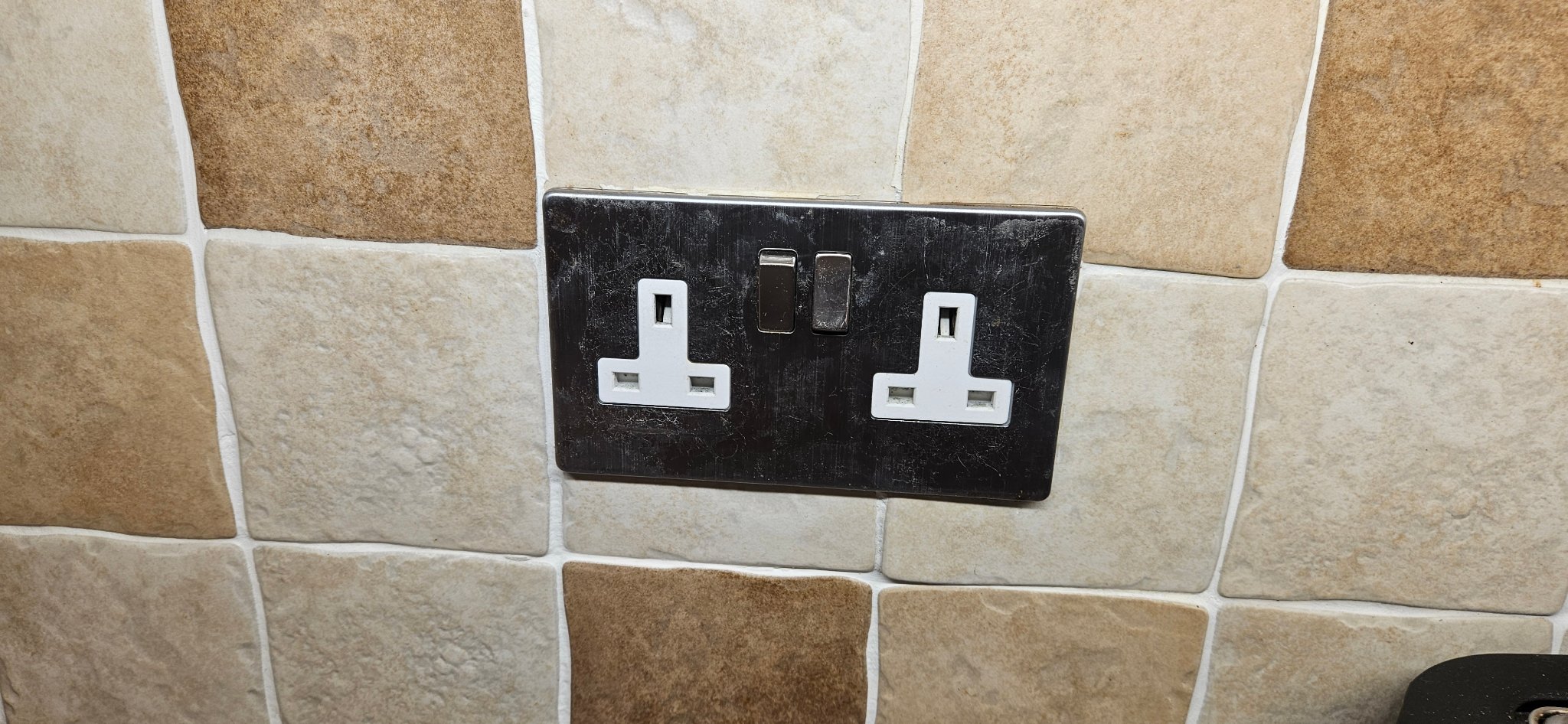

Hi all,
so one of my plug sockets has become faulty, the switch is stuck in the on position so i'm looking to replace the socket. the socket itself is white plastic but with a chrome screwless bezel over the front of it and i'll be looking to replace with something similar.

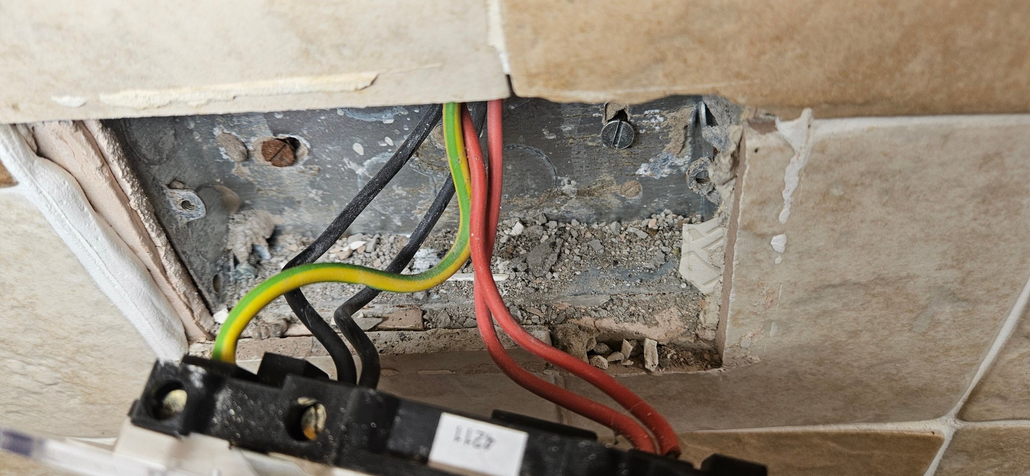

i've just switched everything off and just had a look behind the original socket before i buy a new one , and i've noticed that there is an earth cable, but there is no earth cable attached to the metal pattress box. should there be?
hopefully the attached pictures are clear enough, but basically when i replace the socket should i also be getting an extra length of earth wire from the earth point on the socket into the earthing point on the bottom left of the pattress box?

There should be . It's a lazy method that uses the screws to earth the backbox
Connecting the earth wires to the back box and relying on the screws to earth the socket is not allowed.
Connecting the earth wires to the socket and relying on the screws to earth the back box is allowed.
Connecting the earth wires to the socket and adding a wire to the back box earth terminal is belt-and-braces.

So in essence i can replace it with the wiring as is and that would be "ok" but best practice would be to just add an earth onto the back box.
Will just pick a bit of cable up in that case when i buy the new socket in that case.
It's a good idea but not actually a requirement.

I always fit a fly lead I use 1.5mm green and yellow single.

I always like to see the fly lead linking both too but as has been said - not essential
