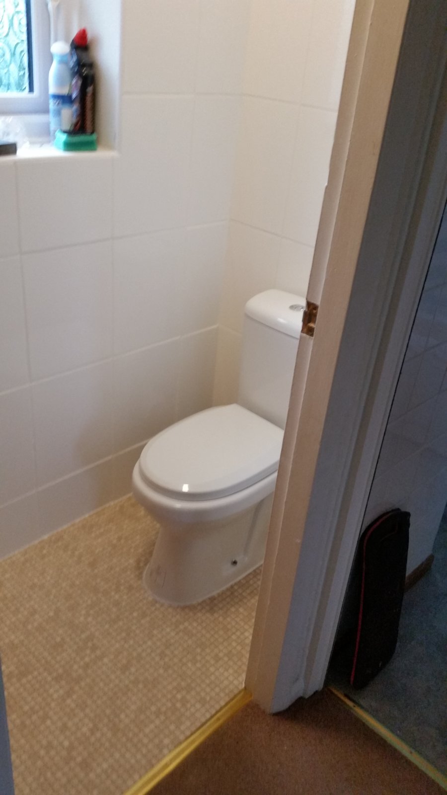

Poor quality plumbing tradesman on site - photos added -am I being too harsh?

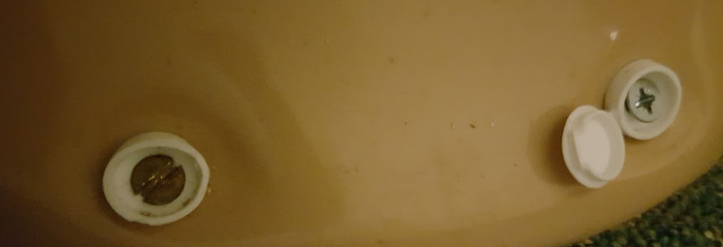

As said, I also found it amusing that he used plastic screw caps on the batten behind cistern - nice touch. An out-and-out cowboy would have just driven in a couple of pozis and left it at that.
Looks like his 'sentence' was capital punishment. Maybe on his next stretch, they'll teach him lower case.
Ah he even used 3 on the downstairs WC he took out to swap pan connector on lol
When you’ve got an orange toilet on carpet you can’t be fussy about the screws ;-)

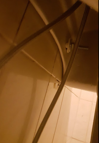

He didnt tighten the bolt properly.
I hope you dont leave it like that. Although the back 'wall' of the basin looks quite thin looking at the pic, so maybe the white washer insert couldnt go flush in. If that's the case the basin itself is bad quality.
All in all I'd give the guy 3 out of 10 (on account of there being no leaks and his soldering looks neat). I wouldnt pay him though and point him to this thread as the reason. You're going to have to spend more money getting it sorted.
I hope you dont leave it like that. Although the back 'wall' of the basin looks quite thin lookig at the pic, so maybe the white washer insert couldnt go flush in. If that's the case the basin itself is bad quality.
All in all I'd give the guy 3 out f 10 (on account of there being no leaks). I wouldnt pay him though and point him to this thread as the reason. You're going to have to spend more money getting it sorted.

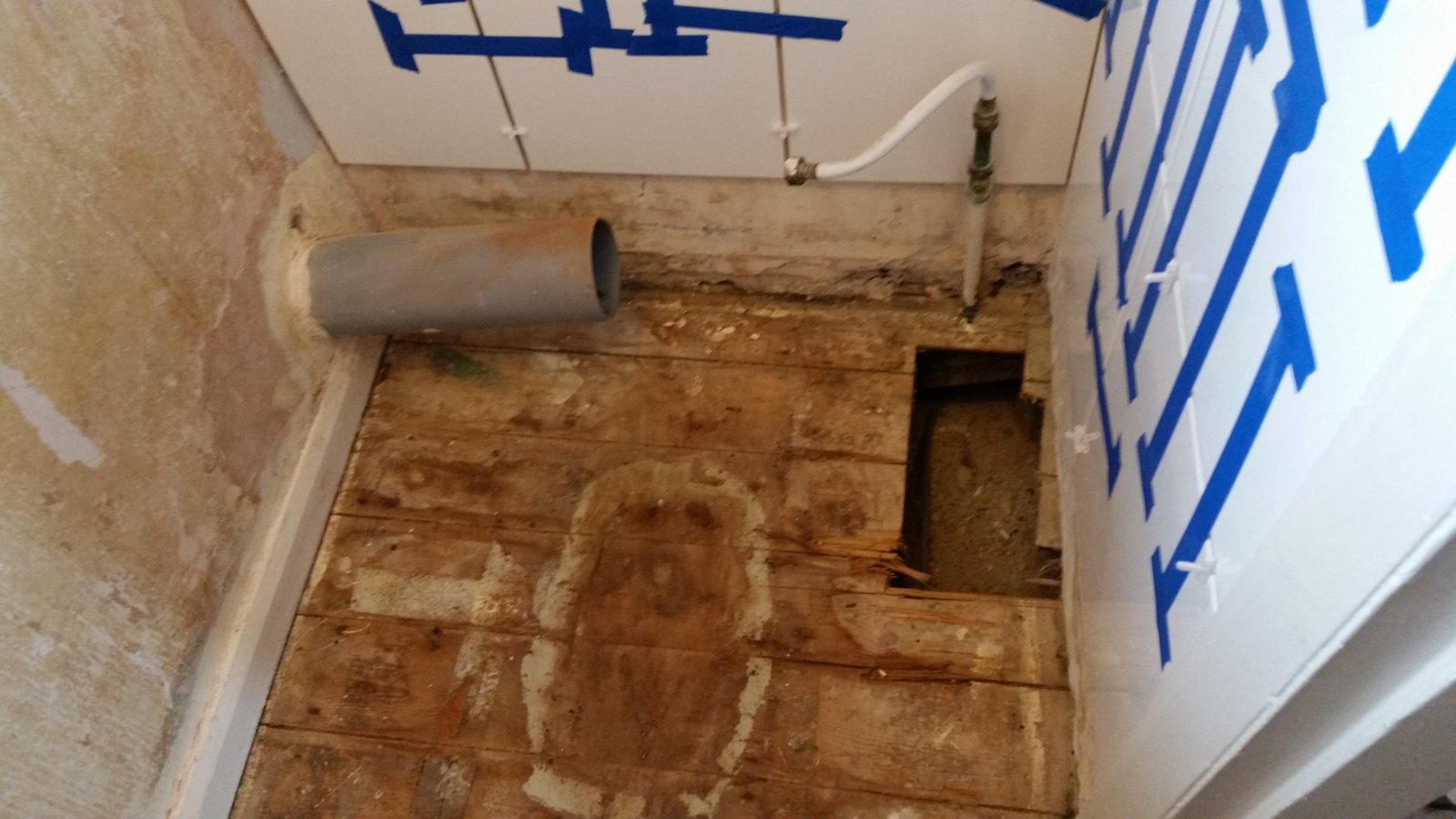

Its not aligned property - the fixing were supplied with basin and toilet - well sold to match £15 for fixings but bought them incase they were specific.
I had a bit of a 'mare fitting our toilet but got there in the end.
Go buy a flexible 90 toilet waste fitting from B&Q (so you can take it back for refund if not needed).
Good smear of silicone around the pan fitting before final fit as well.
As said already you may have to cut the soil pipe back slightly but it's only plastic and easy to do.

Thank you - If I were to do this and then cut the soil pipe back what connector should I use as diamater of soil pipe is narrower than the "socket" the pan connector fits into? Just on you tube looking - will I need to solvent weld it?
The flexi pipe just pushes into the soil pipe and seals itself buy multple rings (smear of silicone never goes amiss!).
You may not need to chop the pipe, mock it up first.
Use decent STAINLESS screws to bolt the toilet down as well if they are not already stainless.
This is what I had to deal with..
