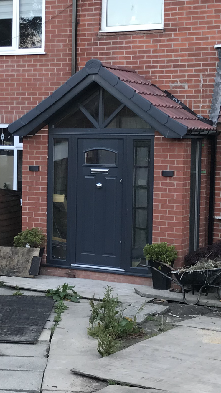

  10. Ian H
    Ian H
    Joined:
    14 Sep 2010
    Messages:
    6,446
    Thanks Received:
    739
    Location:
    Rochdale
    Country:
    Does it have side windows?
    I just DIY’d a similar one but got a guy to do the brickwork. I think it cost me about £3500, with the windows and door being £2200 of that. The triangle bit over the door was £500 :eek:
    If you were having someone do it I think Nosealls £6k is about right (y)

  11. 23vc
    23vc
    Joined:
    17 Apr 2015
    Messages:
    2,093
    Thanks Received:
    301
    Location:
    Warwickshire
    Country:
    Looks good Ian. I’d be putting off doing that step flashing too ;)

  12. Ian H
    Ian H
    Joined:
    14 Sep 2010
    Messages:
    6,446
    Thanks Received:
    739
    Location:
    Rochdale
    Country:
    I though one of the kids might end up a roofer so they can do it.
    In about 10years (y)

  13. noseall
    noseall
    Joined:
    2 Feb 2006
    Messages:
    38,828
    Thanks Received:
    2,477
    Location:
    Staffordshire
    Country:
    I think that old soldier header course will trip him up.:cautious:
  14. 23vc
    23vc
    Joined:
    17 Apr 2015
    Messages:
    2,093
    Thanks Received:
    301
    Location:
    Warwickshire
    Country:
    Yep, spotted that. He’s got the right idea making the kids do it.
