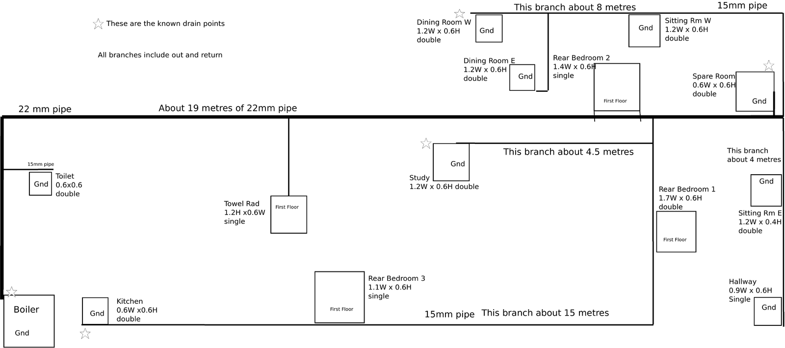

Yes, it looks a mess, but because of where the access to pipes and where the rads suit each room it is actually sort of sensible, as well as being extended at various points. The drawing also concentrates on the connections between the radiators to help me balance it later.
Updated the diagram to better show the as fitted looping.

because of the layout it is hard to see if one of the multiple legs are blocked?

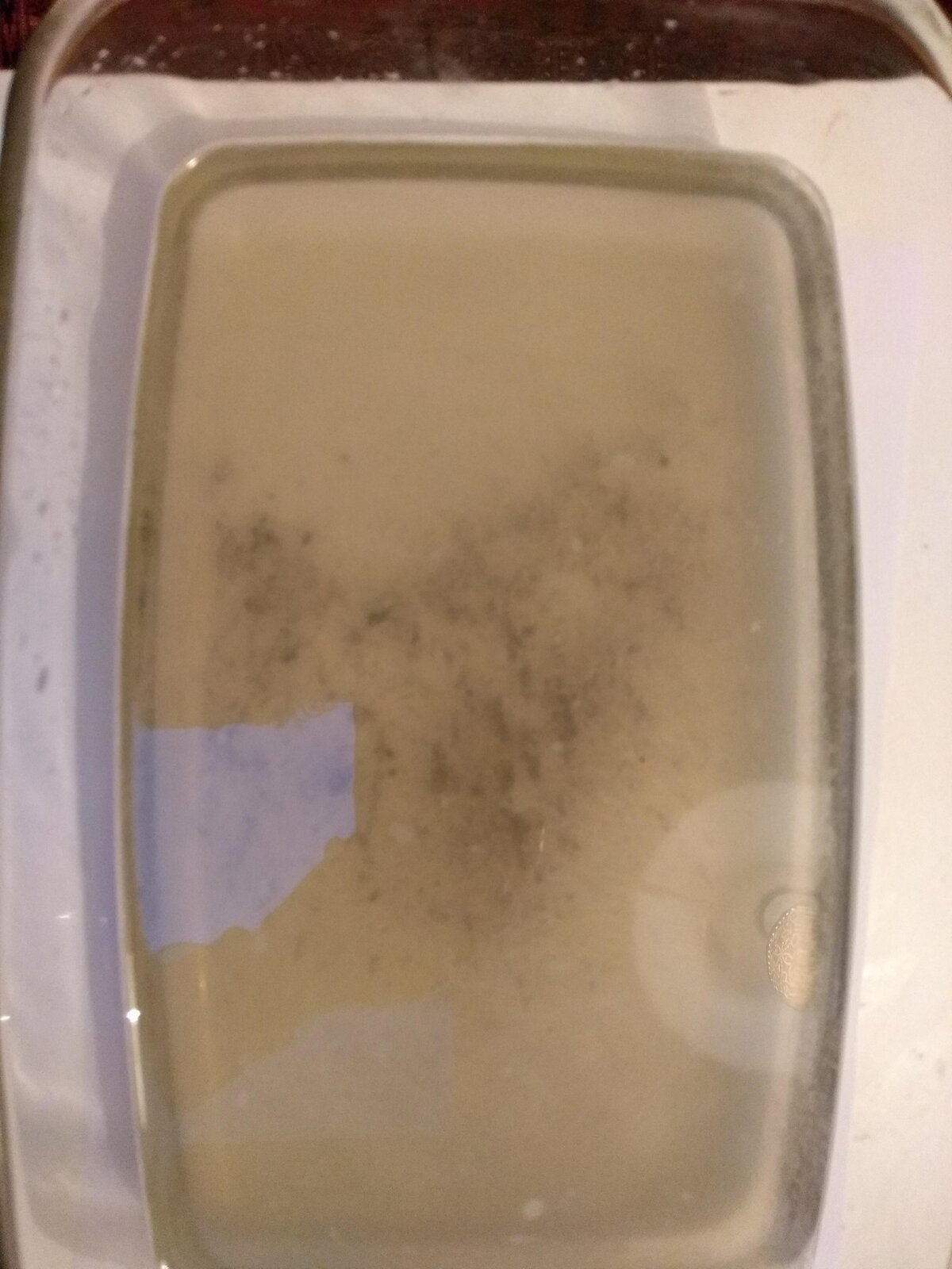

That is about 3 cm of water from the system, it has had 1/2 bottle of MC5 added three days ago. Is that level of sludge acceptable?Some of those flakes are about 4 mm long

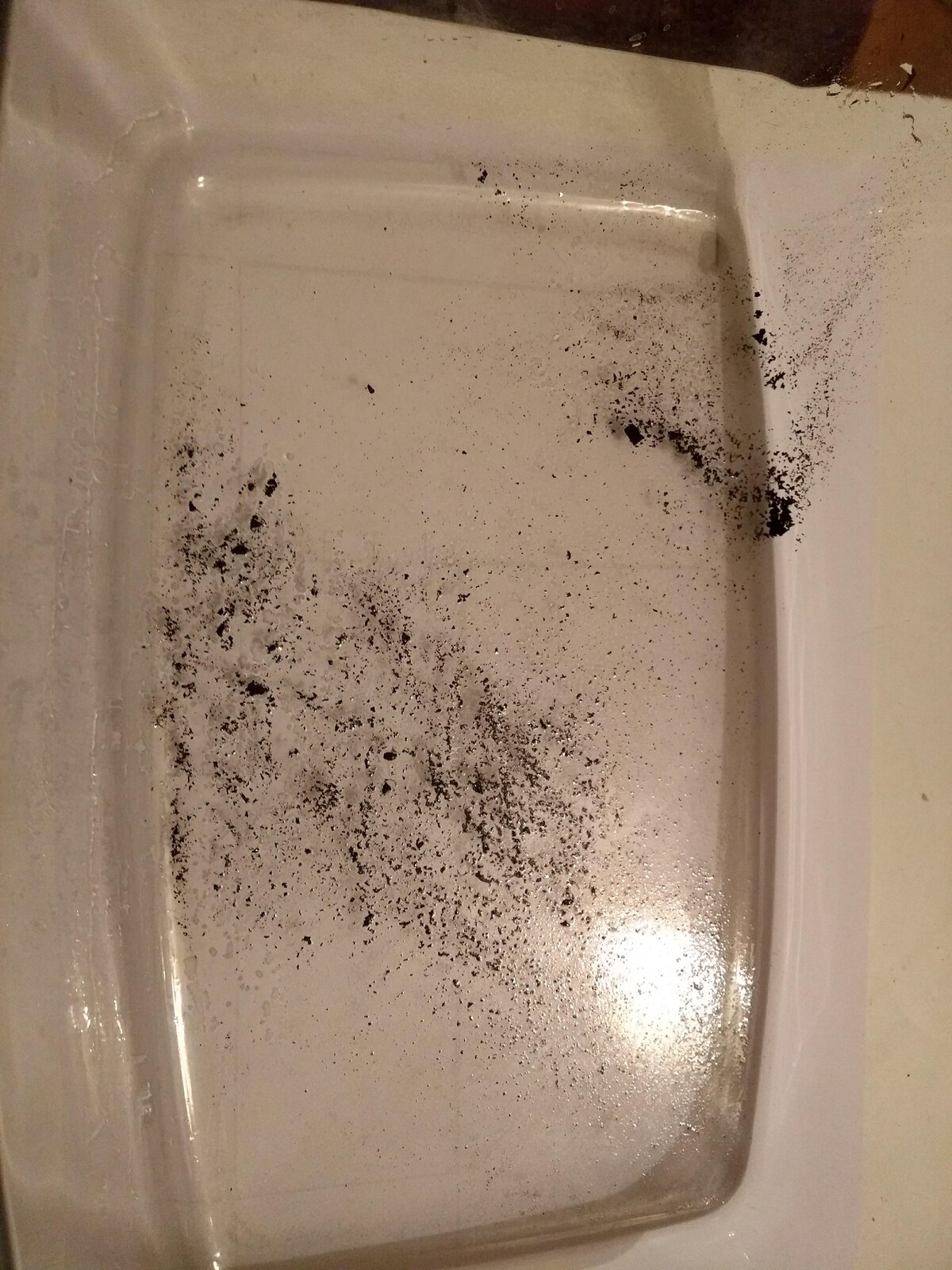

I am letting it settle and will pour off the liquid later so that I might be able to get an in focus picture of what has come out.

That is from about 2 litres of fluid, biggest flake, near the top of the image is ~4mm long
Is this normal?
