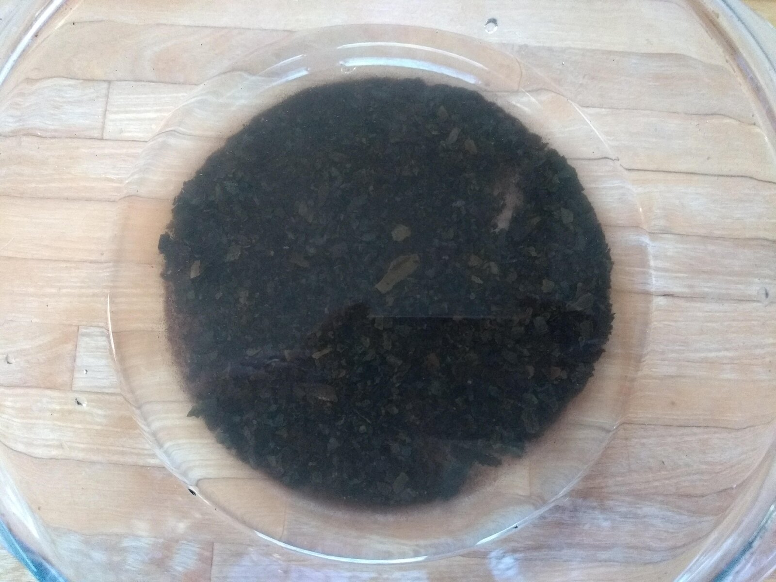

Well he came again, and despite my request to focus on the problem bit he did all the rads again, we noted how poorly it flowed out the external drain that has been there for 25 years +. He insisted it was clear despite the low flow rate when there was 2.5 bar at the boiler. After he went I used some 18gauge single strand enamelled copper wire I had, there was resistance from 30 cm in and some crud coming out, then at about 1.8 metres in it suddenly broke free and I had a full and free tube of water coming out the drain. The reason the fluid coming out was clear was because of the magnetite filter bed it travelled through.
There is a single radiator that still does not heat up when all the others are closed, that is the one adjacent to the drain. the pipes are under the floor here and plastic on this bit of the property.
Is there a way to get sufficient acid into this section by itself?
That came from about 1metre of 15mm pipe! Oh, and as it cleared most got swept above the bowl as so was not captured.
