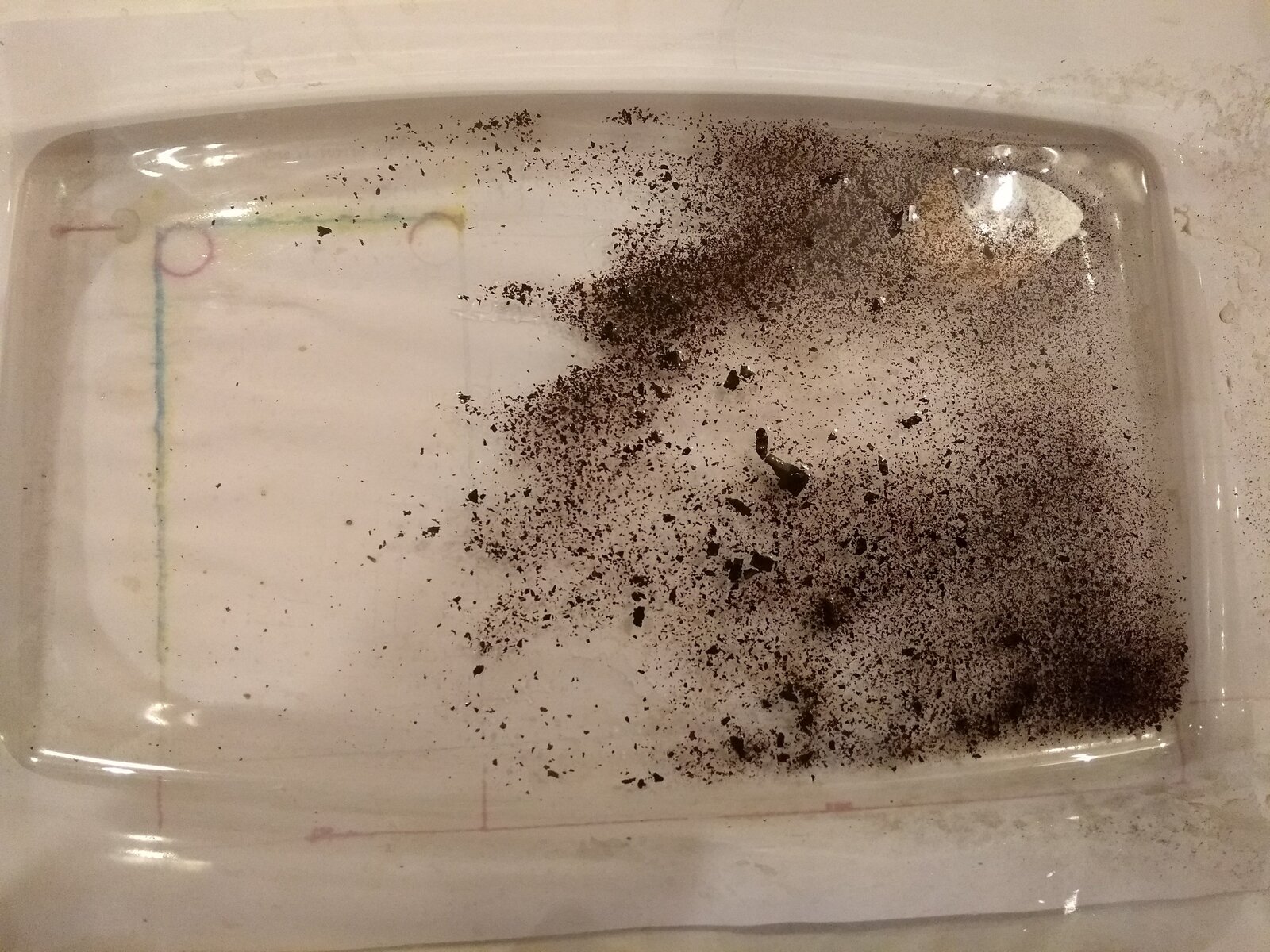

I am letting it settle and will pour off the liquid later so that I might be able to get an in focus picture of what has come out.
I guess I will start by stating my concerns at the amount of stuff still showing after his visit.
It is possible he did things in the wrong order to suit the crazy golf routing in the house and that may have let silt settle out somewhere unexpected?View attachment 321741
That is from about 2 litres of fluid, biggest flake, near the top of the image is ~4mm long
Personally I would expect a powerflush to get rid of all chips - how long did it take?

It is now sort of had one bleed down, lots of silt in the container, I used a large casserole dish below drain at lowest point, gently dribbling around the edge means I have caught all the heavy silt now, pic tomorrow. It kettled just now, it is at about 2.3 bar, so boiling point at ~130C, and the temp reported on the front was about 62 (demand is 51) and the temp briefly bounced up to 81C! eek. Definitely not running well, the silt and crud may have baked hard in the narrow slots of the HEX??.
I'm afraid to say that it looks like the job wasn't done properly if the pic in post #8 (#12) is anything to go by. Even after numerous attempts and to leave the system the way it is is just plain unprofessional.
A cleaner should have been introduced into the system a good few days before the system was even drained and allowed to run under normal conditions to do it's job, using an aggressive cleaner is all fair and well if a system is seriously sludged up to at least get things moving but I find it never does as good an all round clean and as suggested a strong cleaner needs tested for and neutralised afterwards.
A proper powerflush, especially on that size of system should take at least a day if not more and each radiator should be agitated to loosen stubborn debris. If the system is bad (black) and a lot of debris is being found then each rad should be powerflushed separately, especially on such an elongated system like that

some of the particles are almost a cm long, they are going to struggle to climb 2.5 metres of 22mm pipe!
The bowl is about 33x20 cm for scale, and the flow was very slow at the end, but still could not open ground floor bleeds without spilling water. I think I also saw a bit of the brass disc that should have held the diverter rubber in place!
